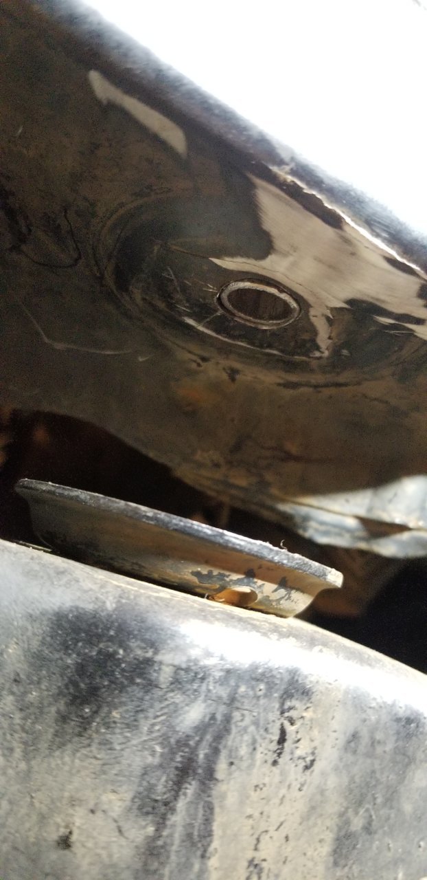

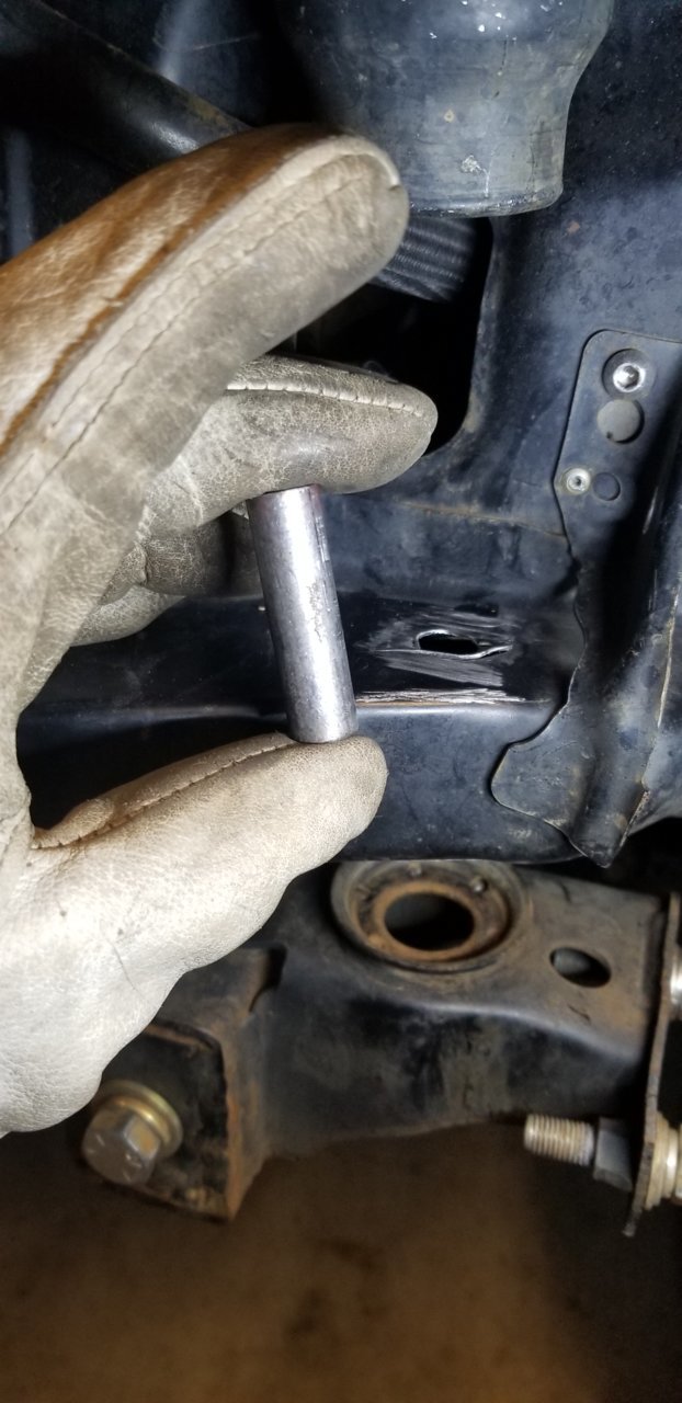

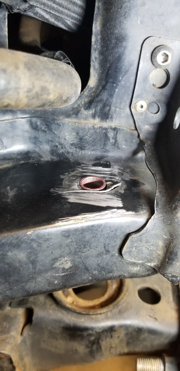

    I enlarged the hole a bit to fit some 1/2" tubing that I cut to length. Welded the top and bottom and the surrounding cracks the best I could.
    Then ground it down, painted it and bolted it back together.
    Much more solid now and it doesn't visibly flex like it did before

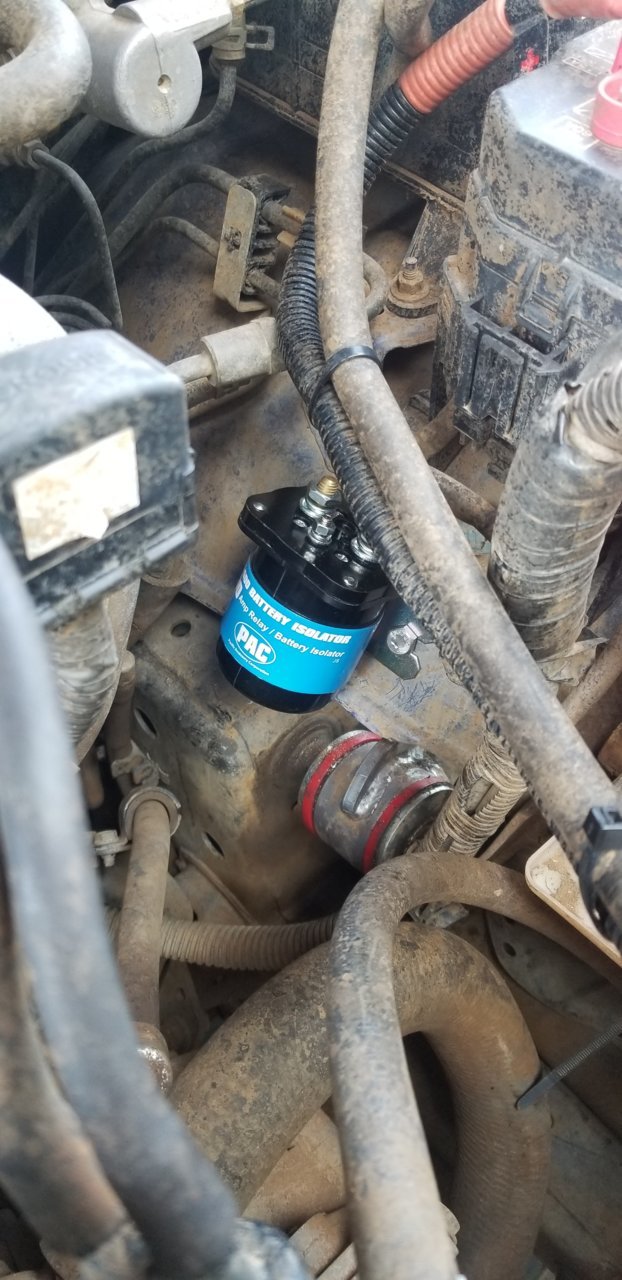

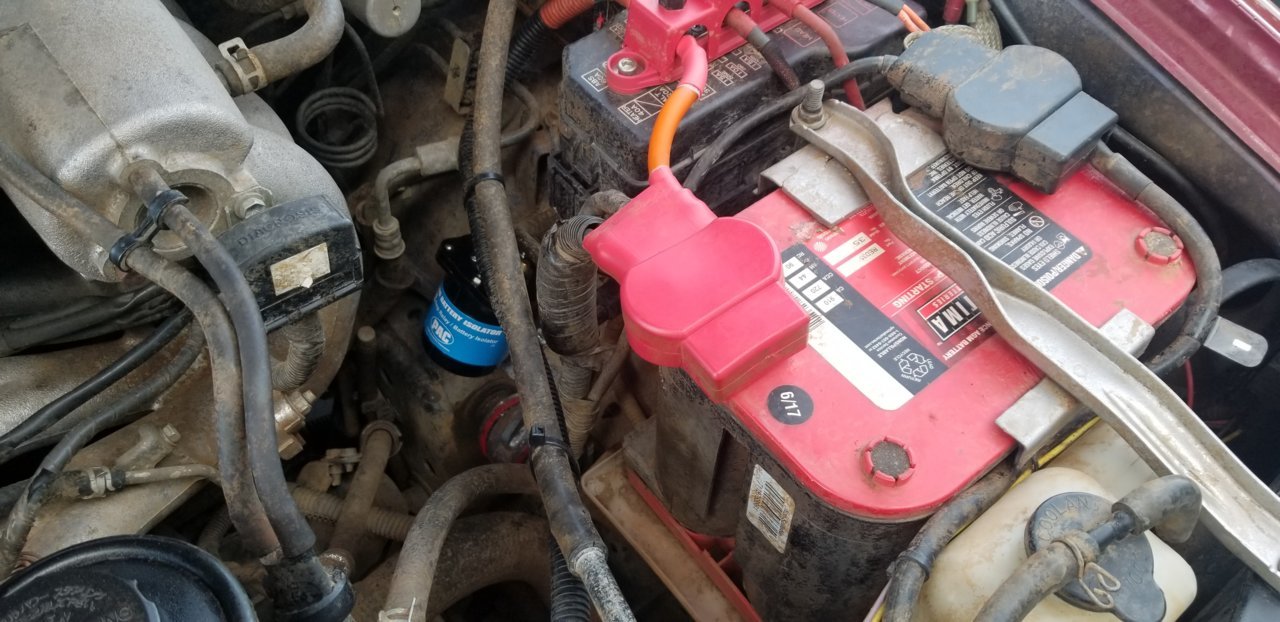

    Also mounted my winch battery isolator.
    I ordered some Contura switches to match the ARB ones in my switch plate to power the winch and another to connect to my ditch lights.

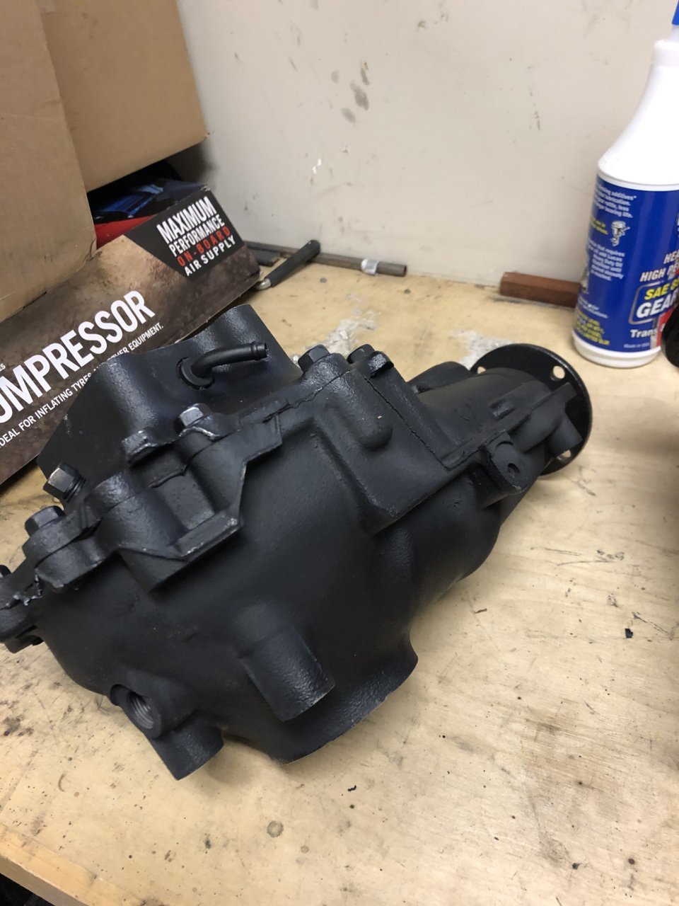

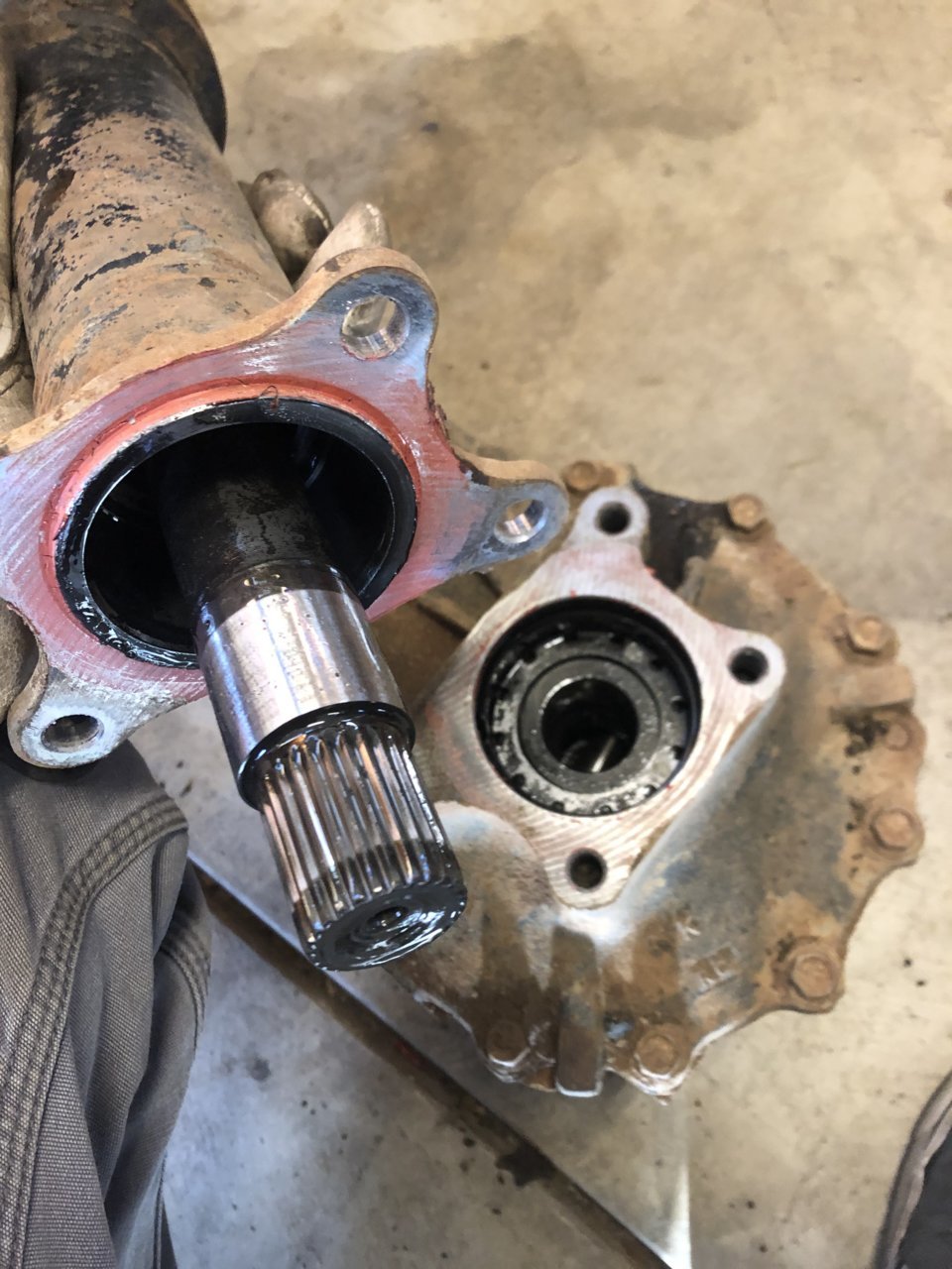

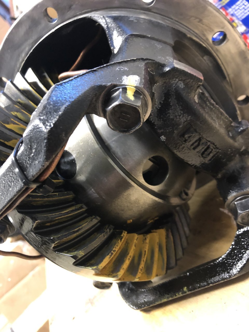

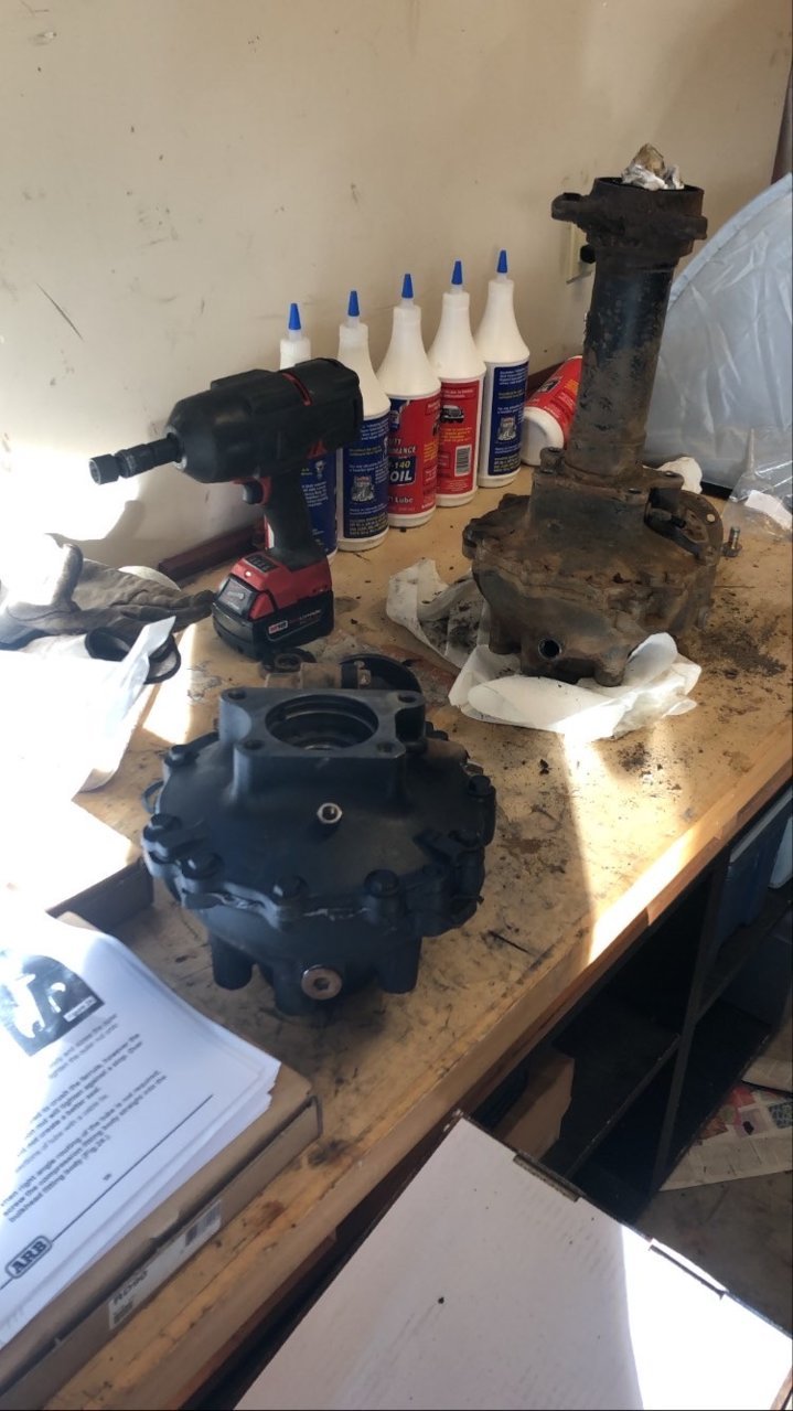

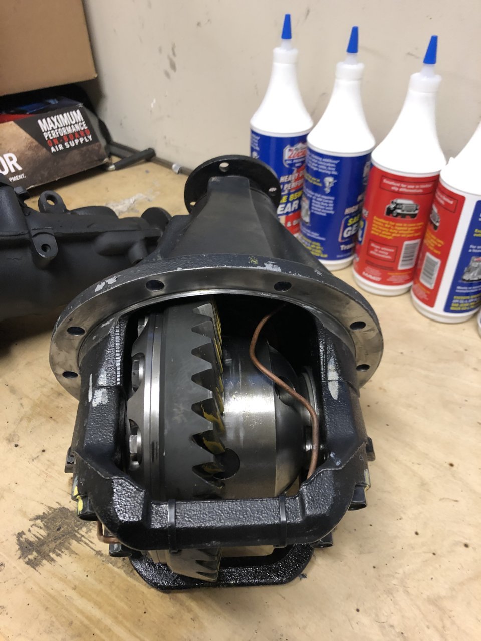

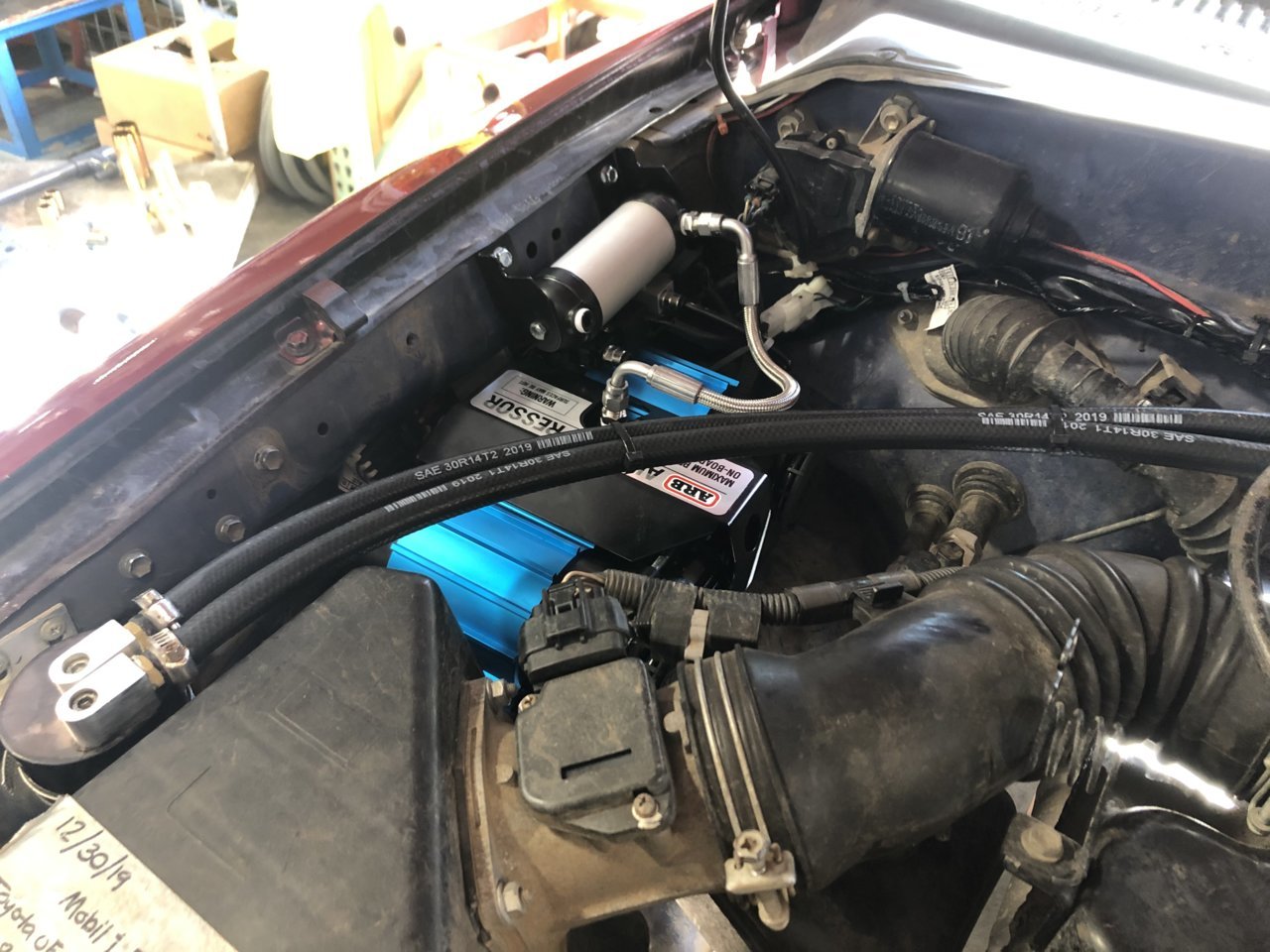

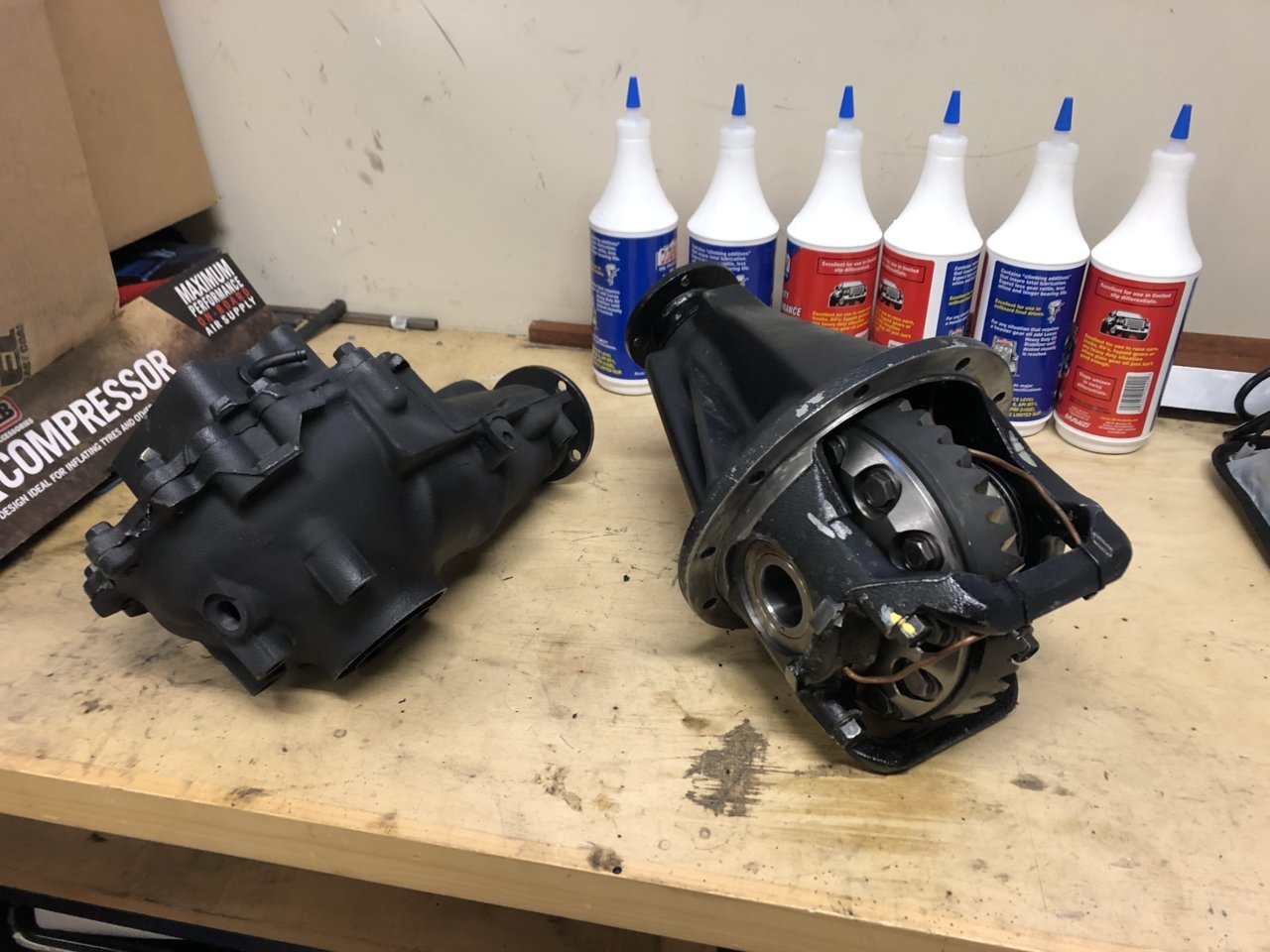

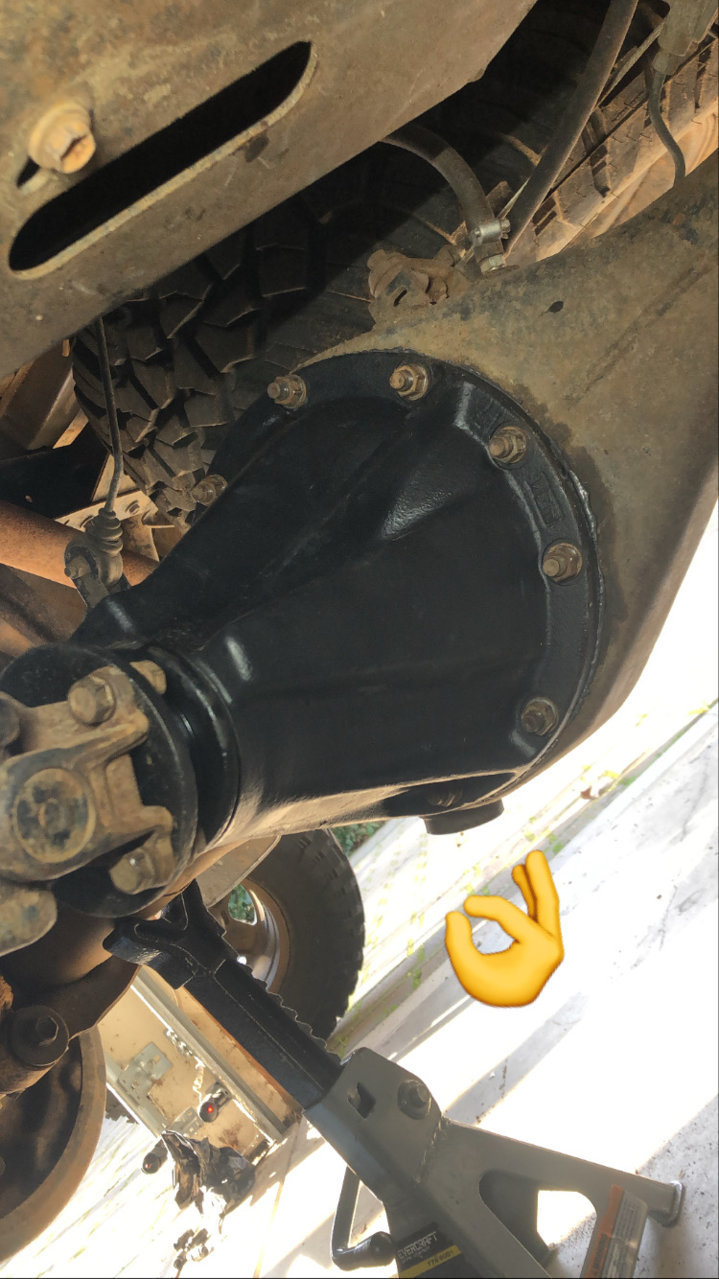

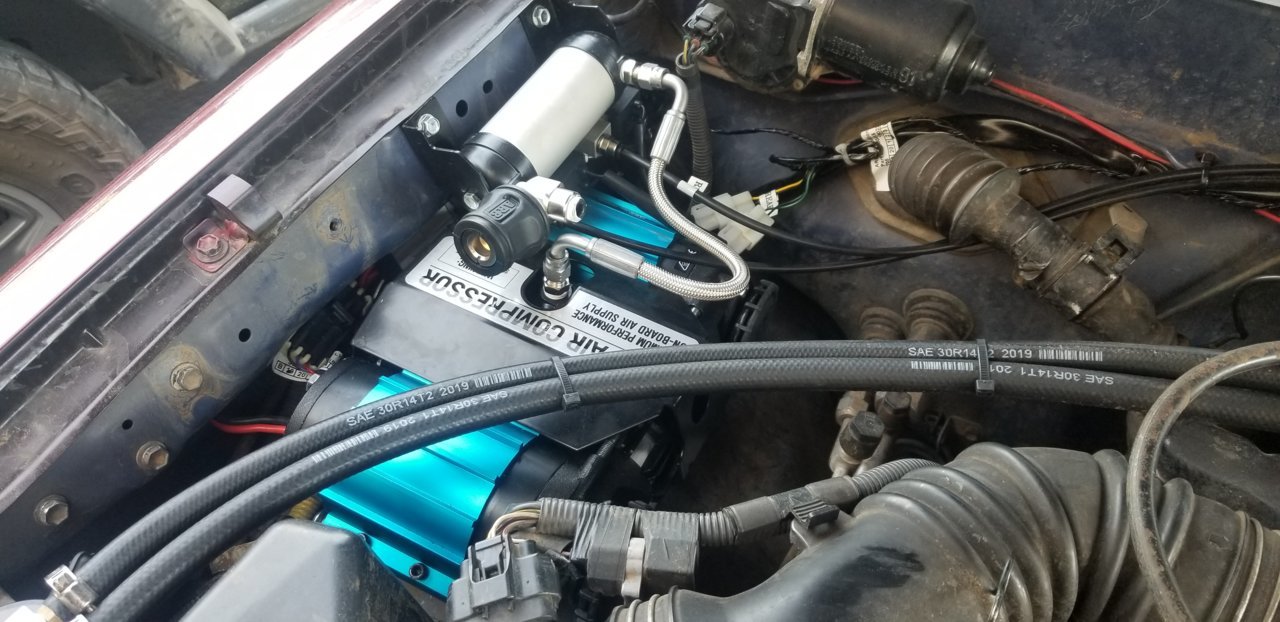

    Got my new assembled thirds from ECGS installed yesterday. 4.88's with ARB's front and rear.
    Also got the compressor and switches mounted and wires this last week.
    Only thing i'm missing is a ferrule for the front locker air fitting at the bulkhead fitting that wasn't in the package.
    But the rear is plumbed and everything is working as it should. Loving the new lower gearing!
    Can't wait to put them to use on the trails once i'm done with the break in process for the next 500 miles.
    Here are some pics from the process.
    Old open diff

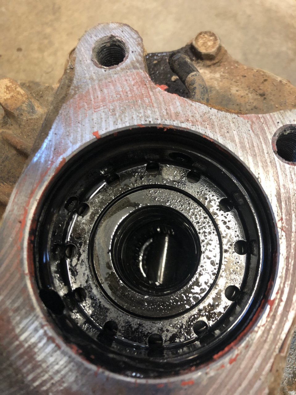

    Found out that there's no stub shaft in the manual front diff assembly. Just the intermediate shaft. Interesting...

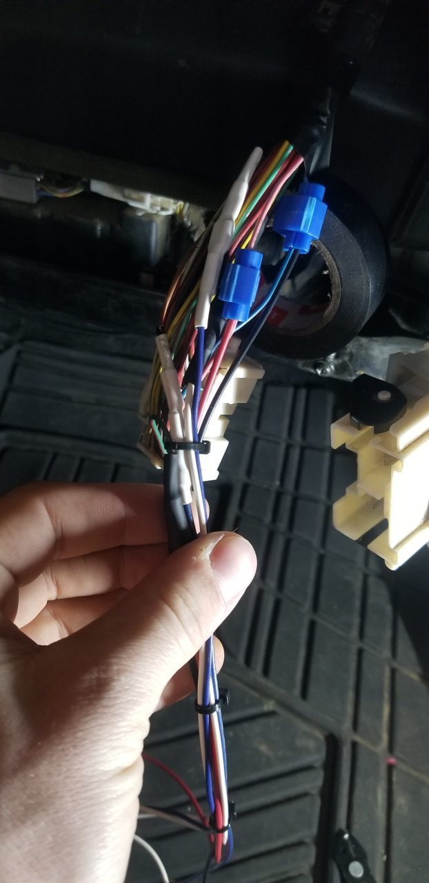

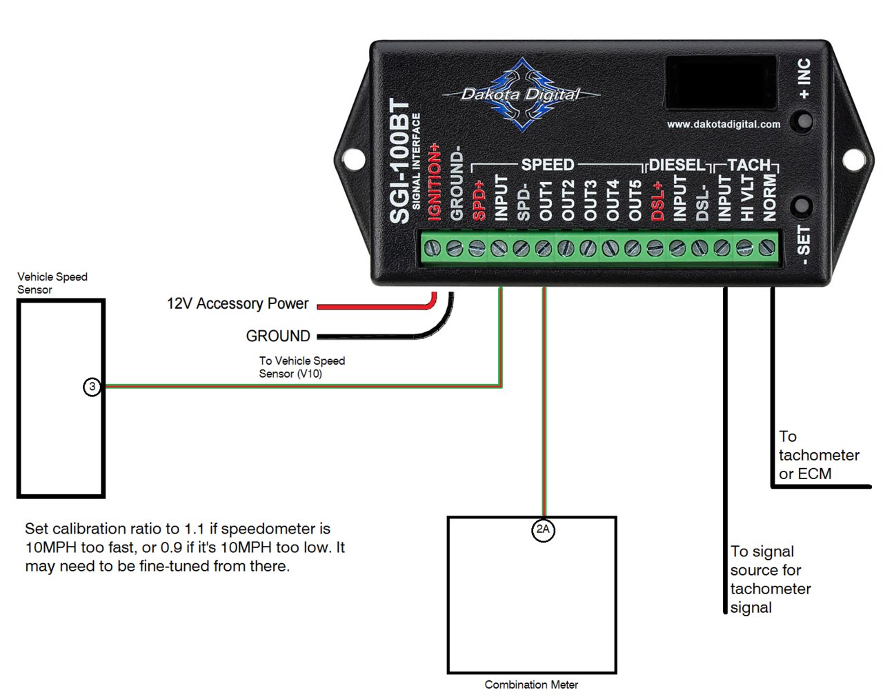

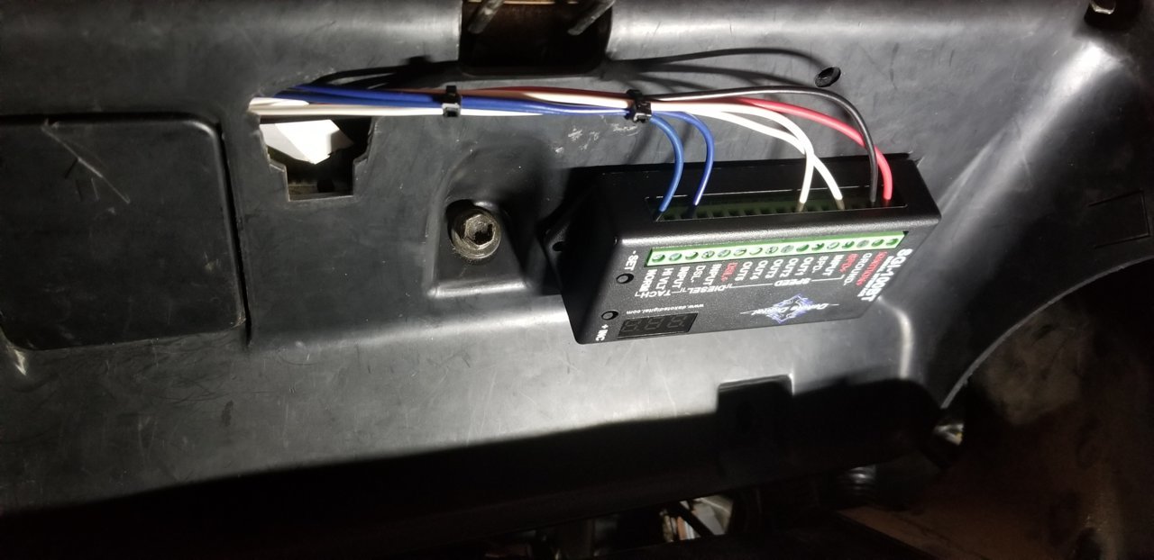

    Found out that Dakota Digital recently came out with a new module that does both speedo correction and tachometer correction in one. You can also control it via bluetooth too which makes adjusting it while driving way easier and safer.
    Ordered one up and got it installed and spliced into the TK2 connector behind the glovebox.
    The Dakota Digital customer service is top notch! They even drew me up a wiring diagram with the correct wire colors and everything after talking about the application and other details.
    Although the speedo out signal should really be wired into OUT2 instead in order for it to work.
    I used @boostedka old build thread on his supercharged single cab as a guide for the wiring for the speedo. It's the same wiring on this SGI-100BT as it is on the older SGI-5E. The tach was easy with just the one black wire in the same TK2 connector.
    The setup in the app took about a minute to get going and get everything corrected.
    I used spade connectors so that I can connect up the sensor wires back to each other if I need to for whatever reason.
    The wiring before wrapping it all up:
    Installed in the glove box with velcro for easy access. Still need to add a zip tie anchor to hold the wiring out of the way.
    Needless to say, I'm pumped to have a proper reading Tach and accurate speedo.

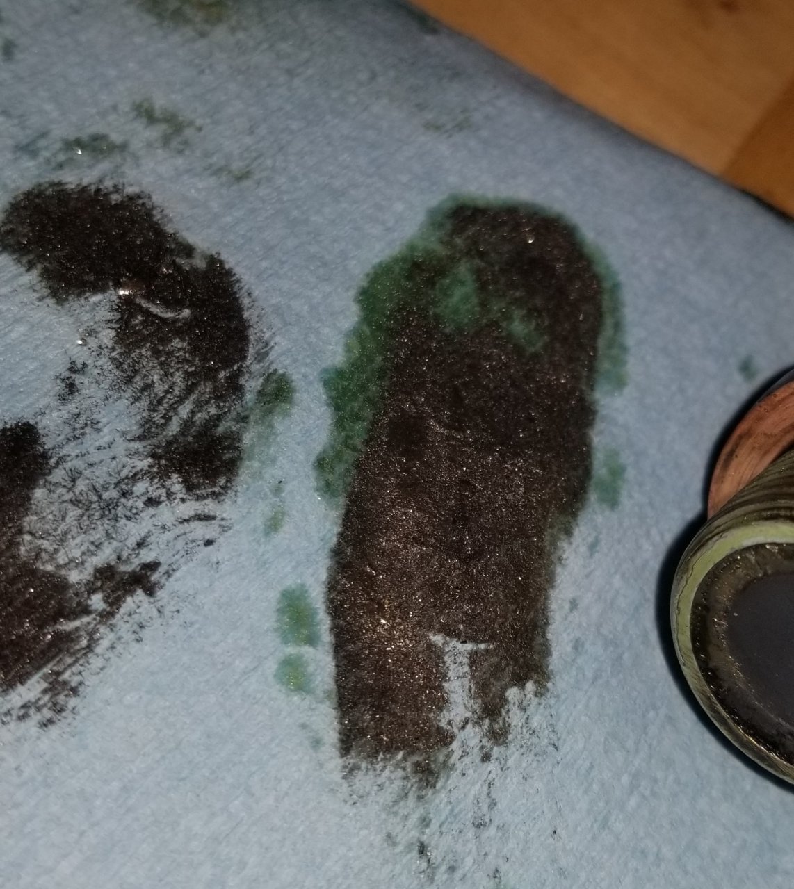

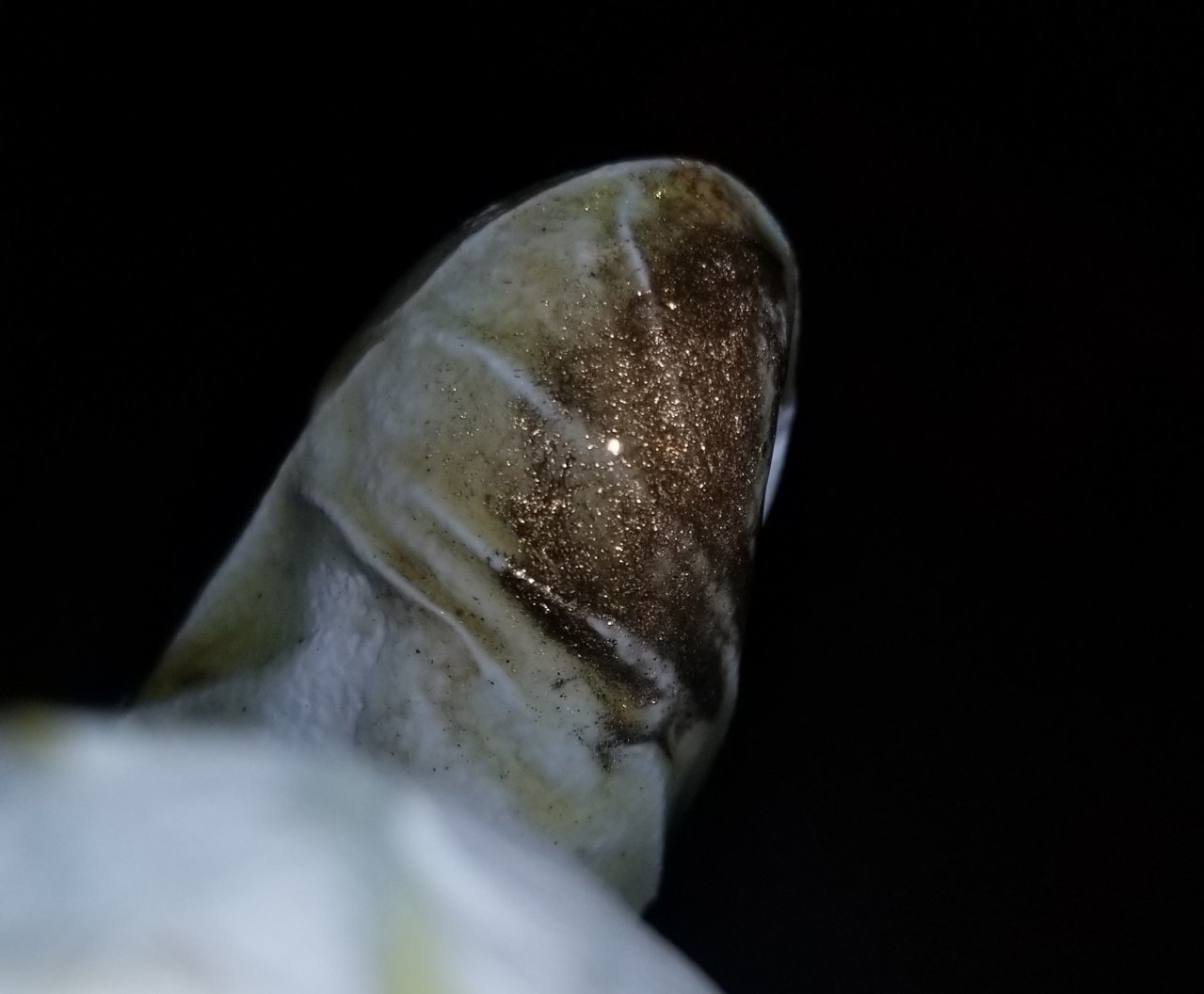

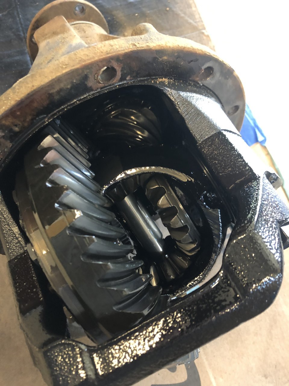

    Changed the gear oil last night after the 500 mile break in.
    Everything looked normal and no excess metal.

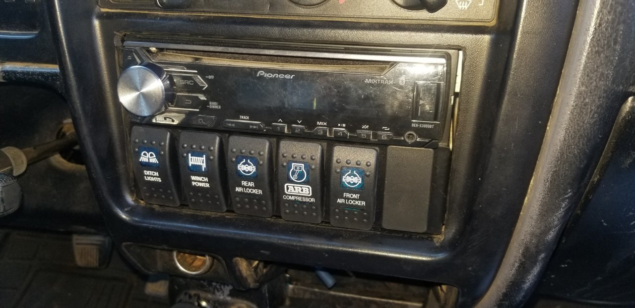

    Also recently got an ARB air up kit and installed some warranty replacement parts from ARB that were leaking & missing on the front locker solenoid & bulkhead fitting.
    Pic of the switches installed
    Dalandser and CoWj like this.
  12. Feb 27, 2020 at 11:09 AM
    #152
    CoWj
    CoWj Lost and Found at the same time.
    Feb 8, 2019
    #282309
    850
    Wyatt
    Northern CO
    Burt: 1998 2.7 Regular 5 speed 4x4
    Bilstein 5100, ARB Bumper, Warn VR EVO 8, 34x10.50 Toyo 4.88s ARB Locker
    Looks Good! Looks like a normal amount of metal but it may be worth changing it in 5k miles just to make sure its full clean. But it all look awesome!
