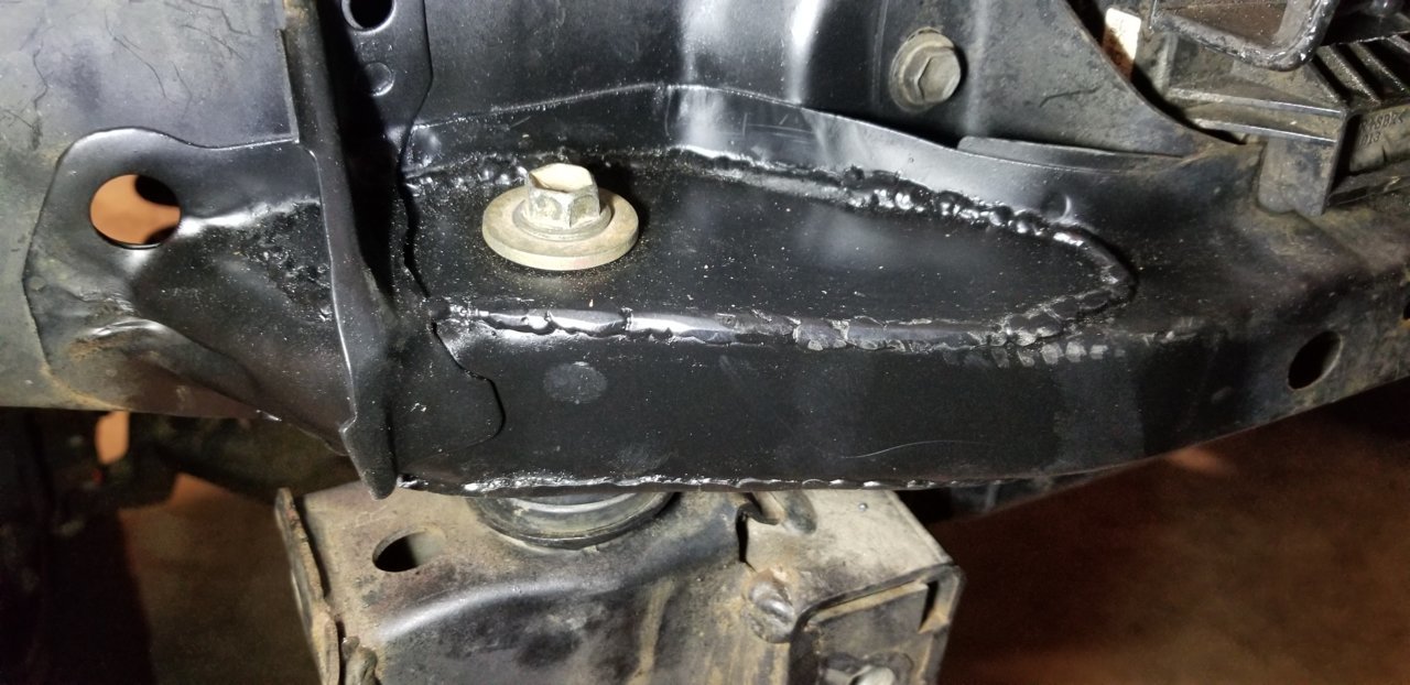

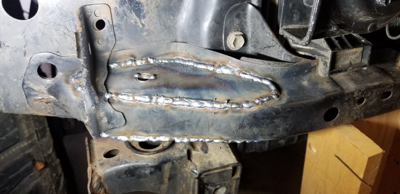

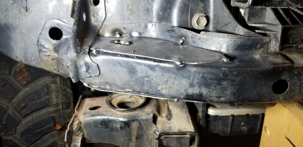

    Been busy on the truck with the whole shelter-in-place going on right now.
    Plated the lower core support body mount area since the other side was starting to collapse, and the side I tried to fix before broke again. I really hope this holds because if it doesn't, i'll either have to make my own core support from scratch or get real creative with that lower section and modify it to be stronger.

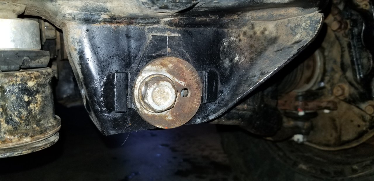

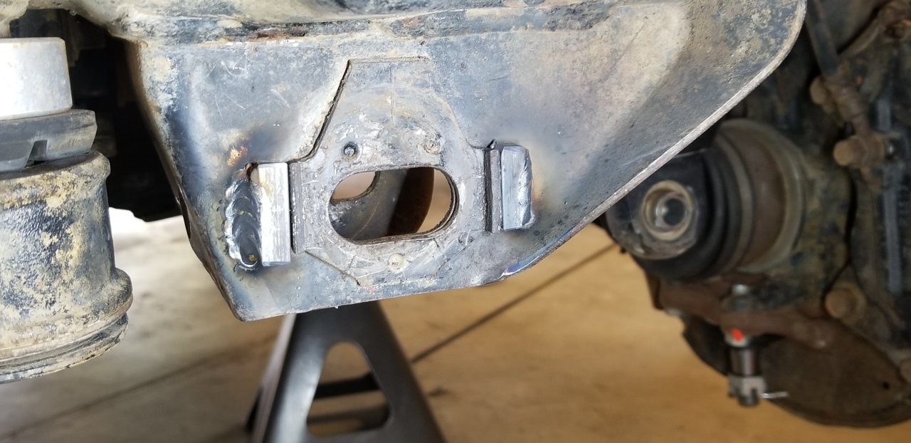

    Also pulled both LCA's and re-greased my whiteline bushings sine the passenger side was starting to squeak pretty loudly.
    While I was down there, I welded some 1/4"? bar stock on either side of the cam tabs to reinforce them and prevent them from folding over.

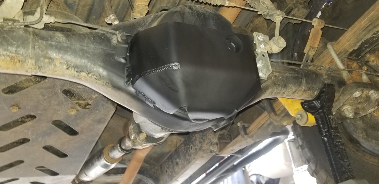

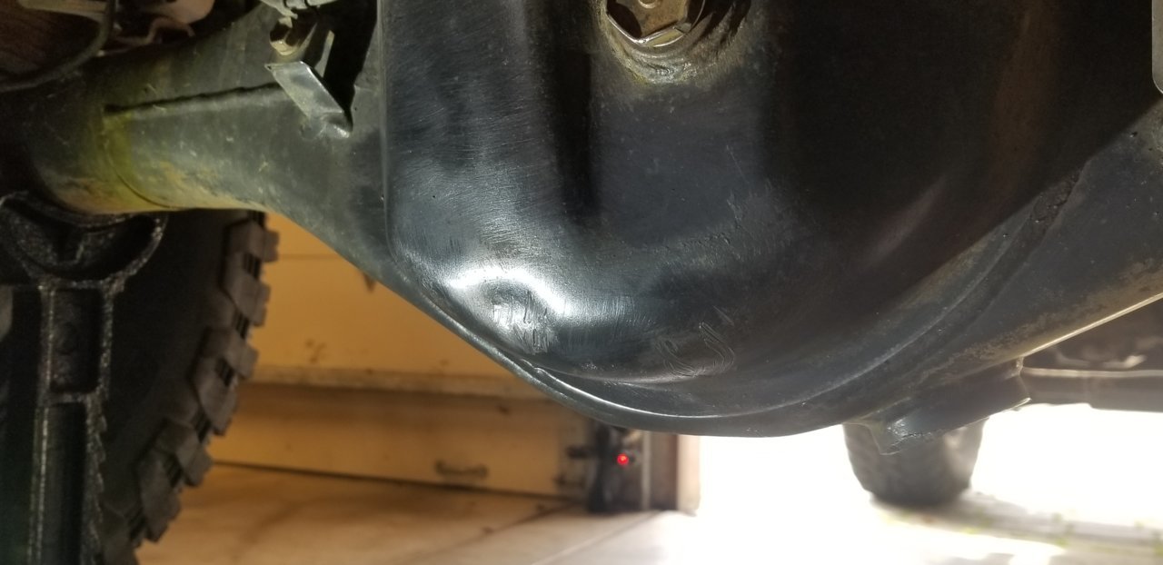

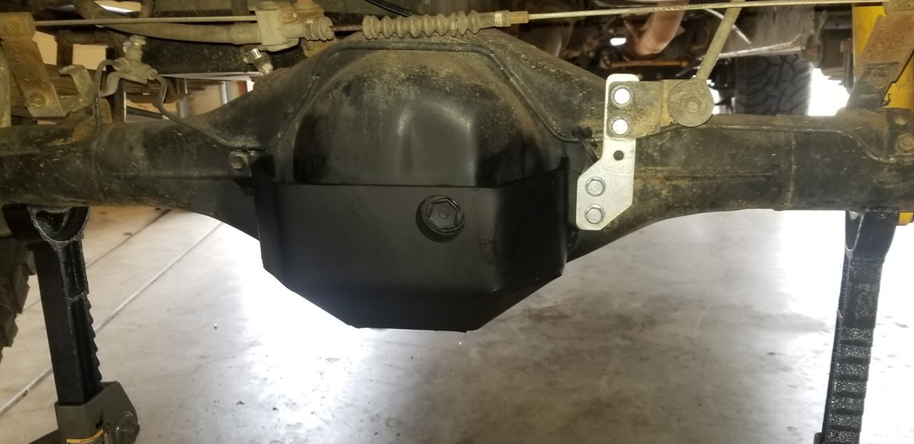

    Also discovered that I had a close call on my rear diff when I was at Prairie city a bit ago.
    So that led to be adding some 1/4" thick beef, courtesy of trail gear, to the rear diff cover to prevent help me from potentially royally fucking things up

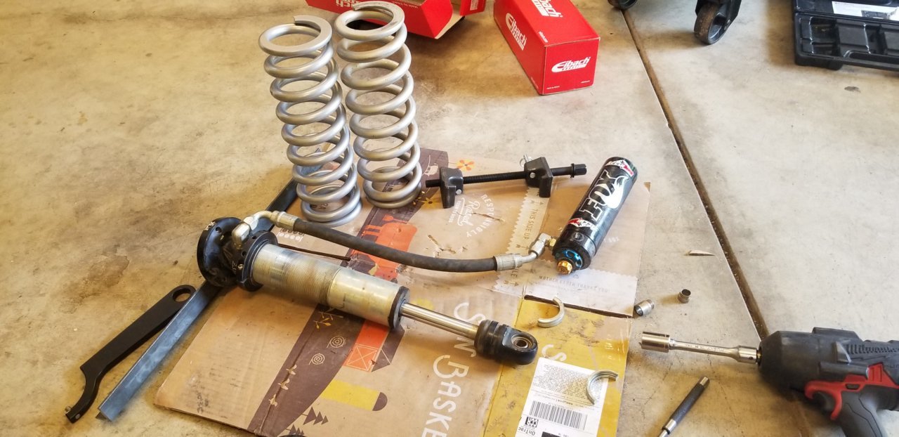

    Swapped my OEM 600lb springs to 650lb ones.
    Not the easiest thing to do and was a pita to take the CO's on and off over and over again until I got the ride height I wanted.
    and putting a big ass piece of square 2x1 tubing over the preload tool really helped crank it down to where the preload needed to be.
    Once I did it for one side I only have to do it once for the other though fortunately.
    Not a crazy difference, but I really notice it on the turns where there's not as much body roll.
    I'll be curious to feel the difference offroad

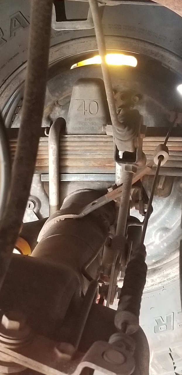

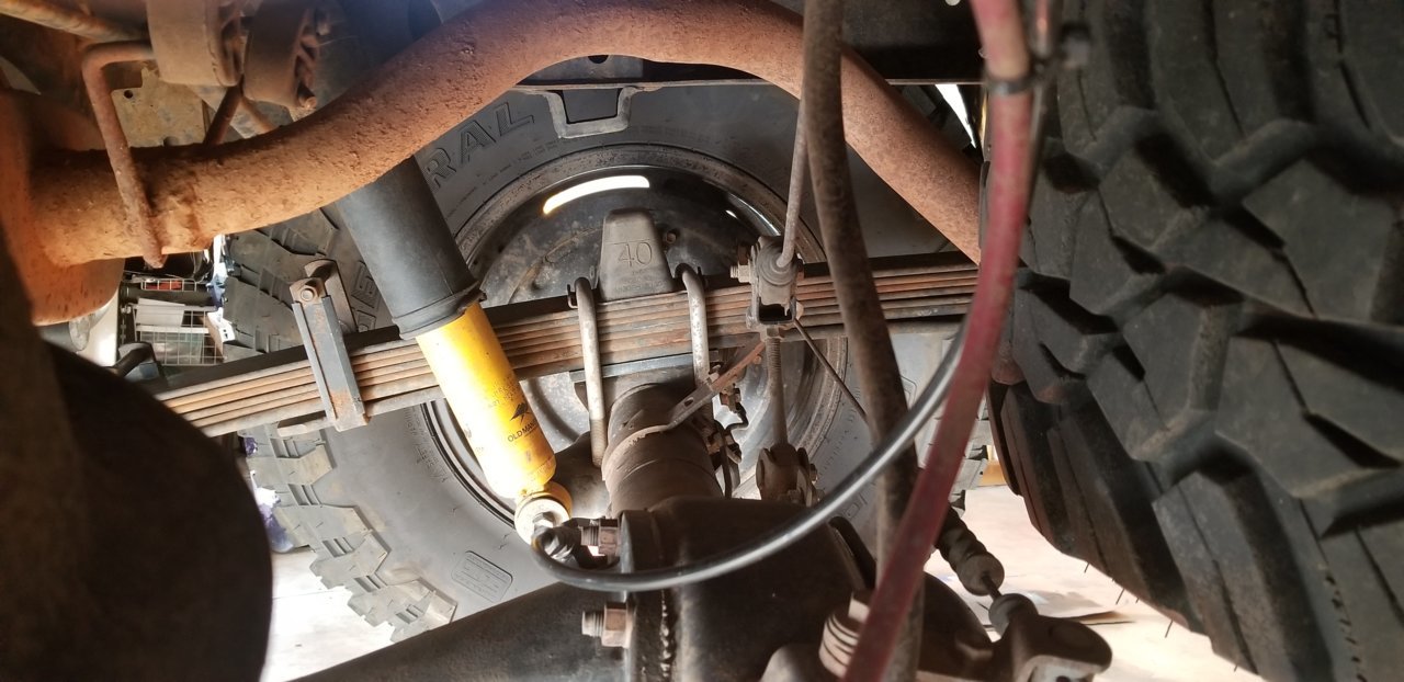

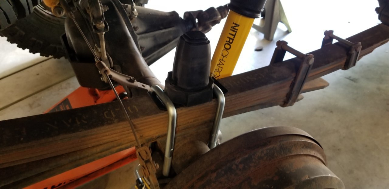

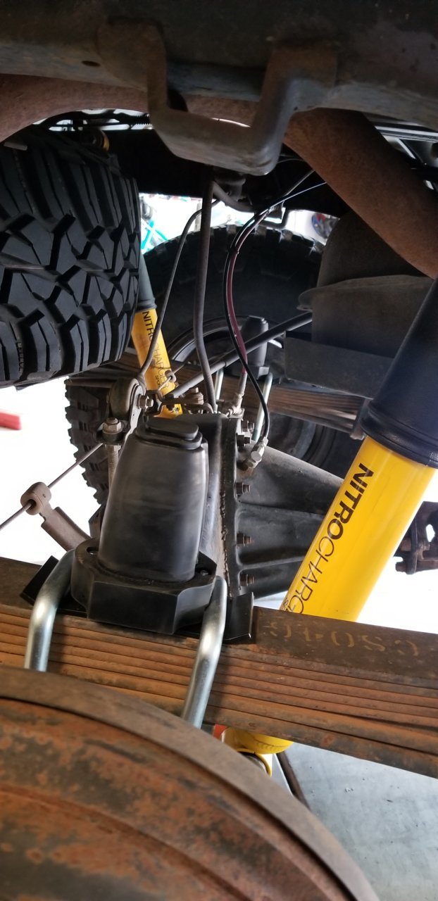

    Installed some 4.25" rear durobump bumpstops recently. Super good quality product. Replaced the U-bolts while I was at it just for good measure.
    Had to modify the mounting plate and the bottom of the bumpstops in order to get them to work with my axle relocation plates. The rubber used in them is an interesting blend. Not like the typical super hard bumpstop material.
    That also involved shortening the leaf spring centering pin. Hopefully it's not too short for when I put an AAL in the pack.
