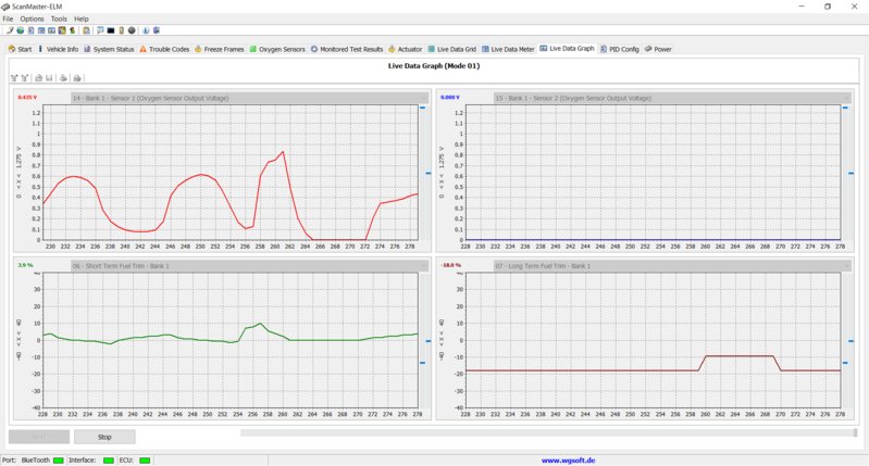

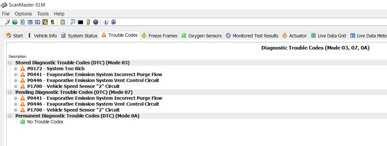

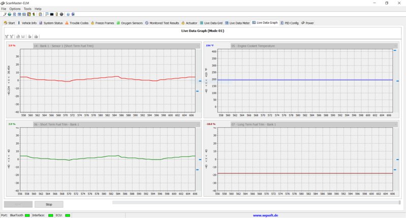

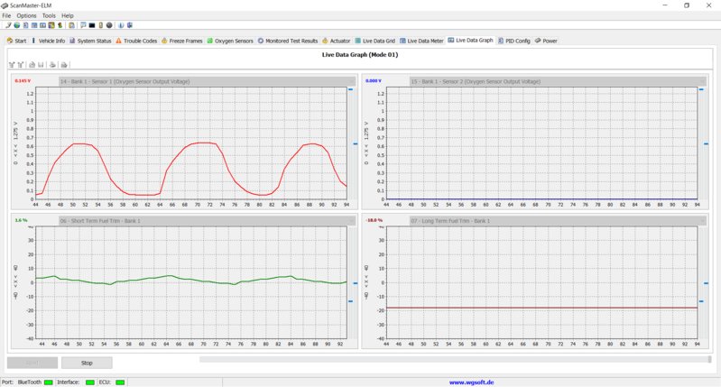

    Fuel Pressure Test results
    • Fuel pressure test fitting installed :thumbsup:
    • Fuel pressure:
      • Key on-Engine off: 45psi
      • Running: 45psi
      • Key off: 42psi holding steady
    *screenshots will likely suck once they are shrunk down... Zip included

    @Blkvoodoo aNY recommendations of where to go next?
  7. May 15, 2017 at 7:20 AM
    #27
    Blkvoodoo
    Blkvoodoo a Hooka smoking caterpillar has given me the call
    Jul 23, 2015
    #160098
    4,187
    Kevin
    Near Clayton NC
    08 PreRunner SR5 DCSB
    Exploratory surgery
    Rich code might be an injector but that there are also multiple evap codes...
    (some of) These trucks are sensitive to over filling when fueling up, trying to squeeze that last part of a buck into tank. Causes evap system to be contaminated with raw fuel. This would lead to a Rich condition also saturates the carbon canister ( black box up next to master cyl) with raw gas.
    This would/could cause a hard start as it's "flooded" now.
    There may be an evap system issue on the fuel tank top allowing raw fuel in.
    Doing precautionary compression test and cooling system pressure test isn't a bad idea either. At least you'll have an idea where you're at in that regard. Pull the plugs see if the correct ones are in place (it does make a difference)

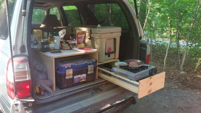

    So the drawer system is working out awesomely. A few tweaks and I think it will be ready for permanent mounts.20170518_182758.jpg

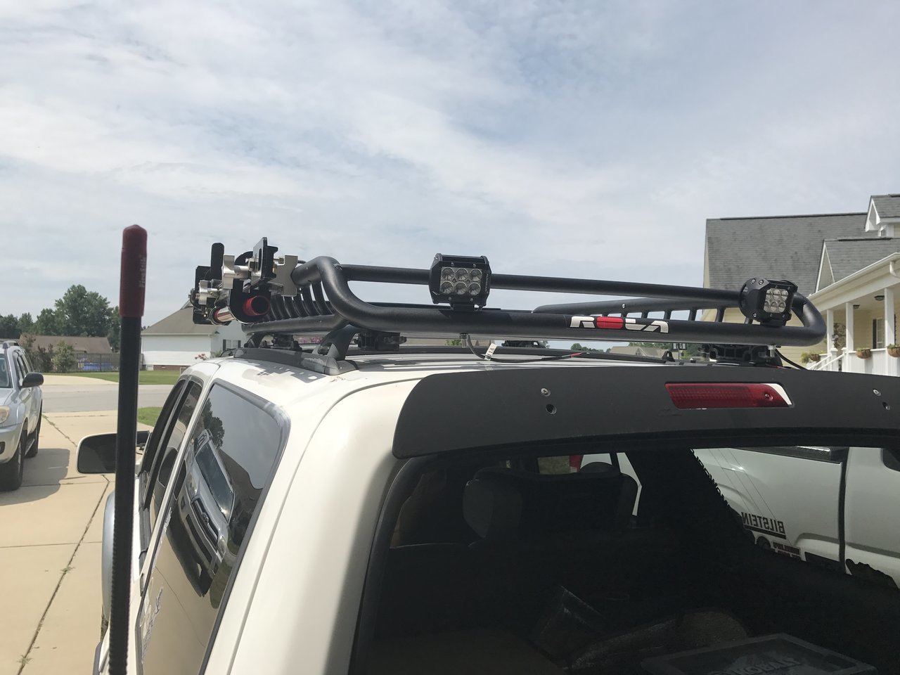

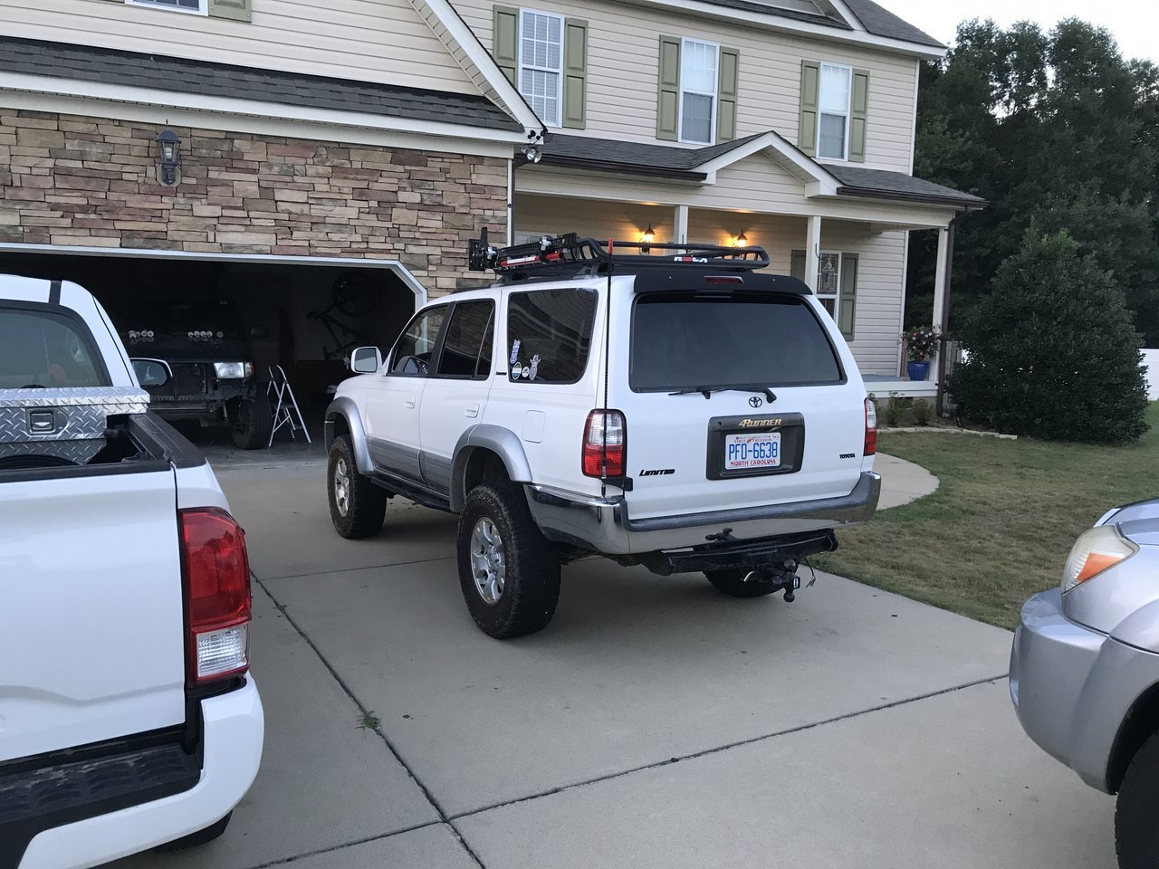

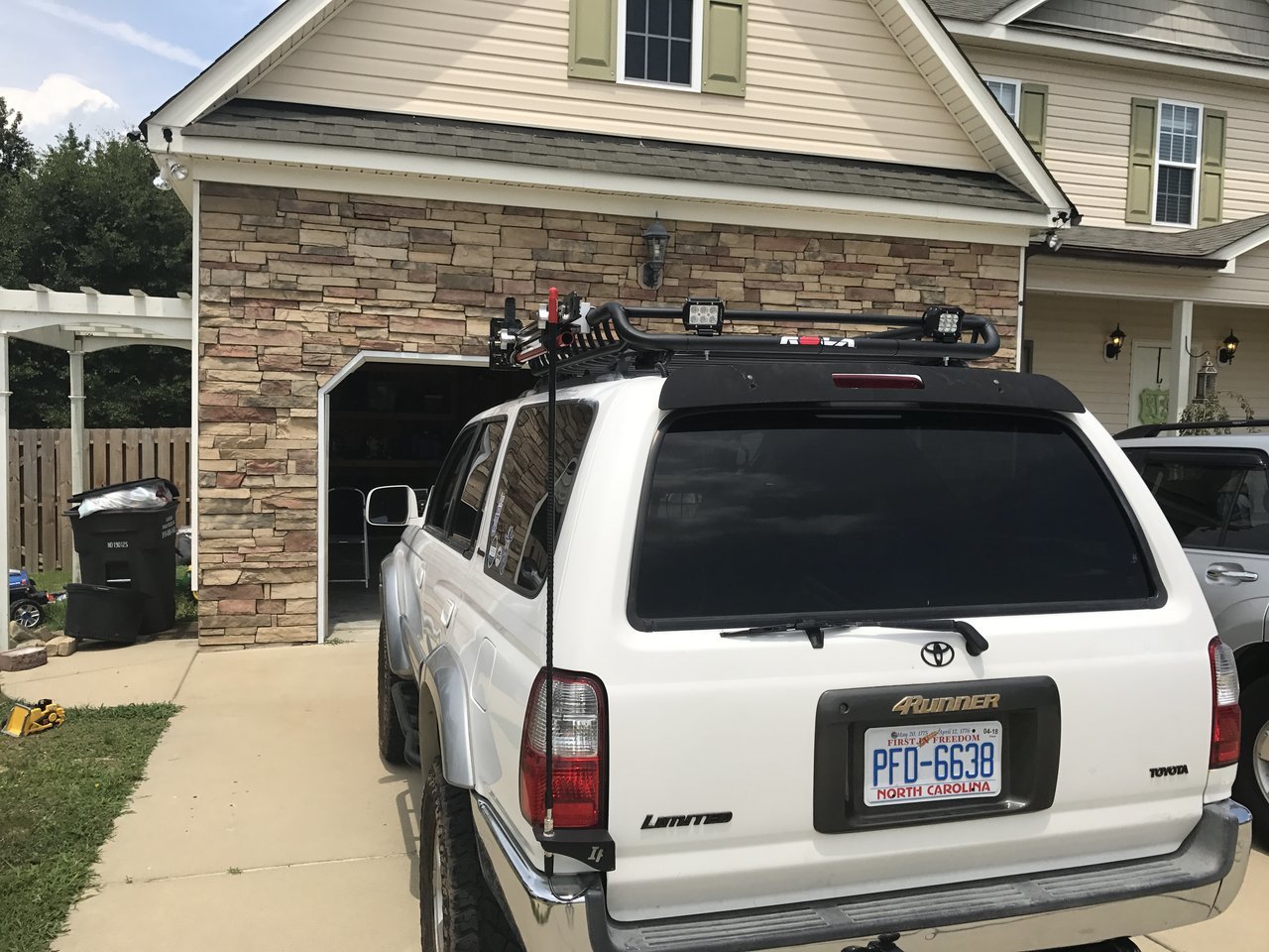

    Rack installed. Hi lift installed. Rear leds installed.IMG_0214.jpg IMG_0212.jpg
