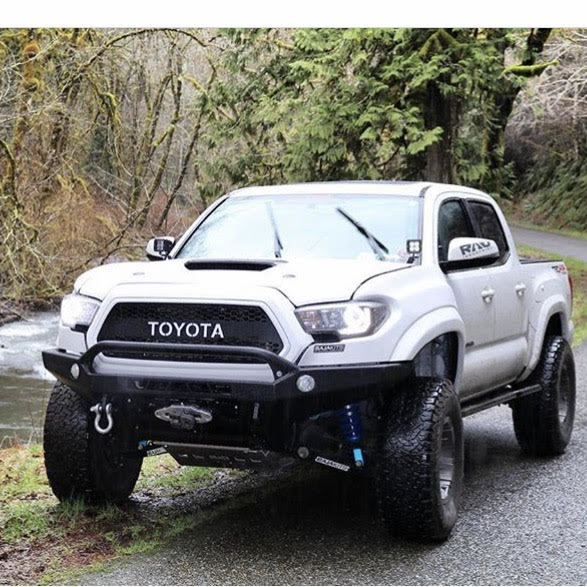

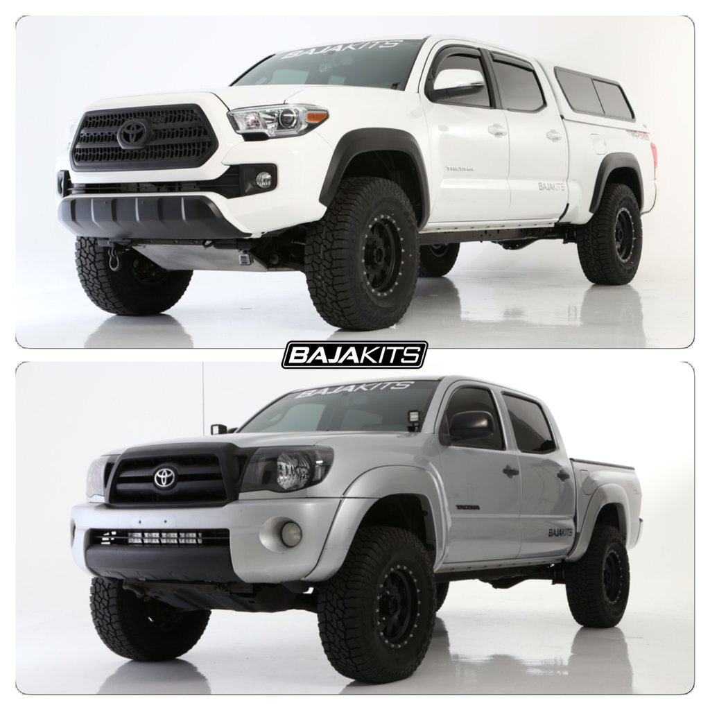

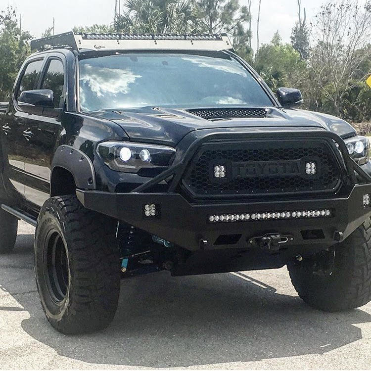

    We have both our Chase Kit ( Boxed Upper arm and King 2.5 Coilover combo ) and our Prerunner kit.
    Either one of these kits will get the job done but if you want to have more fun, our Prerunner kit is awesome!!
    P.jpg Max Tacoma +2 Long Travel 2.jpg unnamed.jpg 3Q6A3830.jpg 3Q6A2896.jpg 3Q6A5844.jpg Tacoma Gen 2 and 3.jpg
