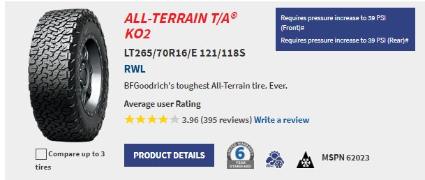

    PSI is a means to an end. That end is inflated load rating.
    A LT265/70/16 attains a load rating of 1,964 lbs @ 39 psi.
    The stock tire placard requires whatever PSI is required to attain a 2,149 lb load rating from a P-metric or ISO/ETRTO-metric tire.
    The SR, SR5,and Sport use a P-metric; the Offroad uses a ISO/ETRO metric
    SR/SR5-P245/75/16 109SL @ 32psi=2,172 lb
    Offroad-265/70/16 112SL @ 30psi=2,149 lb
    Sport-P265/65/17 110SL @ 29psi=2,149 lb
    If you go to an LT the load requirement is reduced by a factor of 1.1...2,149/1.1=1,954 lbs.

    Boom. Science. This is exactly what I was looking for. Thanks!
    Found the chart on Discount Tire as well. Now I just have to find a scale big enough for a Tacoma.
