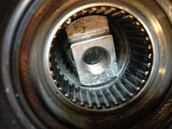

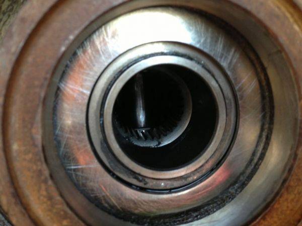

    well replaced the driver side cv and oil seal.....in process found lower steering stop bolt frozen......outer cv dust seal imploded.......replaced hub and bearing.....origonal oil seal was in perfect shape when we removed it....
    with the new one in it still leaks about the same.....
    i have loads on play at the needle bearing.....
    well i just ordered the solid spacer from ecgs.
    so it looks like i will be doing this again in future.....

    replace the drive side needle bearing in front diff with the ecgs solid bushing....

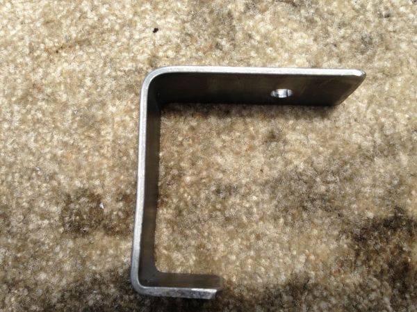

    this will be the holder for can carrier on my tire swing out.....

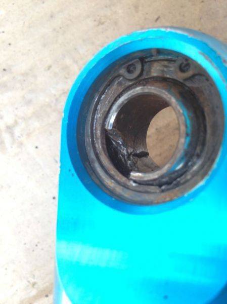

    replaced driver / pass cv's and oil seals,dust shields,lca's and lower ball joints, pass wheel bearing, and found these pos kings need some love
    replaced this
    with this
    and this

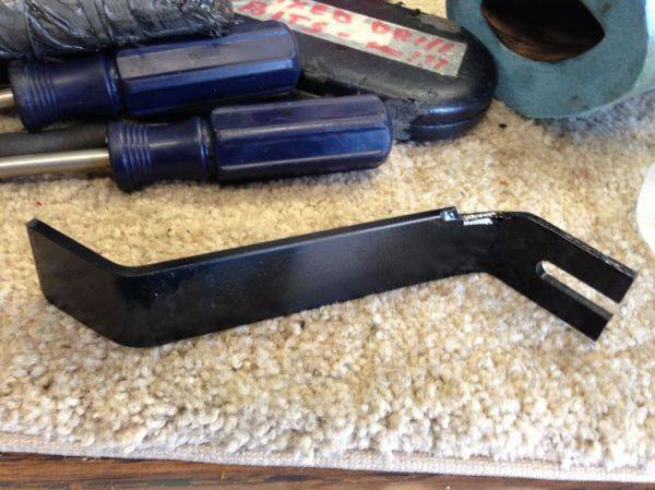

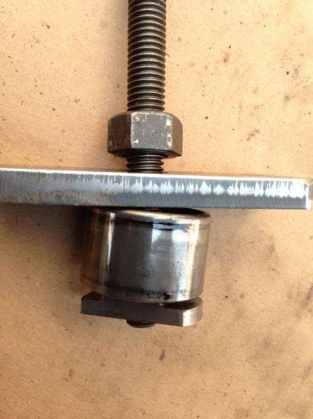

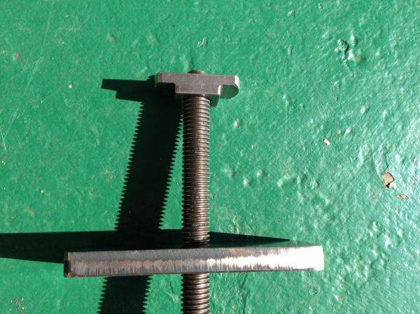

    this is the tool I used "thanks stickers"
    here is some work in progress pic

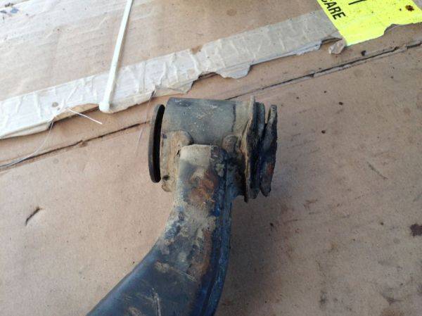

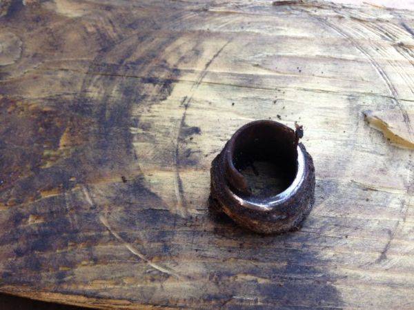

    the previous week I did the inner / outer tre's and upper lr bushing swap.....
    ouch
    should see the mounts....I need them cut off and new ones welded in......

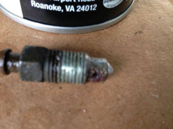

    also replaced a blow out rear brake line......

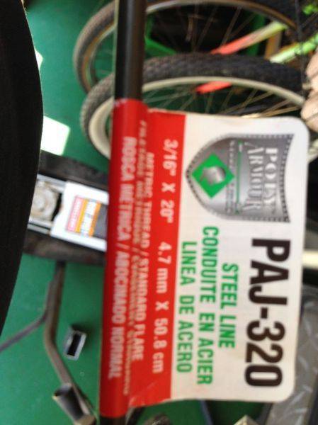

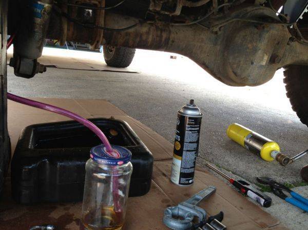

    here is the part needed

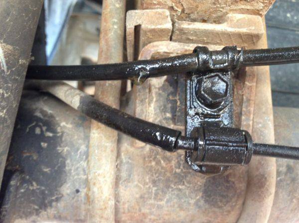

    here was the bleeder.....needed a new one
    then bleed the brakes

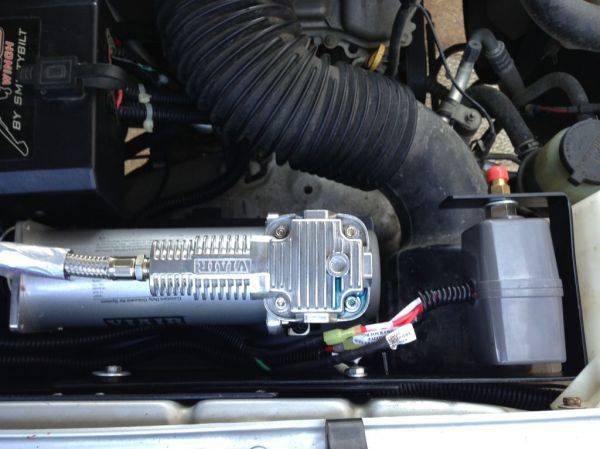

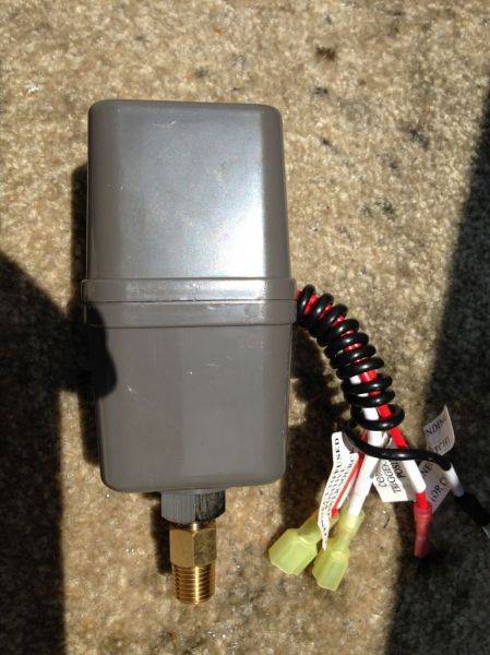

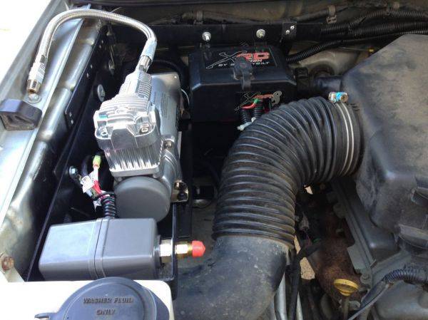

    so i installed my oba system today or at least part of it
    viair 450c 100% duty cycle and tank....

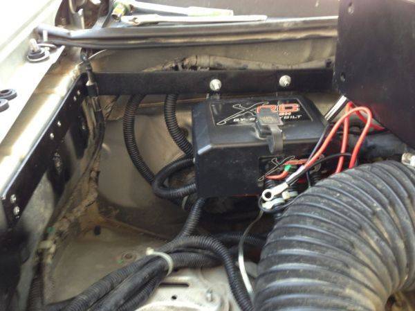

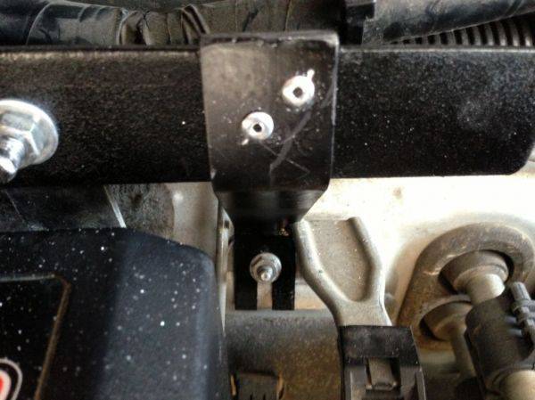

    had to relocated my winch solenoid as it was in the spot i wanted the compressor
    i tacked a nut to side of fender this way i had 3 mounting locations for compressor and also has a bracket under it......
    i also mounted and wired the pressure switch / relay......
    here are some pics
    i still have to mount the tank.....
    got it almost done but ran out of washers / energy and light......
    still waiting or air lines and fittings to arrive next week.....so no rush....
