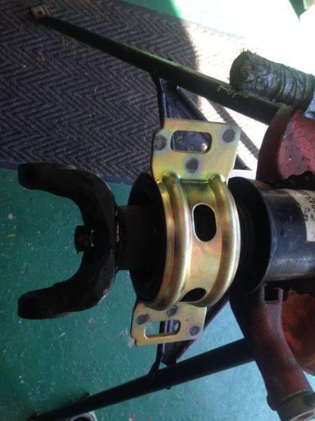

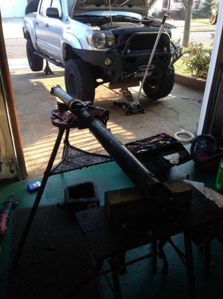

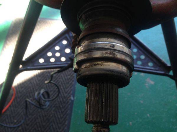

    so a little update
    wookie bearing shit the bed after about 10k
    well i was leaving for a road trip last week and i started to here clank on accel. and like a pop
    i just replaced the u joints and carrier with a solid bearing.......
    so i figured it couldn't be the drive shaft....
    so today i went through the whole front end all was well
    and then checked all the u joints..all seemed well
    wookie seemed well....
    so i pulled the shaft anyway...and swapped in my spare which i just replaced all joints and a carrier bearing..
    clunk is gone
    upon further inspection it would seem the wookie bearing can not tolerate the angle of the center support.....
    i did notice this when i installed it but went ahead anyway....
    will report further when i disassemble it....
  18. Dec 3, 2013 at 5:40 PM
    #538
    brutalguyracing
    brutalguyracing [OP] BIG DADDY
    Jun 28, 2009
    #19000
    24,052
    F.U> GUYZ
    broken mods

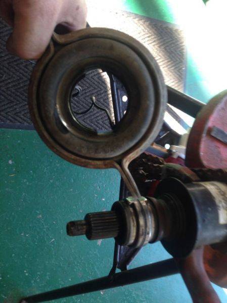

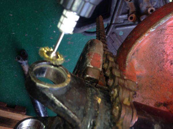

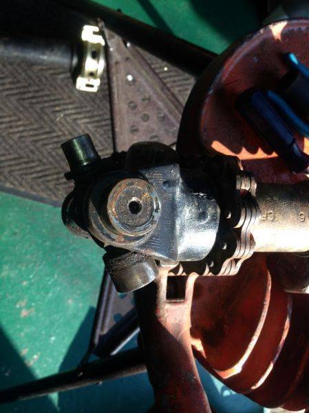

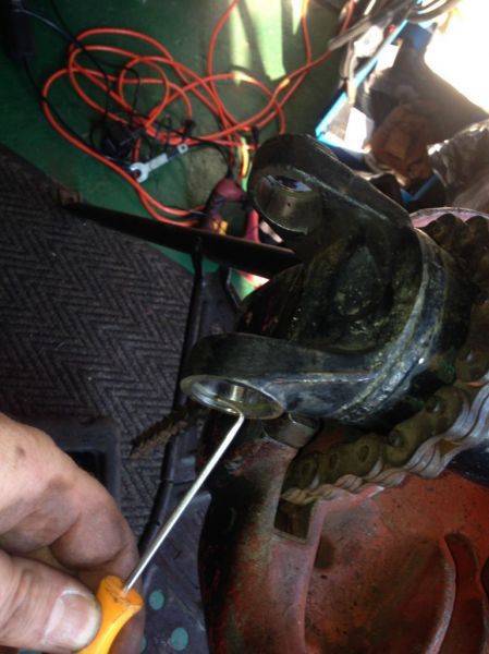

    remove old u joints "but first mark it so you know how to align it again
    clean out crap in ring seat
    wire wheeled it and filed burrs or edges from pounding with a deep socket 17mm
    unstake the nut holding the "yoke on" at least i think that's it name
    then i pulled the rubber from bearing "it was easy as it was shot"
    then i tried a puller and that sucked so i used a lump and a chisel and boom she was off
    then you torq it down to seat the new bearing i forget the specs off hand will add later
    then back off the nut and tighten to spec...and then stake it and install the last u joint.....
    and done
    I ALSO WANTED TO NOTE THAT THE MOOG 270 UJOINT SUCKED IN MY OPINION...I THREW IT AWAY AND USED THESE FROM FEDERAL.....
    THE MOOG ONE HAS A WEIRD GREASE FITTING FOR ONE....AND THE CLIPS ARE A DIFF SIZE "I HAD TO REUSE THE OLD UNTIL I REPLACED THEM ALL FOR HALF THE PRICE
    WITH THE MOOG INSTALLED IT WAS WAY TO TIGHT .....
    AND A LITTLE TIP WHEN U TAKE THE CAPS OF THE JOINT I PACK THEM WITH GREASE A BIT TO PREVENT AND NEEDLES FROM BEING DROPPED OUT OF THEM
    IF YOU HAVE PROBLEMS GETTING THE CLIPS IN AND THEY WONT FIT THEN CHANCE IS YOUR NEEDLES OR NEEDLE FELL OUT OF PLACE DURING INSTALL.....
    I DID ALL THIS WITH A HAMMER AND 17MM SOCKET IN ABOUT 2 HOURS......"WAS TAKING MY TOMATOE TIME"
