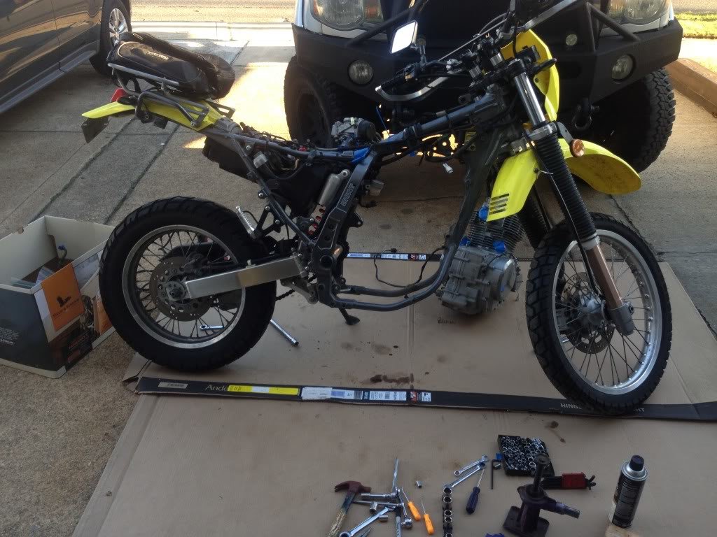

    bike update
    update

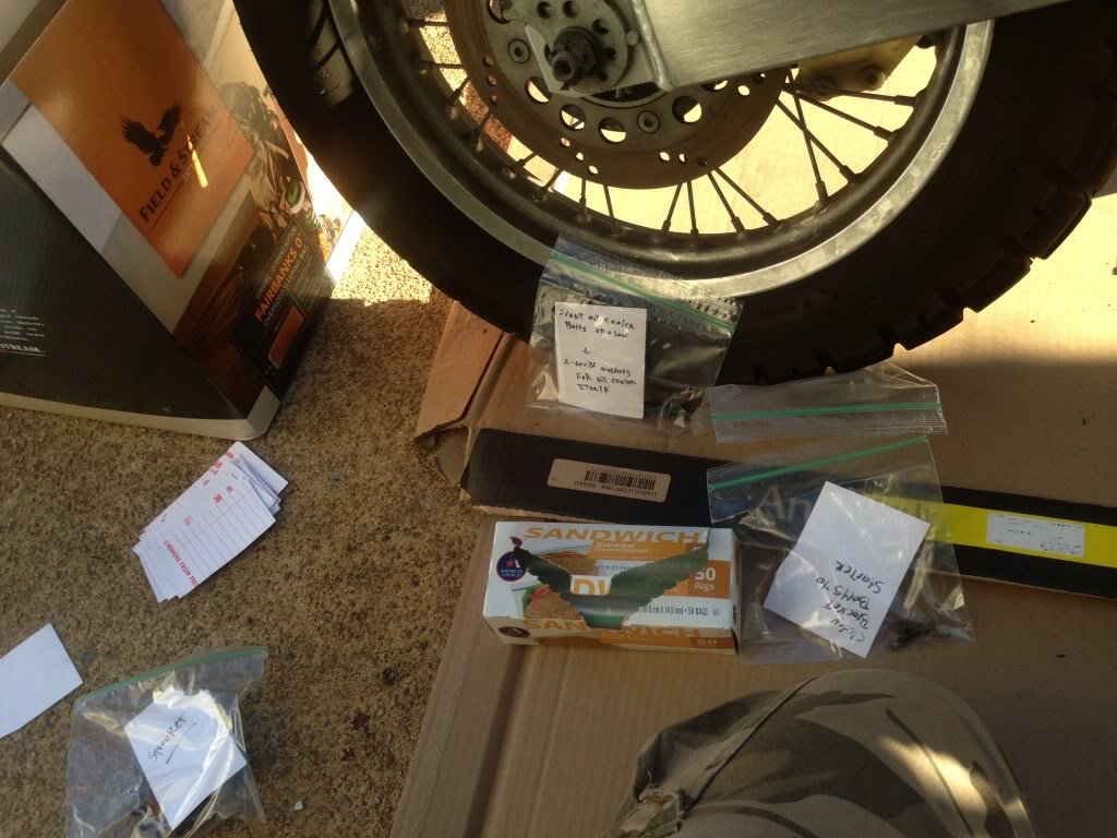

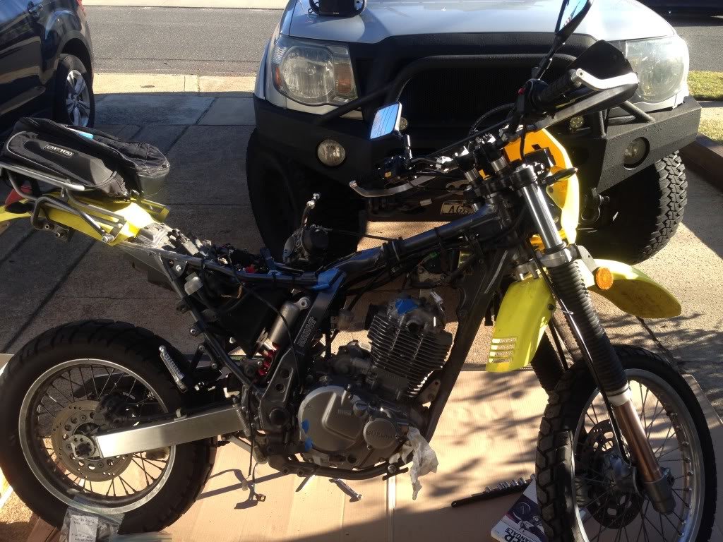

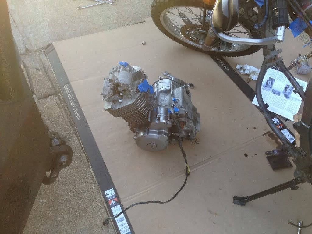

    so i got the old motor out today and the new "old motor" in place
    i still need to hook up carb, oil lines, starter,cct,brakes, clutch cables, ect
    and i need to swap out the starter gears.....
    i hope to do some of that tomm before the rain starts
    the motor was a breeze to remove and install by myself ....
    within 20 mins i had all engine mounting bolts back in place
    i took the motor out of the left hand side....with bike on kickstand
    lots of sandwich bags and tape to label everything.....
    here are some pics from today

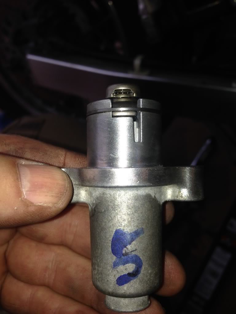

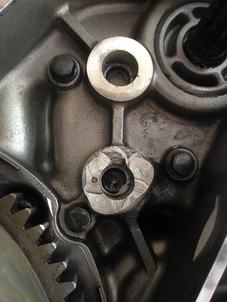

    i could not get the starter out without removing the CCT.....so out it went.....

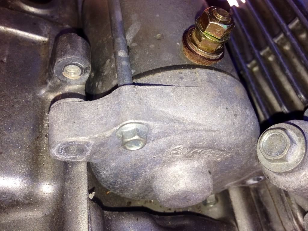

    i didn't try to remove the cap..but maybe if you did that you could gain enough clearance...but idk and did not try

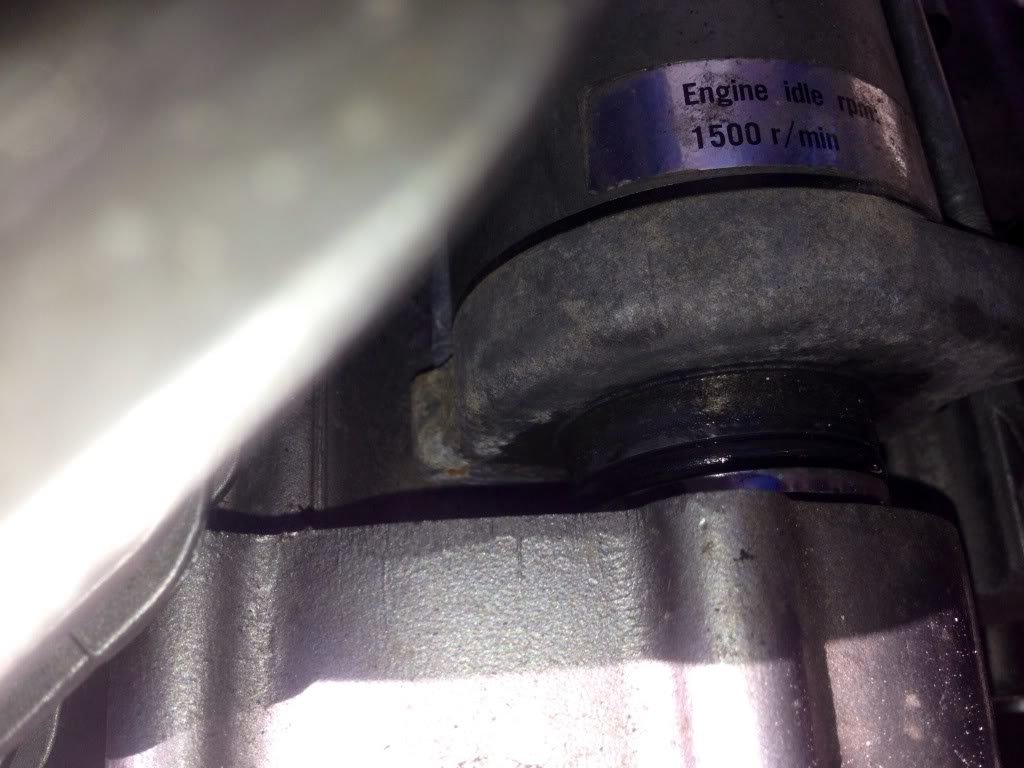

    here is the gasket......its the broken motor....on the new old motor face is clean and i have a new gasket...
    here is the CCT removed
    lots of sandwich bags....ahaha
    and she is out...not as bad as i thought it was
    i was thinking of mounts to mount them both hahaha
    then the insane clown posse showed up for a wheel bearing swap and drinking began and bike progress came to a halt
    to be continued

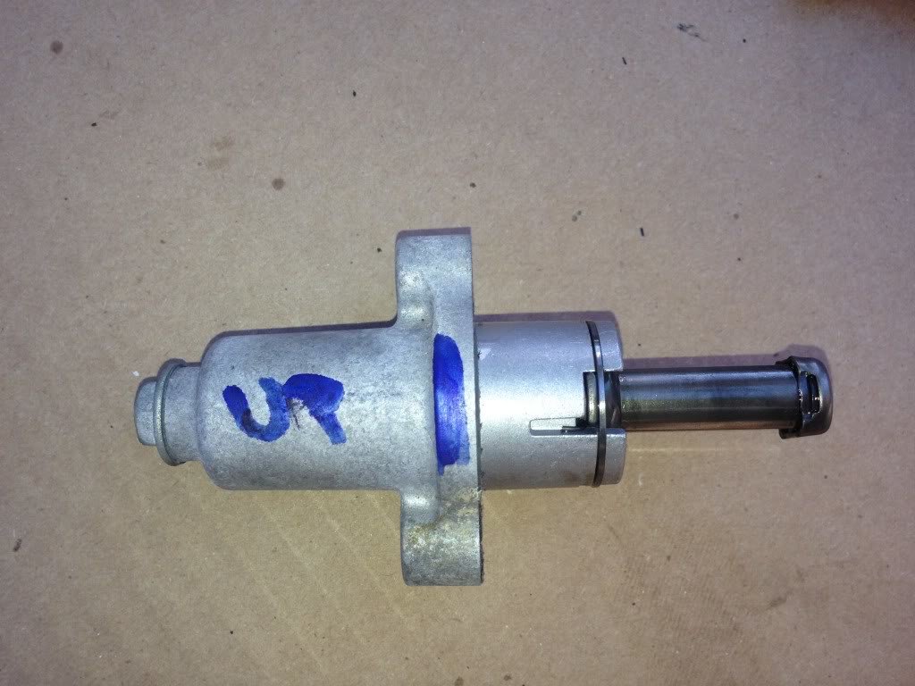

    then i installed the starter and cct

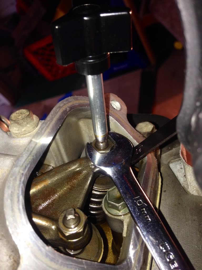

    then i set motor at TDC and removed the CCT and then re installed it....
    then i adjusted the valve clearances while i was in there....

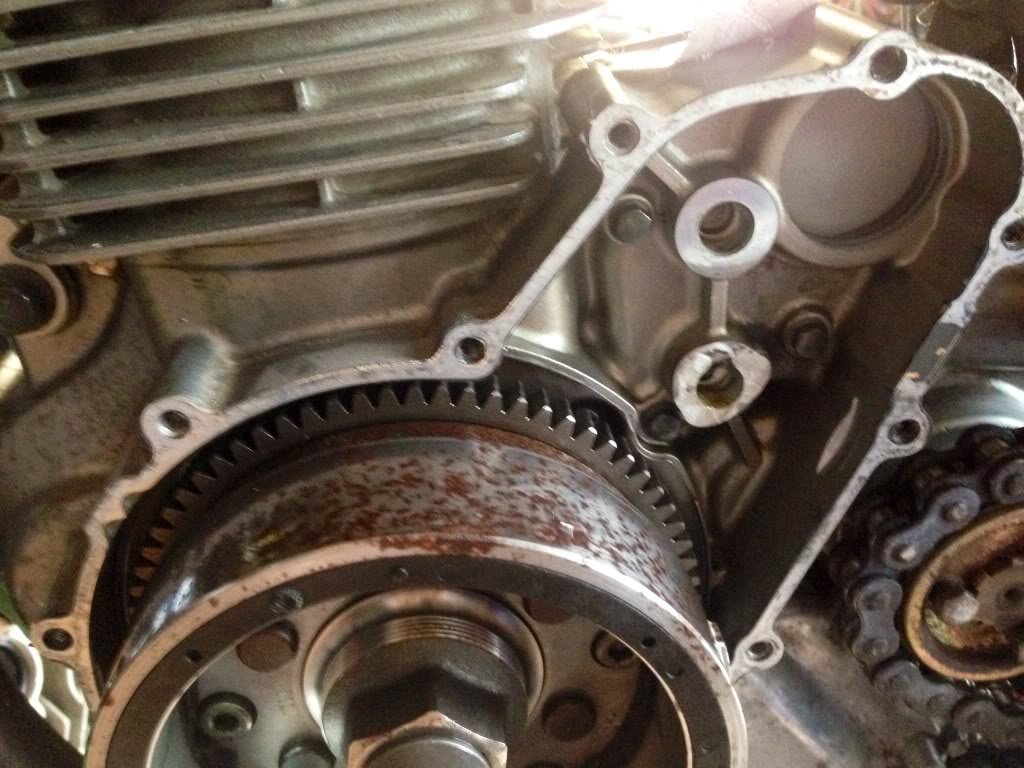

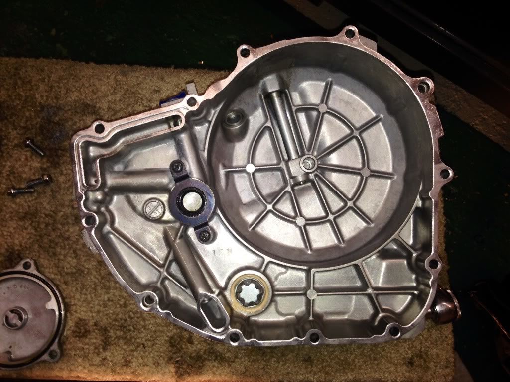

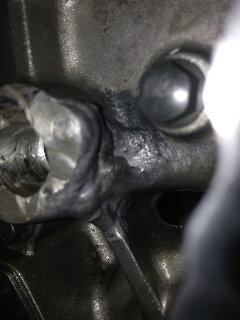

    i opened the left cover and found that it already had a starter clutch gear
    also found that this engine had a failure of said solid gear in the past and someone welded it back....
    that was not disclosed to me upon purchase...
    but it looks to be fine and a nice weld job too...
    i cleaned up the surface rust.....

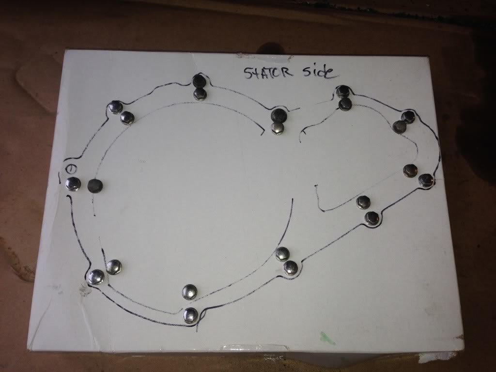

    then these gaskets KICKED MY ASS
    omg what fresh hell in getting the gaskets off.......like almost 2 hours errrrr

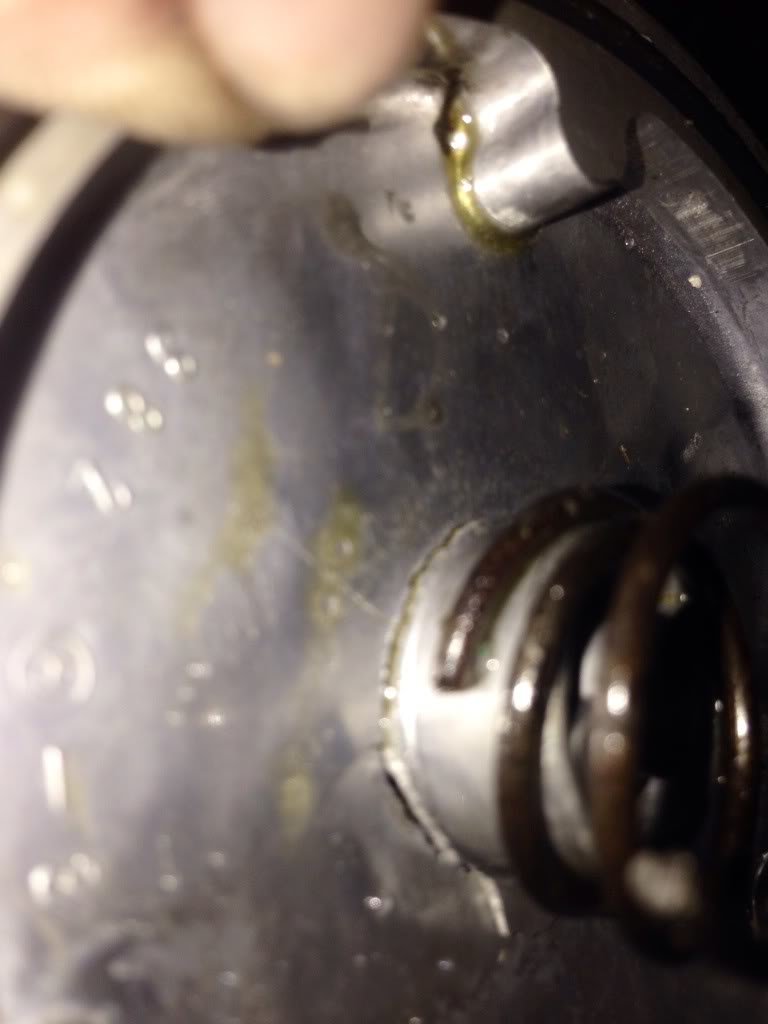

    also found on the old motor that the oil filter cover is cracked :maybe it happened during shipping idk
    but no problem as i have a nice donor motor

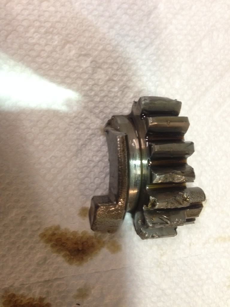

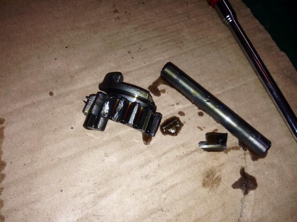

    then i fished out the damages
    it looks like something imploded unsure if its 3rd gear
    but it a gear......
