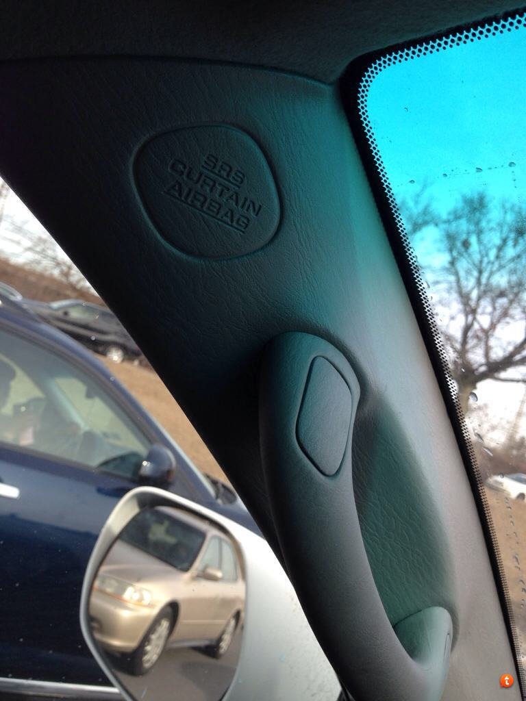

    You ever removed one of these
    Unsure about the airbag thing
    I need to run some wires down the pillar

    I have not. Be careful.

    It's the wife's T4R so it's stock
    If done it when helping audio installs...
    Comes off easily, don't run any wires over the bag itself... Don't slice or puncture anything...

    Really not that much of a big deal. Disconnect the batter leads and wait 5 minutes. The grab handle comes off real easy. Run any wires underneath the air curtain and not in front of the air curtain. It is real easy to get wires into the foot well from the headliner this way. What are you installing?

    For the love of God, disconnect the battery.

    i am looking to hard wire my gps unit in and wanted to run lines for some switches while i had the panels off...
    this way its all ready to go when time comes.....
    but i was unsure about the air bag sensor thing up there.....
    thanks
