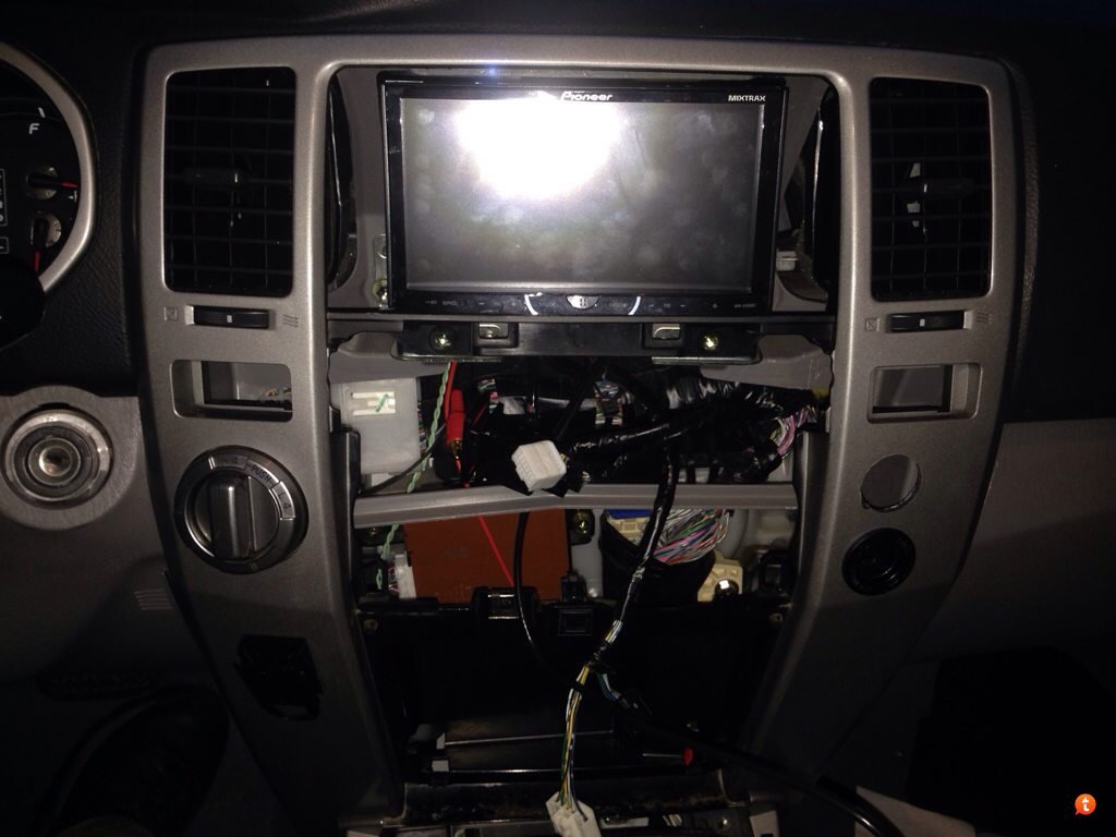

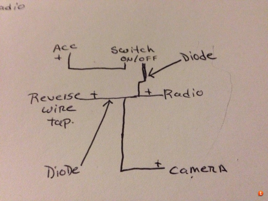

    Okay another rear view camera question
    I would like to add a switch to have camera on at anytime
    Thoughts
    do i need a spst on/off/on switch?
    or just a spst on/off switch
    Does this look okay

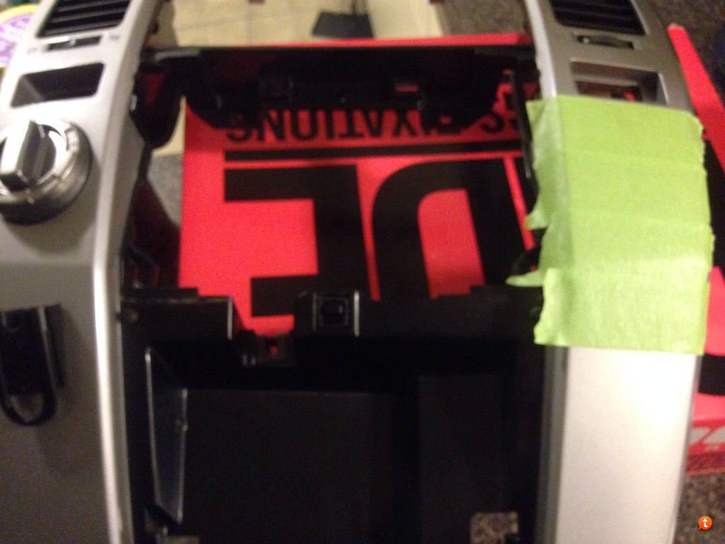

    Oh mr x
    2-1/8" correct

    Next to the ash tray? Go figure...

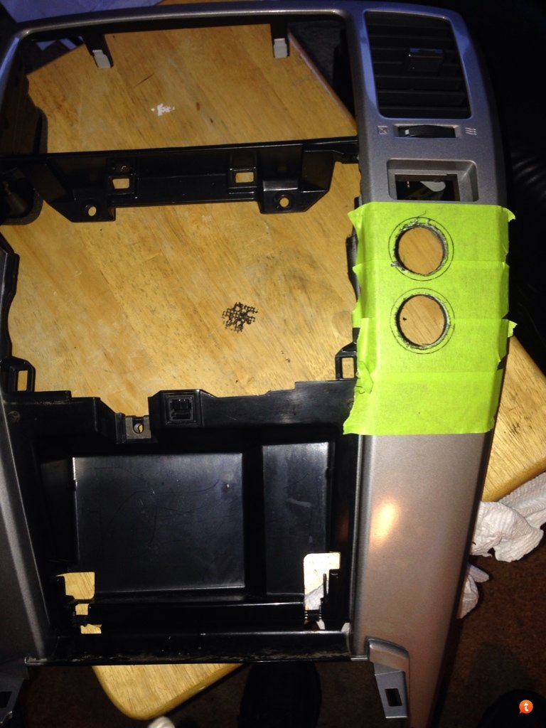

    is that what that is?
    is just a pain in the ass to hook up cables out of there....
    so they are going where the tape is on pic above
    1 cig outlet and 1 double usb port
    then i will install another for the usb plug on radio...

    My sPOD has diodes for LED's
    I can't wire shit like you can.....I'm taking the easy way out.
    I see how it is. No invite for me until the party is almost over :(
    29mm should work just fine.....or 1-3/16". USB is 1.12"........ might get away with 1-1/8" but it could be tight because it's only .005" larger than the USB :cool:

    INVITED ALL ON THE PLACE WE NO SPEAK ABOUT
    DIODES HA.....
    HMMM
    YEA WILL TRY THE 1-3/16 AND USE DREMMIL IF NEEDED......

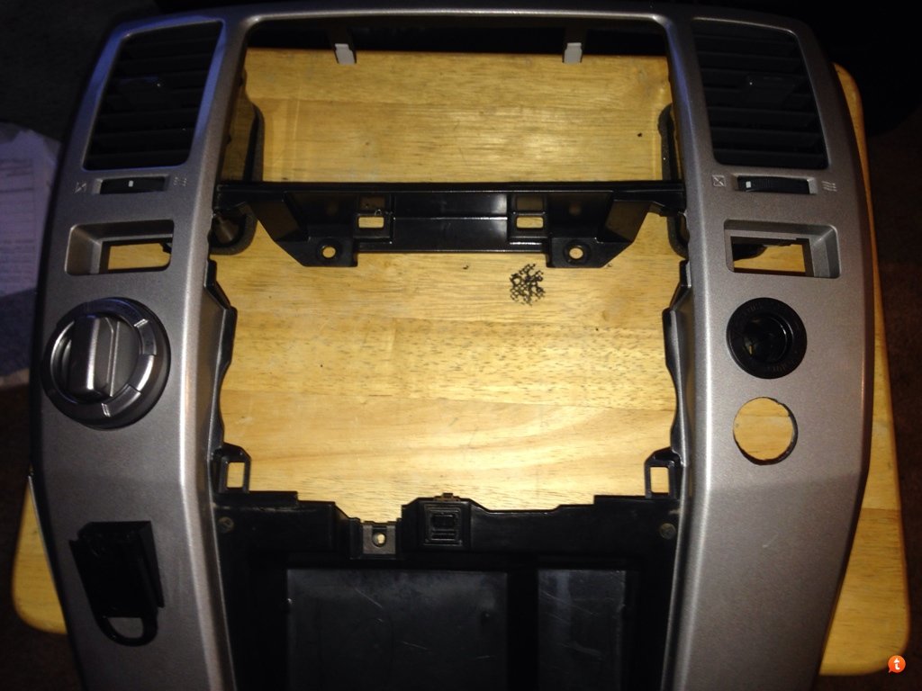

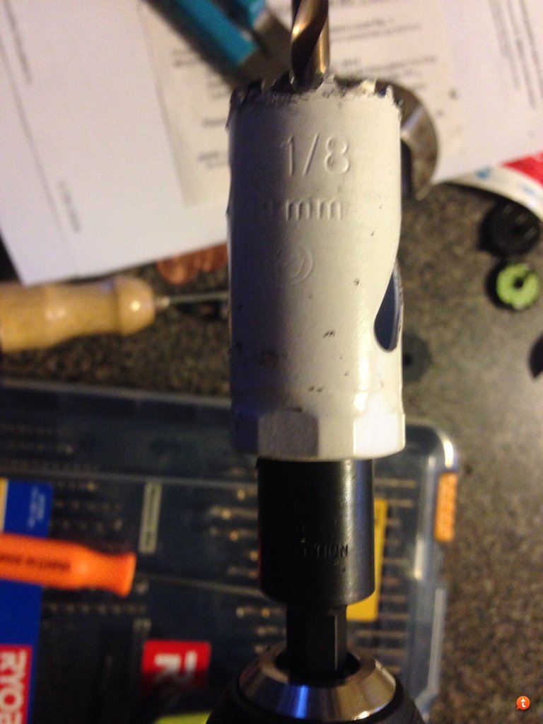

    So i drilled the holes today
    Used an 1-1/8" bit
    Worked perfectly
    If my calculations are correct there should be little to no trimming of interior dash piece
    I am still waiting on the double usb port to arrive so i can put the dash back together

    Incorrect
    I am like a surgeon
    They said id have to cut the plastic mount behind the panel
    Oh no i didnt
    Time is of the essence
    Wish it would come in already
    Wish i could have found one in a store close by
    Now if i could figure out how the metra face plate mounts id be in good shape

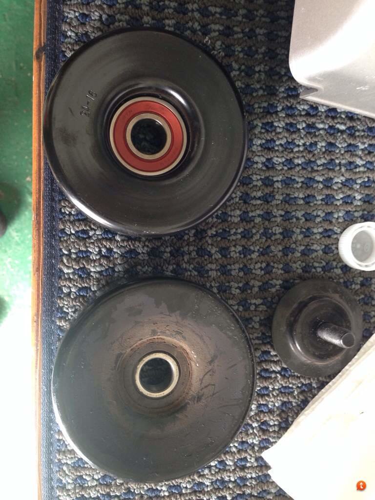

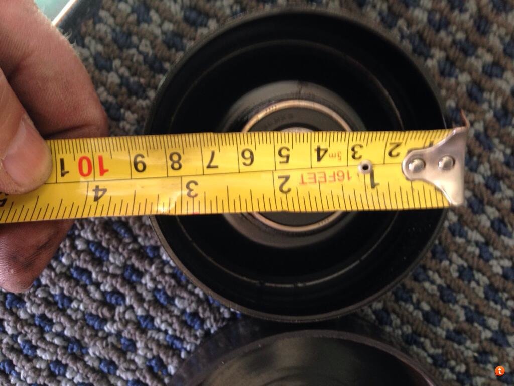

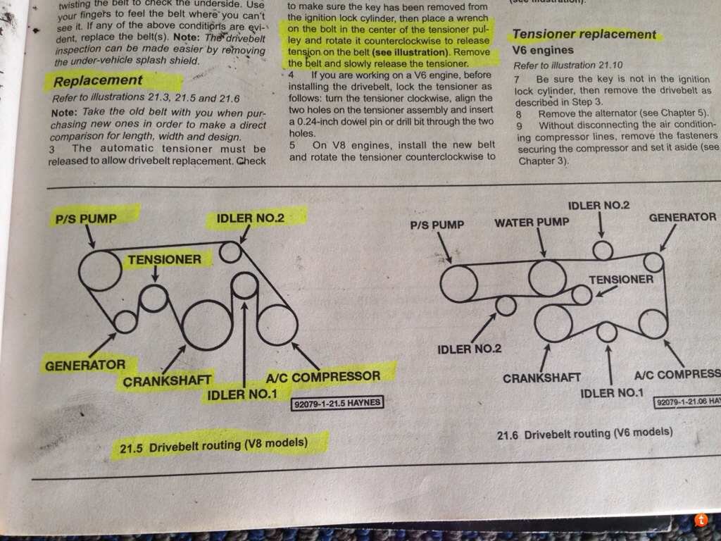

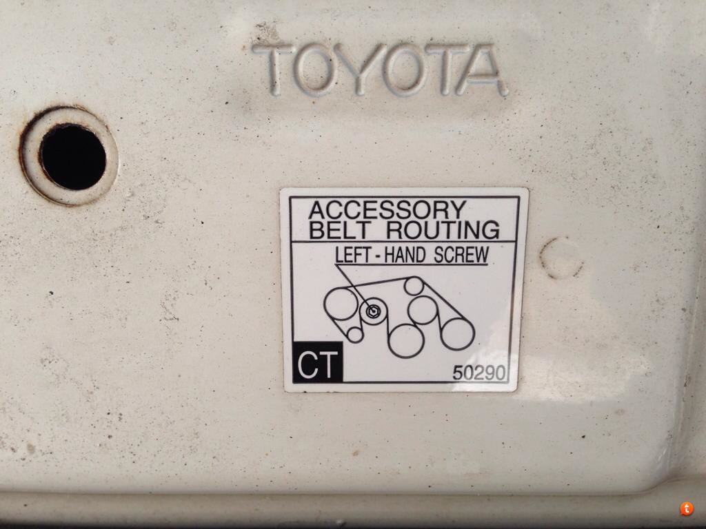

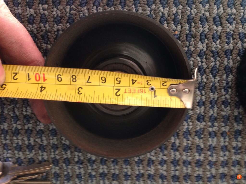

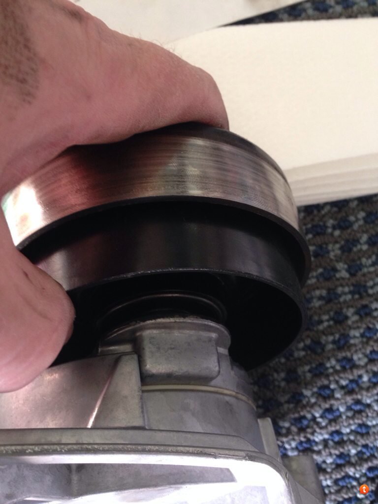

    SO TODAY i decided to change out my tensioner pulley and swap the belt and idler pulley due to crazy squeaking noises
    ordered from rock auto last week had the parts sitting here
    so i went for it....
    removed the tensioner pulley and the new one was 1/2"-3/4" too small
    fml
    ok no problem i will take my bike to the store...oh wait i left my bike keys back at my apt.....
    fml
    put old belt back on..
    drive to 3 stores to find one in stock
    get it , put it on , put new belt on...
    its a pita let me tell you, although i did get faster at it....
    im bloddy, burnt, scraped up..
    but shes on and no more screaming sounds
    ok now lets mount the backup cam for good and run the wires
    no problem...wait MAJOR PITA.....
    HOLY CRAP WHAT DISASTER ...
    mounted the camera..poped the plastic piece off and cut gromet got wires into tailgate all is well
    go to run wires down tailgate...what a PITA.....
    leave the rca plug on the end you say...ok i tried that....rca cable torn in half
    again FML.....
    get cables run into top of tailgate...now to get them through the last rubber sleeve and into the roof area.....again omg PITA....
    ended up slicing the rubber boot right where the clip is and tapped it up after....
    well i now have power and ground and whats left of the video rca cable into back roof area.......
    called it quits today before i punch something or someone....
    went out for a ride on my bike.....
    was it worth it to save $150 idk....
    im getting older and i think next time i will let the guy at the radio store tackle it....
    and i am only half done
    now i need to wire a switch into dash and run lines to front and pray she works......
