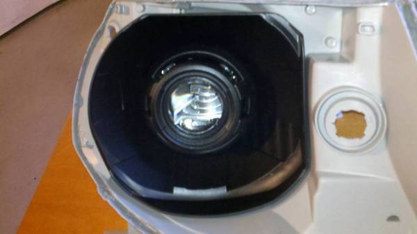

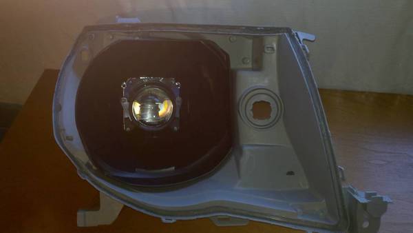

    Some pics of my new project thanx to TW for all the useful info still waiting to tint my turn signal and reflector. [​IMG]
    Awesome Clarity on these lenses the kit is Mormoto mini d2s 35w philips 85122+ Bulbs apollo shrouds

    what temp?

    4300k i think not sure though

    if you can do BHLM then you can do this no mod to reflector bowl just get rid of stock reflector

    Nice:D you didn't have to make the opening in the bowl bigger for the projector or anything?

    it goes thru where the oem bulb is and has an alignment washer so it can only go on one way ensuring proper alignment still needs to be tweeked before sealing but not as much as say FX-R

    It really just fits right in?

    using 1/4" window weld I got from Amazon. Waiting on the VHT nite shades to show couldn't find any in town so i ordered it should be here wed. cant wait to show them off :D

    also headlights are from ebay. they were chrome with clear turn lens and clear side reflector not orange, so when i tint side relector it will look like the turn lens and not orange plus taped off under the reflector so it is still chrome underneath so it hopefully will still reflect
