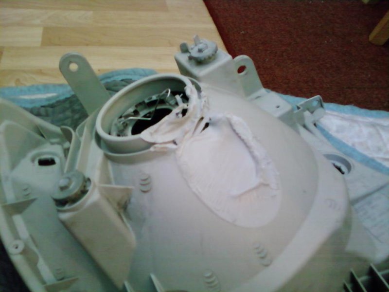

    Make sure to use something non-heat conducting material between the tray and lights, like cardboard or plywood. I used aluminum foil first since that is what the DIY said, the plastic housing melted.:(

    aluminum foil! wow, i never noticed than in the dyi. that shit needs to be corrected asap! but again... the material doesnt really matter, just the temp of the oven. pre heat first. throw them in. 5 min. peal. paint. repeat.
