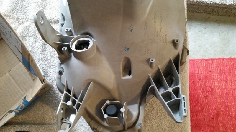

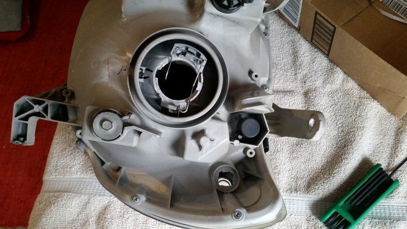

    Anyone here know exactly where all the screws go? I have mine apart and can't remember where what goes. I have 4 torques screws, 6 small philips, and 4 longer more galvanized philips. Help a homie out

    Hopefully this helps, did mine a couple weekends ago and took pictures to remember where everything went. The four long screws hold in the turn signal bowl and the plastic trim piece on the front of the headlight.

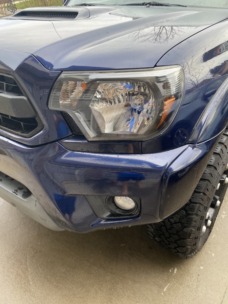

    Gregg
    Hollywood
    Thanks. I actually got some oem lights for free so I didn’t have to take mine off first for the process. $12 for paint n silicone, better than spending $420 for trd pro lights12AEB820-CE80-404D-A1BE-F3F1F24A53B7.jpg
