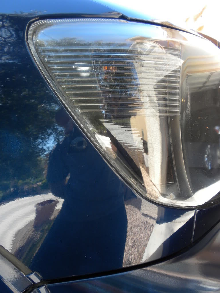

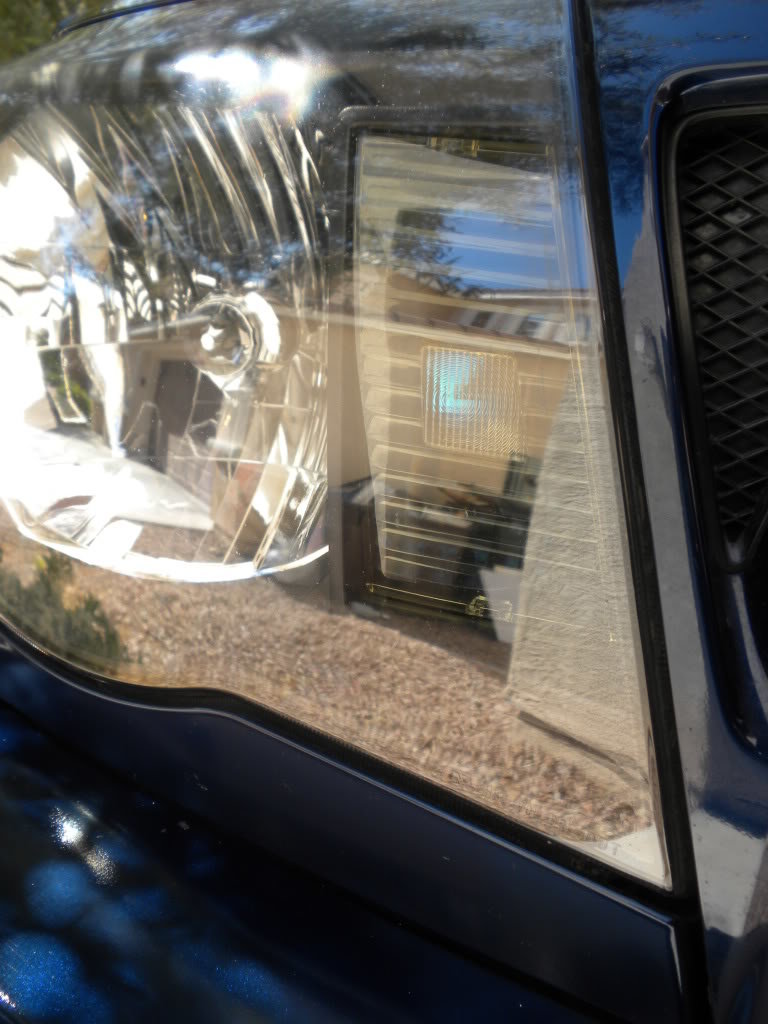

    x2, I just redid mine to remove the haze from the lense from putting it together too soon after I painted and it hadn't cured all the way. Do yourself a favor and let the painted cure at least a full day, not just till it is dry to the touch.

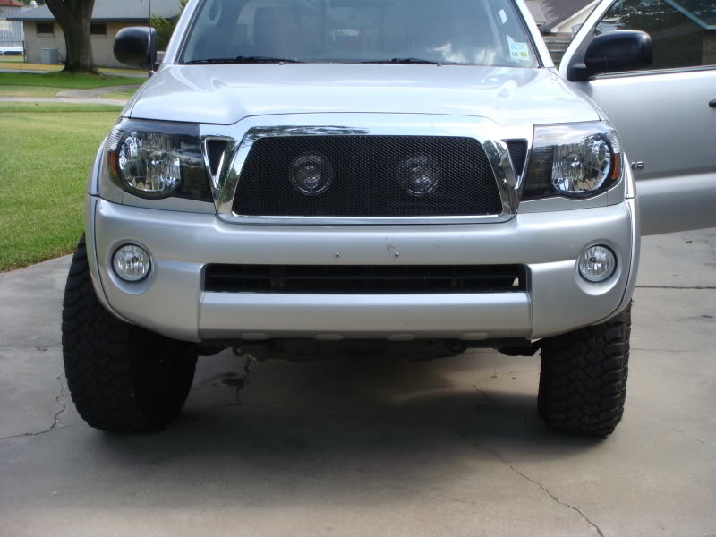

    I preheated the oven to 305, put the cardboard in, shut the oven off, then put my lights in for 9 mins....I wore gloves to pull the lights apart cuz that shit is hot as a mutha.
    I used krylon fusion paint, gloss black, and I let that shit dry for awhile before reassembly. Take your time on the reassembly bc the paint isn't very chip resistant.
    I bought some clear outdoor/indoor window/door silicon, and applied a bead to the inner housing piece and the light socket for the turn signal, then I pressed the two together, then put the whole housing back into the oven at 300 degrees (turn it off) for 5 mins to soften up the factory caulk. When you pull it out the oven, press the two even more and make sure all your tabs are locked back in place.
    You want to let the paint dry because if you don't and it cures while fully assembled the fumes will fog your lights and of course, make sure you have a good bead around the whole thing to lock out moisture.

    oh no man, no need to apologize...I'm sorry for not being more detailed. I sprayed the first coat, then waited about 20-25 mins, applied a second coat, then I waited for about two hours....I left them out in the sun and tried to keep them away from flying debris, it was a windy day.
    Some guys say to wait 24hrs, I don't have that time....I waited for I guess a lil over two hours, maybe bc it was a reallly hot day they cured faster I'm not sure, but I don't have any fumes foggin up my lights.
    When you pull the headlight apart, you'll know what I'm talking about....you'll see the factory caulk around that socket, I just reapplied for safe measure
    When putting the painted portion of the light back into the lens portion of the light. I didn't use wax paper/tape/or newspaper on the edges. Just be care putting it back in. If you're facing the front of the truck, the corner thats towards the fender side of the truck goes in first. You'll see the two places to rest your colored piece and slowly snap the rest of it into place, then place your two screws back in.
    Hope this helps a lil, thanks for the compliment
