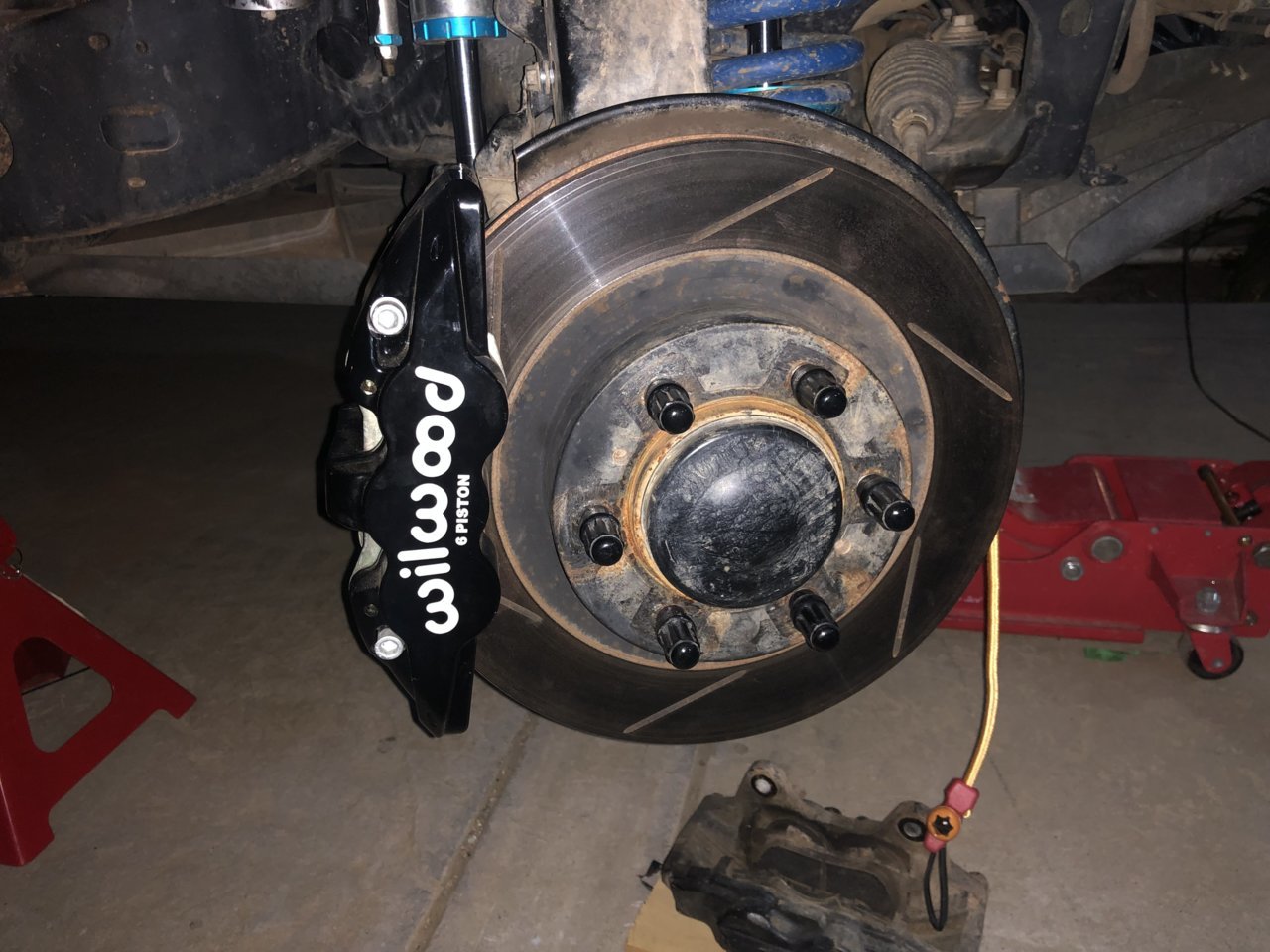

    The common options out there:
    Tundra Kit
    5th Gen 4runner Kit 338mm rotors - slightly bigger piston
    Willwood kit from RR-Racing - Uses Aero6 6 Piston Calipers and you can run 5th gen 4runner Rotors (338mm)
    Willwood BBK directly from willwood (Runs 342mm rotors) 6 Piston Calipers
    Stoptech BBK from SOS Performance (Runs 342 mm rotors) 6 Piston Calipers

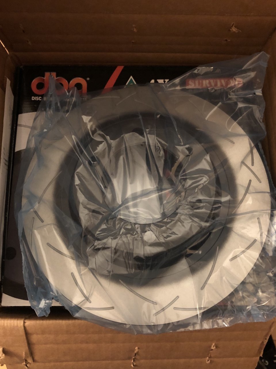

    There are other but these are the more common options you will see. I went stock, 5th gen 4runner setup and now I am running the Willwood setup with 5th Gen 4runner sized rotors. Currently running Stoptech rotors but have a setup of DBA 4000 offroad rotors next. I went with this kit after the 4runner setup as I can pick up this rotor pretty much anywhere in a crunch if needed. The Aero6 setup I got are the Aero6-DS models that also have external dust shields for better offroad protection.

    I was already running the 5th gen T4R and the idea if I ever needed to swap a rotor while out (although lower likelyhood) I could run to any part store and get one. I did think about the direct kit from wilwood. I got a great price on the calipers from RR-Racing and a steal on the DBA (still need to put them on). More options in rotors etc. Its only a few mm smaller.

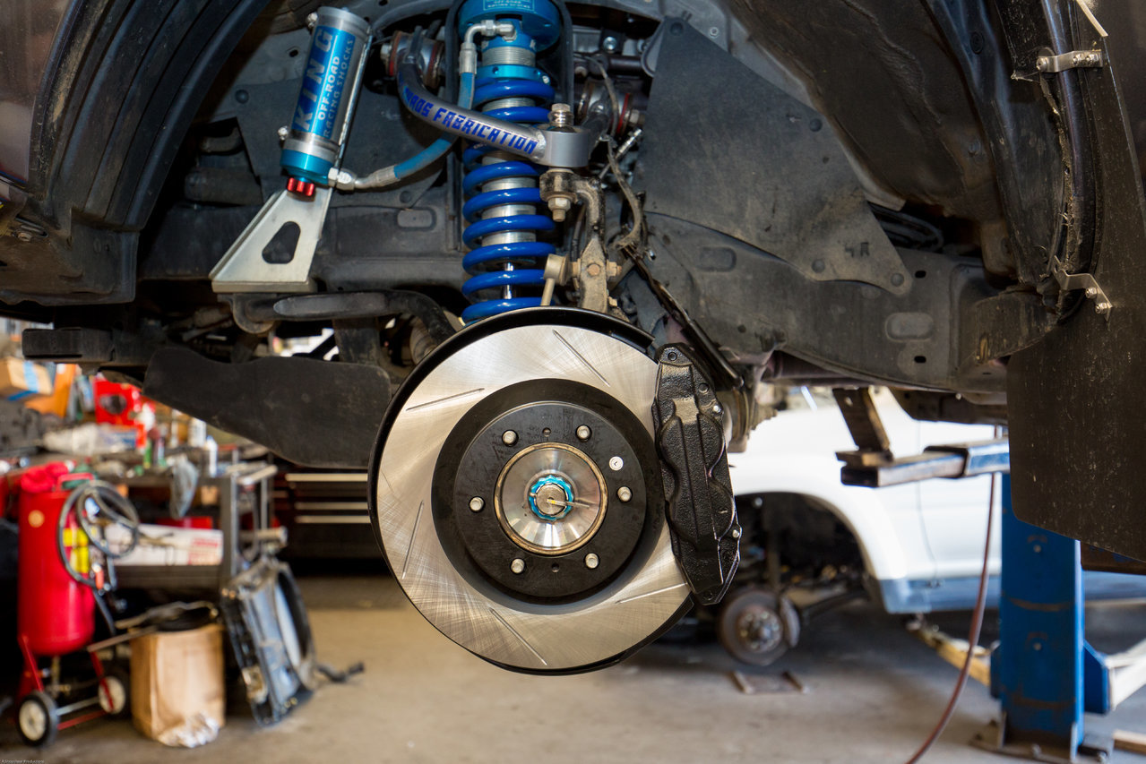

    TRD cai, TRD cat back, JFR y pipe,Wilwood BBK,LEDs, Limited Homelink mirror,debadged,WeatherTechs,Dynamat Extreme sound deadening,sabm second snorkle to fender, Huper Optik ceramic tint, TRD Sema wheels, aerodynamic under body pan, OEM Audio Plus 500Q reference system, Depo faux pro headlights, real pro fog lights, OV tune, OEM aluminum filter housing, Mobtown IFS skid,TRD oil cap,TRD radiator cap, Osram Night Breaker 150 halogen headlamps, Fumoto valve,dashboard blackout,OEM tailgate power lock, MESO steering wheel logo, MESO two color dome light, TRD Pro coilovers, Artec LCA skids, Volk TE37 XT forged wheels, Roadmaster Active Suspension Garmin Minicam
    I have had my Wilwood BBKs on for the last 2and1/2 years and have been very pleased with the improved stopping ability. One nice side benefit is that they reduced the unsprung weight by just over 26 pounds. I found that out by weighing the original Wilwood box and then weighing it again with the OEM brake parts that I took off. In my pictures you can see me cutting off the dust shield but I found out from one of the 2nd gen owners who only bent the dust shield back that it was not necessary but it was not a big deal cutting them off. Both 2nd gen and 3rd gen use the exact same brake parts so they are compatible on both gens. Good luck with whatever way you choose to go.

    There is a thread on the tundra swap, I have a thread on the 5th gen 4runner swap. Missed in our BBK discussion. I’ll post if I see it. All great options. @skyking3 does your kit use the super lite calipers?
    hard to beat to beat the look of 2 piece rotors.
    this is the 5th gen 4runner setup. Can be done under $400 easy
    Rr racing kit with Aero6 willwood 6 piston picture is the same rotors above
    I’ll be tossing these on next

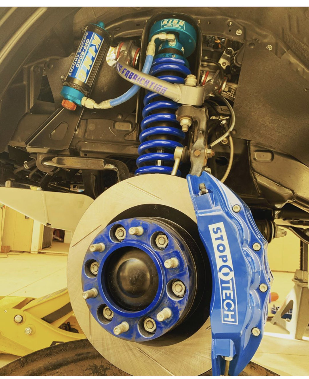

  17. Aug 1, 2020 at 8:22 PM
    #17
    KrnTaco08
    KrnTaco08 Well-Known Member
    Jan 1, 2017
    #206241
    1,860
    LA
    2017 Taco
    Here is mine for reference
  18. Aug 1, 2020 at 8:27 PM
    #18
    nudavinci64
    nudavinci64 Robert @ Holy Horsepower
    Nov 14, 2013
    #116533
    9,860
    Robert
    San Mateo/Cayucos, CA
    13 S/C TRD OffRoad 4x4
    Boosted Money Pit....
    Nice! Basically what I am running but with Wilwoods.
