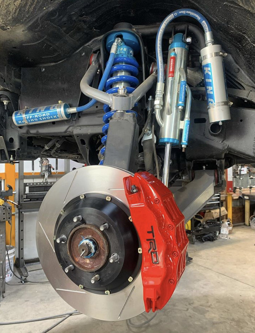

    I had my kings custom painted and added the fins. Thank you though

    I'm still liking the custom powder coat job. :)
