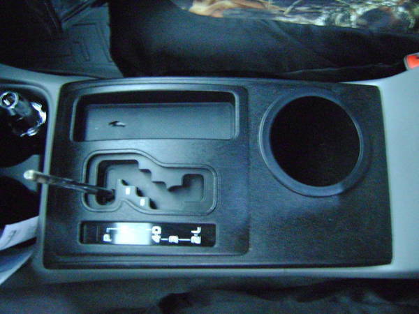

    I have has a couple of people ask how i did this mod so here goes.
    what you will need
    spiral saw
    cup holder the one i used came from West Marine part#396574
    http://www.westmarine.com/webapp/wc...toreNum=10115&subdeptNum=10715&classNum=11219

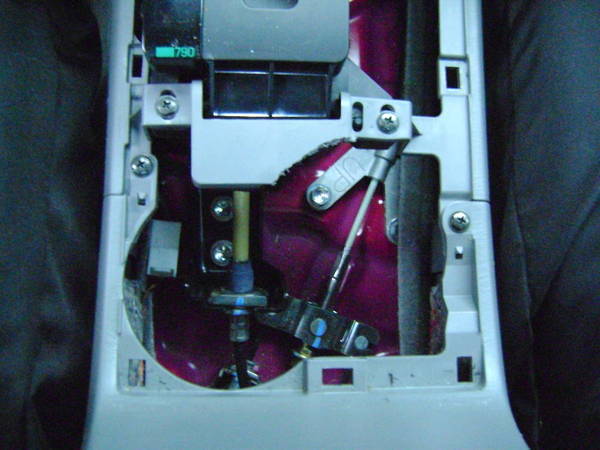

    First you will need to figure out where to put it look behind the console to see what is back there before you start cutting.

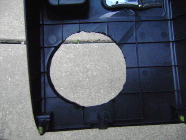

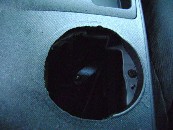

    Then cut hole for new cup holder do a little at a time till it is perfect
    I also had to trim part of the shift mechanism, it just holds the rubber piece that slides when you shift.
    After everything is trimmed I bedlinered the consol.
    This is the finished product
