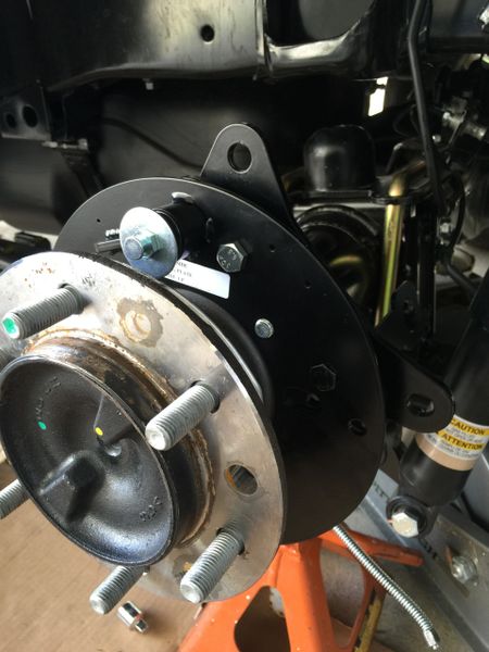

    Thanks again for taking the time to make the video, it was most helpful. I had time to go through the whole thing this morning. I've got both the rear disc and m/c kits, along with the braided rear lines, queued up at S.O.S. and wanted to watch the video first to make sure I really, really wanted to get into this. I enjoyed your 10 min. ramble session (I like rambling almost as much as a good Rant&Rave). The scary part was riding along with you in traffic knowing you had iffy brakes (at that time) o_O. What did you have to do to get them bled, finally?
    Do you think I could get the part numbers for the 0-rings, brake line clips, and whatever other parts you ended up needing that weren't included in the kit(s). That time where you showed the O-ring number went by quickly and I couldn't find it again.
    Also, would you happen to have a link to the diagram that you tacked up inside the wheel well as a guide?
    Lastly, and probably most importantly, I'm still confused about this backing plate thing. You mentioned in the video piecing the old plates back together, and @stevotivo12 talking about cutting the old ones down (to cover the disc hat), but the photo on the S.O.S. site (of the assembled drum brake portion) seems to show a spiffy new backing plate.
    What am I missing?

    Heh. The brakes weren't that scary. To get them bled I used a Motive style bleeder and getting the ABS pump to cycle with emergency stops. Pedal is awesome now.
    The diagram does come with the kit. Most helpful thing.
    The stock backing plate is removed completely and replaced with the SOS piece. The SOS piece is two pieces so it's easier to reinstall. Also makes parking brake adjustment easy.
    I don't have a part number for the line clips and Stoptech wasn't helpful. I couldn't find a part number for the OEM clips, but they definitely work.

    Phew. Wasn't sure I saved the other o-ring. Part number is 90301-8300. There's a two on the end that I'm not sure is part of the number or how many I needed.
    There's another video I did on YouTube that details how to save some money by piecing the kit together yourself. Might be too late. His MC kit was priced well from what I could find.
