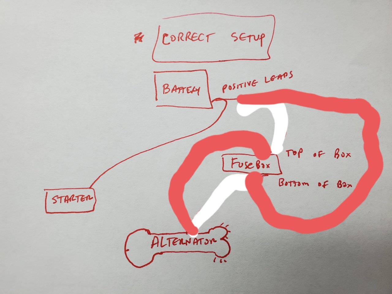

    Even if you routed that wire to the original location (the battery), the circuit path would be the same. It would still bridge the alternator fuse. This kit is badly designed from a circuit perspective, not necessarily a materials or construction perspective.
    The correct method for your use case as I understand it (wanting a high output alternator to feed the battery during winching), aside from a second battery, would be to preserve the correct wiring path and upgrade the factory fuse. They are not commonly available in the form factor that bolts in the factory location, so it would require modification of the fusebox - possibly by inserting a jumper and using an inline or ANL fuse of the appropriate rating - but this is beyond the scope of a Big 3 kit.

    We will have to simply agree to disagree. There is nothing inherently wrong with the wiring kit itself. It would route power correctly for any heavy load or high output alternator system. Just have to get the other wire routed appropriately, or fused itself for protection.

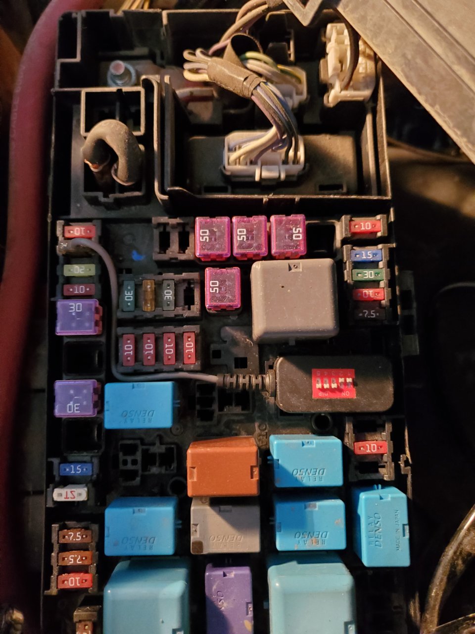

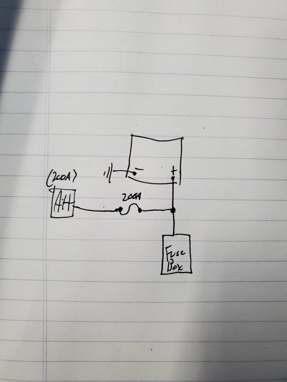

    Ok so I just did the wiring upgrade this last month and the best picture I can draw on the spot showing the wiring from the alt to the battery and fuse box is this. 20220510_163921.jpg From my understanding, also coming from a tech/eng background, the alt fuse is not there to protect the systems electronics. Its to make sure your alt doesn't catch on fire/melt if its trying to supply a load larger than its rated capacity (amps=heat).The other systems in the fuse box are fused already for their own protection. The battery I have has a max rated capacity of 5000A or something ridiculous (in short circuit), and systems will only pull the Amps they need they aren't force fed. The way you can bust electronics is almost the same as hydraulics (volts=pressure, amps=flow) if that makes any sense. So unless you really restrict your amp flow (too small wiring) or throw in a 24V (too much "pressure") then that layout is fine.
    Edit : picture doesn't show it but I installed a jumper for where the fuse in the box used to be.

    Just read through the whole debate in this thread and I guess I’ll just do the jumper to be safe. I have some spare ANL fuses anyways. Is it possible to get a picture or two of what you did so I can get a sense of it?

    Thank you so much bro. I’m going to go the same route as you but with a 150 amp ANL for now since my alt is still stock. Will have to upgrade along with the alt here soon.

    No problem man. I got my 200A alt off ebay for a resonable price. Good luck on the upgrade!
