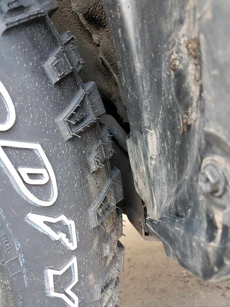

    But for what its worth, you want to run the most over rated tire out there. but anyways, 265 70 17, which will be the same as the 265 75 16 you mentioned, although many say it fits stock it doesn't. At least not with a 0 offset wheel. I have the 17inch version on a 0 offset wheel and I rubbed on my mud flaps. Now that was the only thing I rubbed on. so its easy to fix.
    The 275/70/16 you mentioned will likely rub on your cab mount
    This was my 265 70 17 duratrac at full lock. the mud flap rubbed
