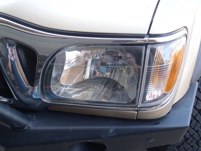

    I got a few more things taken care of on the truck yesterday...
    - Adjusted the parking brake. Brake now holds the truck on my steep driveway, but I still leave it parked in gear.

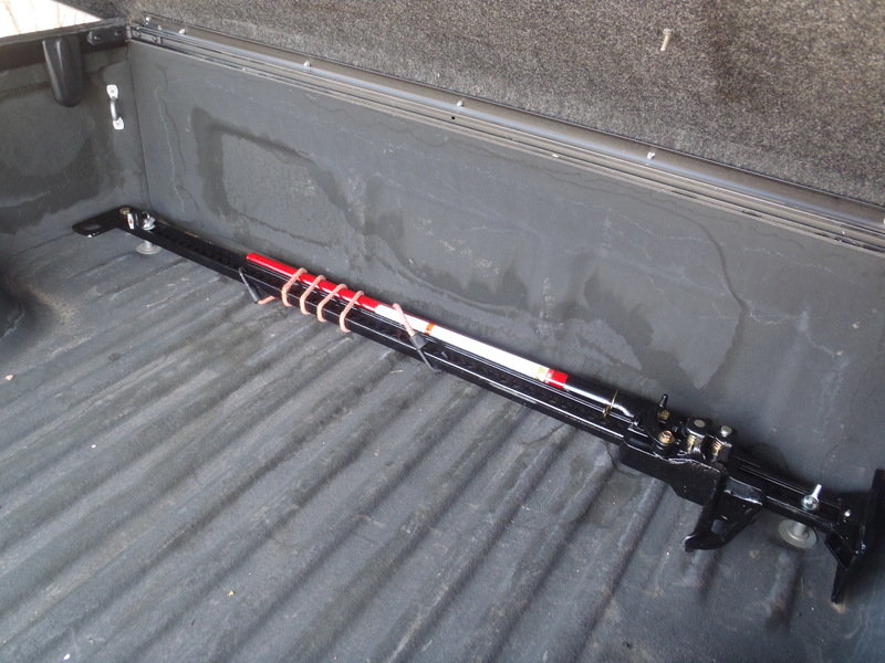

    - Replaced the Hi-Lift jack with a new 60" standard version.
    - Installed the new license plate (required de-pinning/re-pinning WeatherPack connectors for plate lighting)
    - Used a sledge to bend the ends of the spare tire support brackets to better center the larger spare under the bed.
    - Installed a cable lock on the spare tire, both for security and to add redundancy for keeping the spare in place should the factory winch cable fail.
    - Evened out the front trim job, which required more cutting on the P/S.

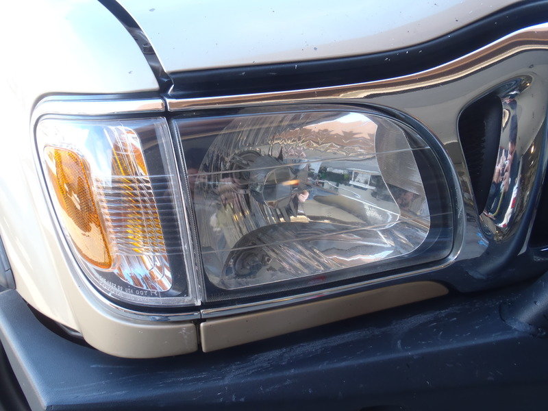

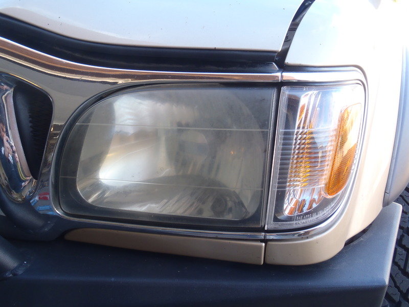

    - Restored the headlight lenses, both were in rough shape.
    I didn't take pics of most of that, but for the record here's a before and after on the headlights:
    after...
    And the passenger side after refinishing... this side was in worse shape to start....

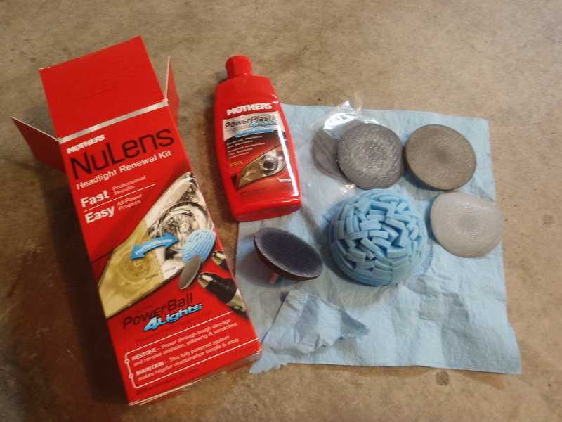

    The product I used was MothersNu Lens. For $27, it included a drill attachment and sanding discs that attach with Velcro. You start with 800 grit, go to 1500, then 3000, and finish up with the polish using the foam powerball. The passenger side headlight took about an hour because it was half covered in some kind of clear coating that had been applied to prevent yellowing (didn't work). The coating was peeling and flaking and looked like crap. The driver side took about 20 minutes after having practiced on the P/S.
    Hopefully the refinish lasts at least a year. Coming from 3rd gen 4Runners, I'm not used to having plastic headlights that dull over time. My 'Runners all have glass lenses. The Mothers kit has enough supplies for a second round, so I should be good to go when the time comes.
    And just for the hell of it, something you guys have never seen before... a Hi-Lift jack!
