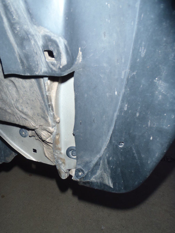

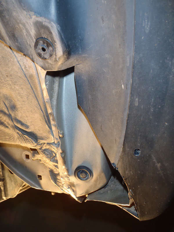

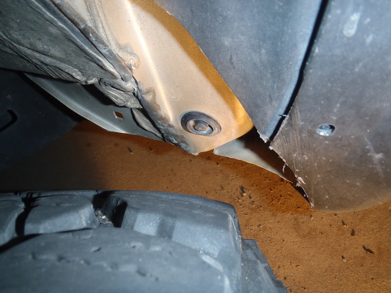

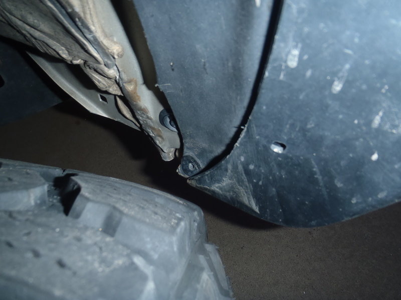

    I started making some room for the F5s today. For now, I made just enough room that I can drive it around town and do some mild wheeling, but more will have to come off before I can really stuff the front tire.
    Before.. pinch weld flattened, fender liner trimmed, note rub marks on flare.
    After... pinch weld flattened further, additional liner trimming, liner stay replaced, flare trimmed, fender trimmed, bottom corner of pinch weld removed and ground smooth.
    Tire turned to illustrate point of heaviest contact...
    Before...
    After...
