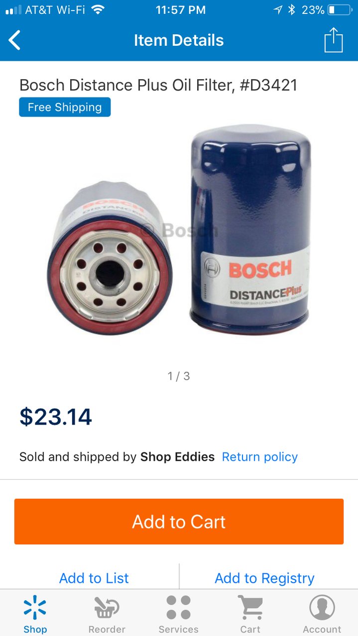

    996BFA82-FBB8-466E-9054-4854092140B1.jpg I’ve been all through this site looking at oil filter posts. It appears that OEM Toyota filters are longer than most aftermarket filters. I have seen people using all the way up to a PH8A Fram filter, which is huge compared to stock. My question is, does size matter? I came across a great deal on some filters that are the same diameter, but nearly double the length. Will they work on our 4.0 engines?
    I can get them for $3 each.

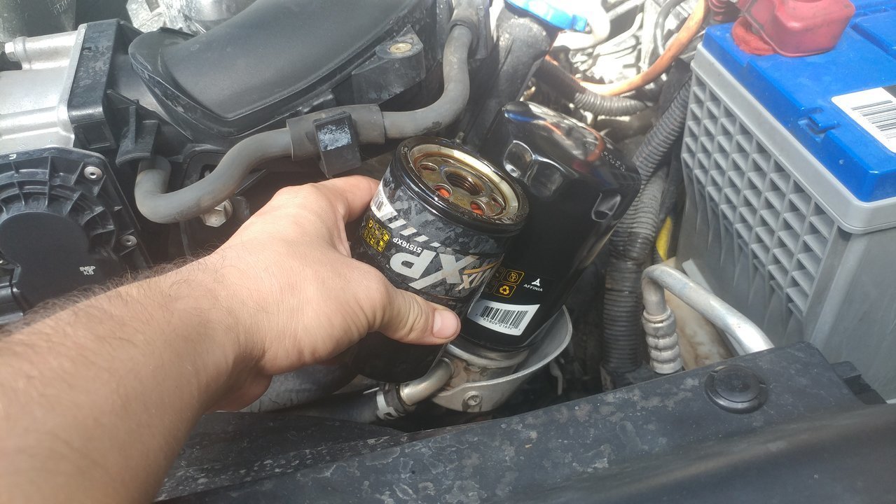

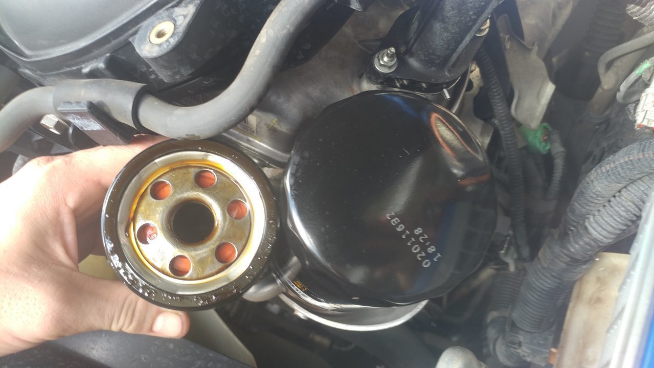

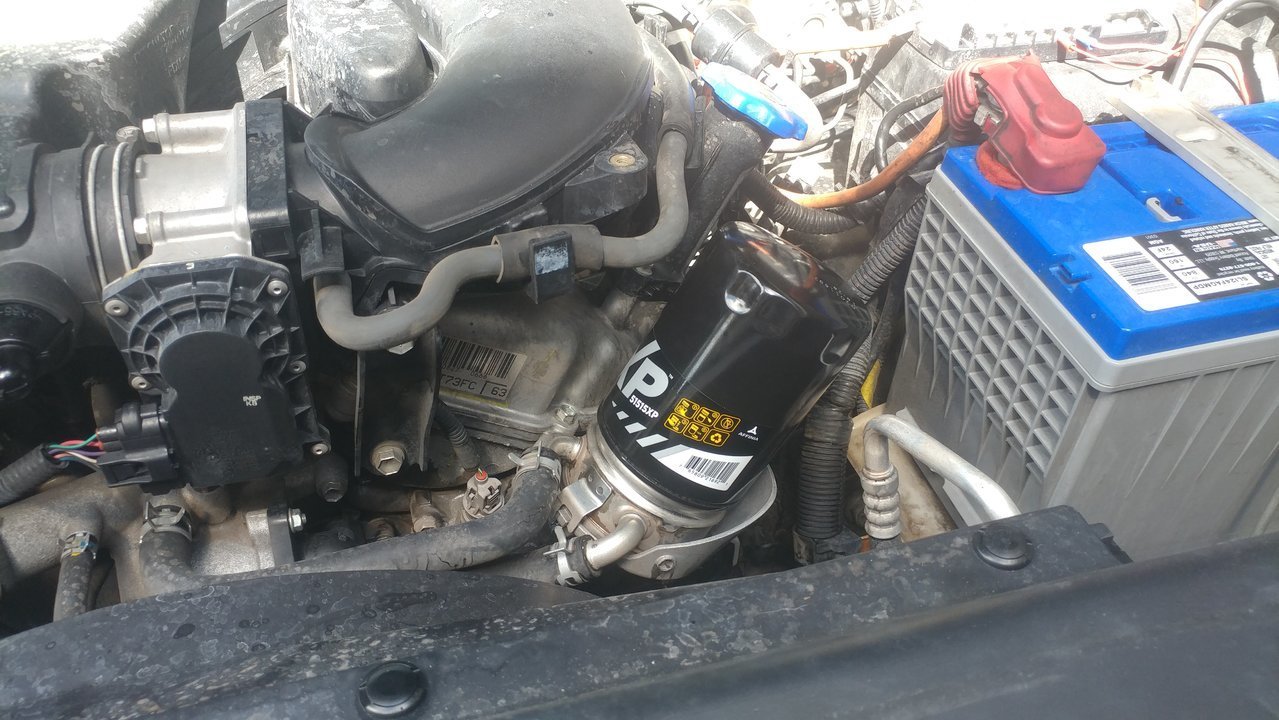

    The filter I run is a 51515xp wix, it is massive, I determined the volume by slowly pouring my 1 quart of MMO into and allowing it to permeate the filter pleats before pouring more in, after an hour of topping off it off and letting it sit for 20mins I finally determined it was "full" it used just a hair shy of a full 3/4 a quart of the MMO.
    I don't expect everyone to agree with me but like you said it's my truck and it makes me feel better if nothing else so I keep doing it. I say do what makes you feel happy on your truck. :thumbsup:
    Not trying to saw anyone or be a deeck just sharing my experience opinion and thoughts on the matter.
    I mean seriously it's huge... :eek:
    Applications include 60-70's Ford F100 V8's and the FJZ80 Land Cruiser. :D
    It was the biggest filter I could find at my LAS that still had the right size O ring and 3/4 16 thread.

    Simple math given the rough dimensions of external case of the filter being 4" diameter and 5.5" tall gives an internal volume of roughly 70"^3 or 1.212 quarts (thank you google) subtract the thickness of the cylinder walls and the space occupied by the spring anti-drainback valve and filter media itself and you get a rough 3/4 quarts of void left over to be filled.
