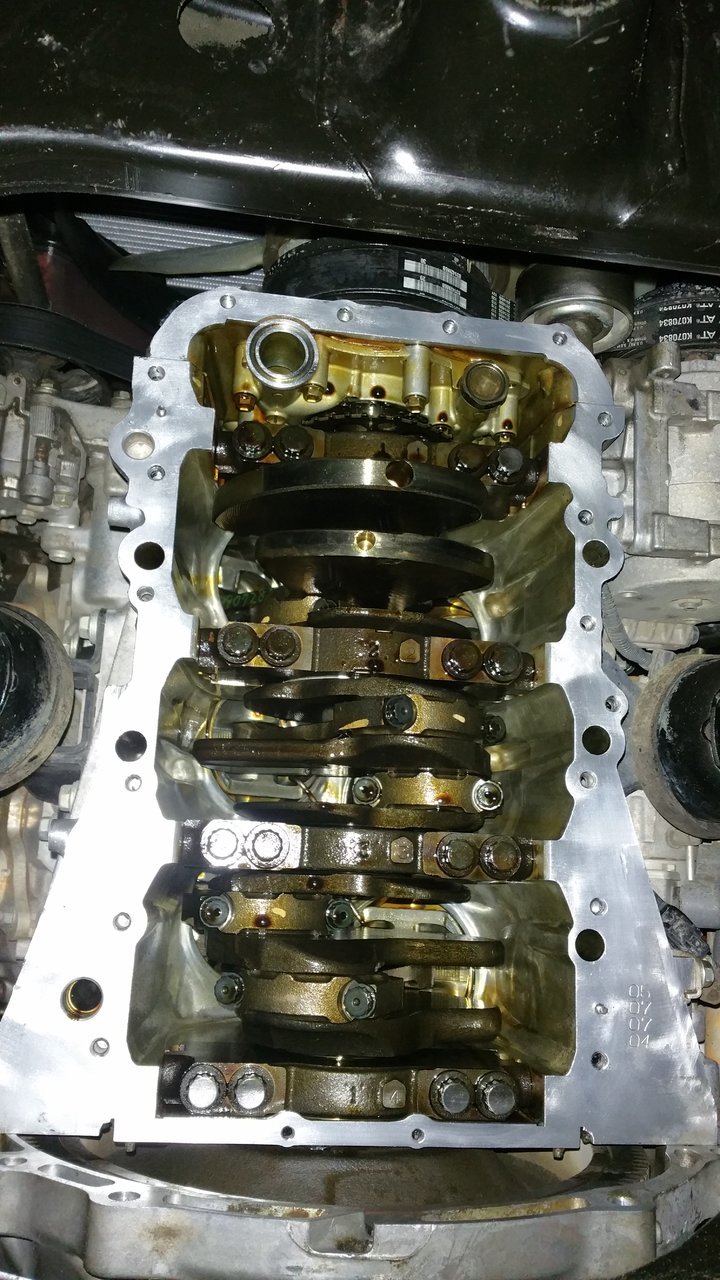

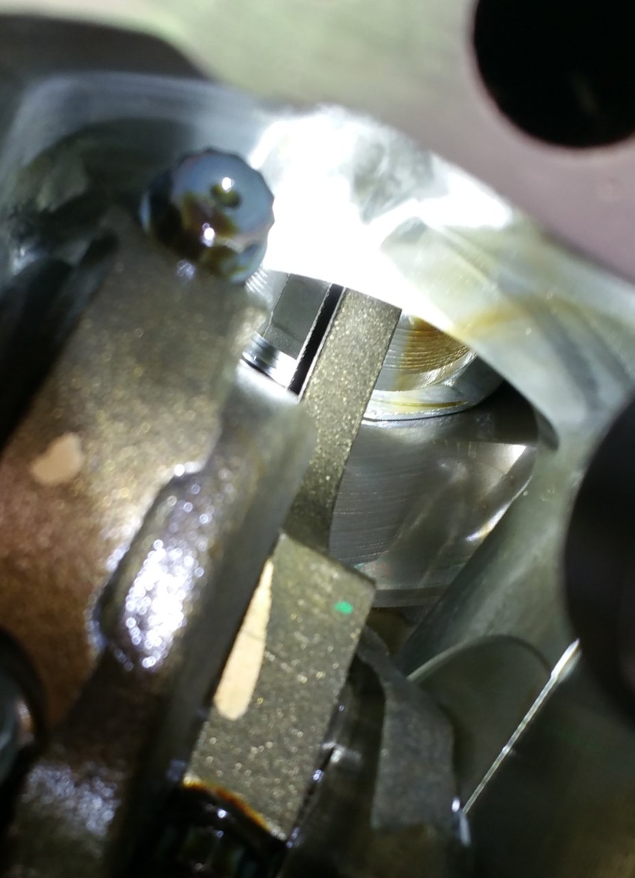

    For what it's worth been running this setup and two different trucks and recently I had to reseal my oil pan on my 2010 (hitting 200k was starting to weep below the front crank pully not the crank seal.) And I could still see the from factory crosshatching from cylinder honeing, I'd say that's doing pretty well for protection.
    For 200k boy that's purdy.
    Anyway I started doing this after driving my budy's 04 Tundra 600k+ miles still runs like a top, he uses the larger 51516 filter and recommend the 51515 for me since it fits so nice. He's been an ASE and Toyota Mastertech for over 35yrs if nothing else he knows what he's talking a out through pure experience.
