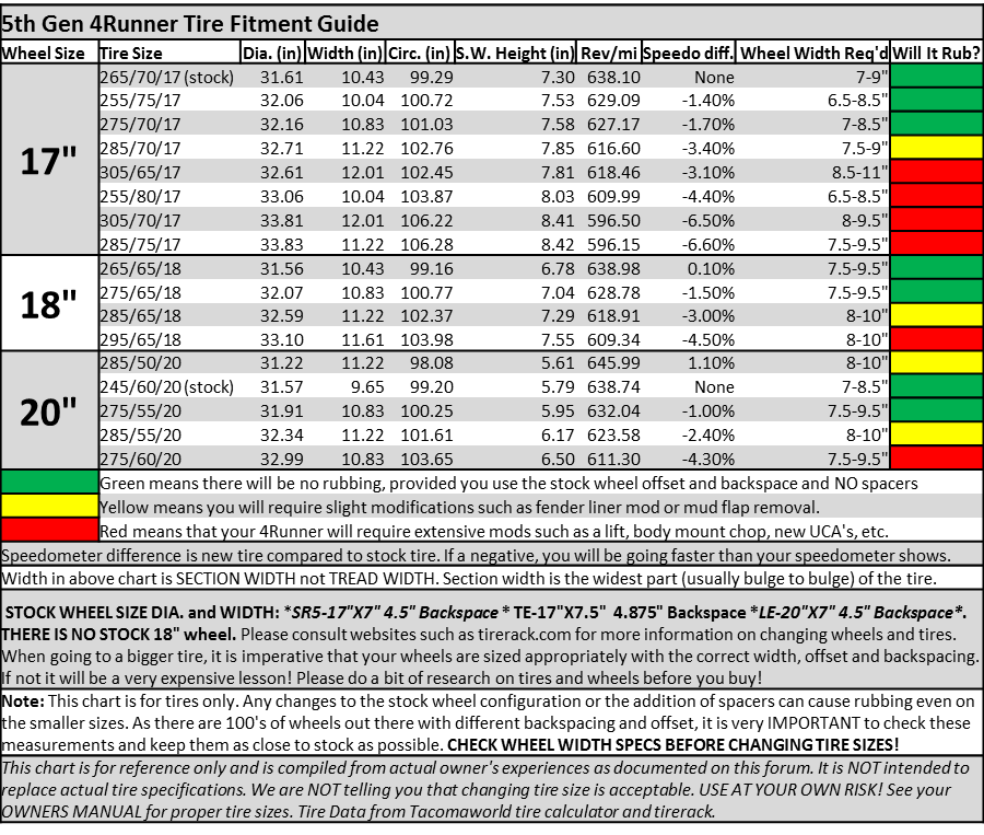

    Has anyone ran a larger than stock (265/70/17) on a stock 2018 4runner on stock wheels?

    Wondering this as well. Thinking about putting on some 275/70/17.

    I found a chart on another 4runner forum that says 275/70/17 will work on stock vehicle

    Thanks! I think I found the same write up. I'm sure it would apply to the Tacoma too right?
