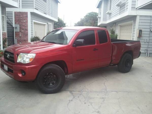

    heres a pic of mine ... but my wheels are 15's

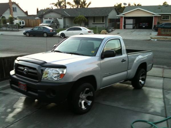

    Nice doesn't look bad at all...here's mine i really want new rims and tires, the ones in the pic came with the taco when i bought it a few months back

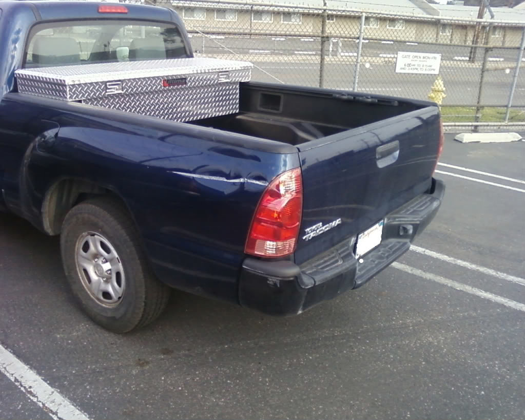

    Photo0313_a2223af872e5dc084739ab38d234aa561066b95e.jpghere's one I have where you can see the back tire...
    I'll take a good photo soon.
