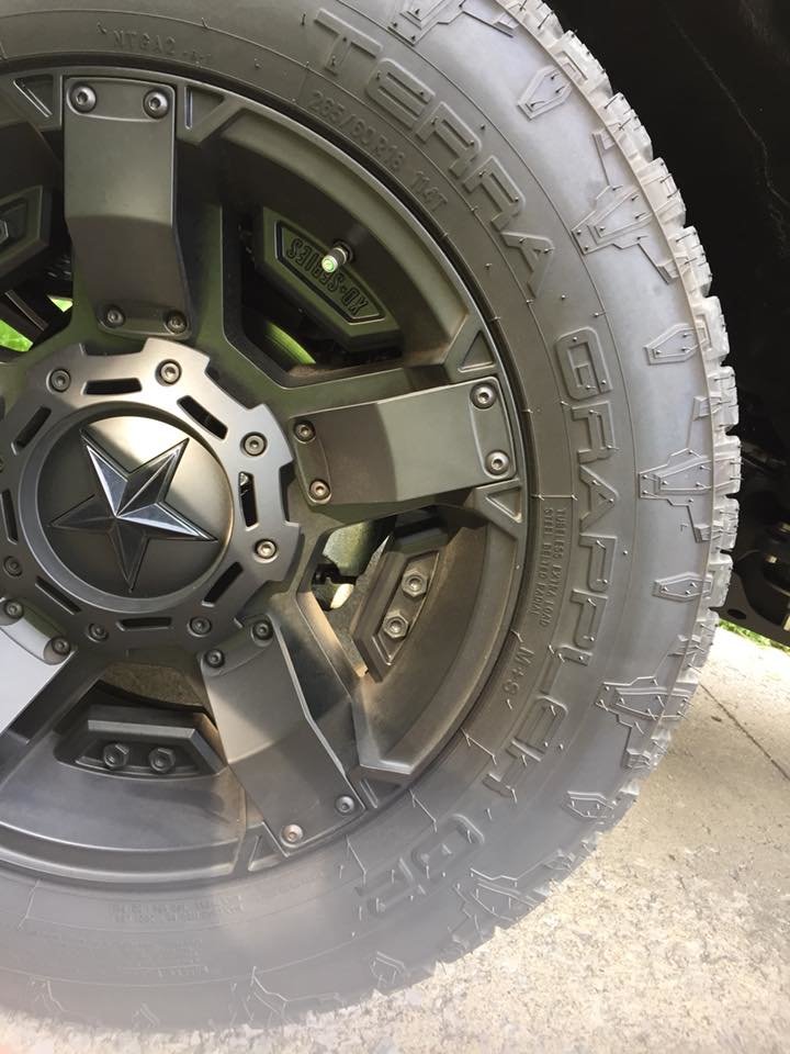

    these KMC Wheels XD 811 RS2 18 x 9 are set up to run on 5-lug with about 2" of lift.
    I am looking to downsize

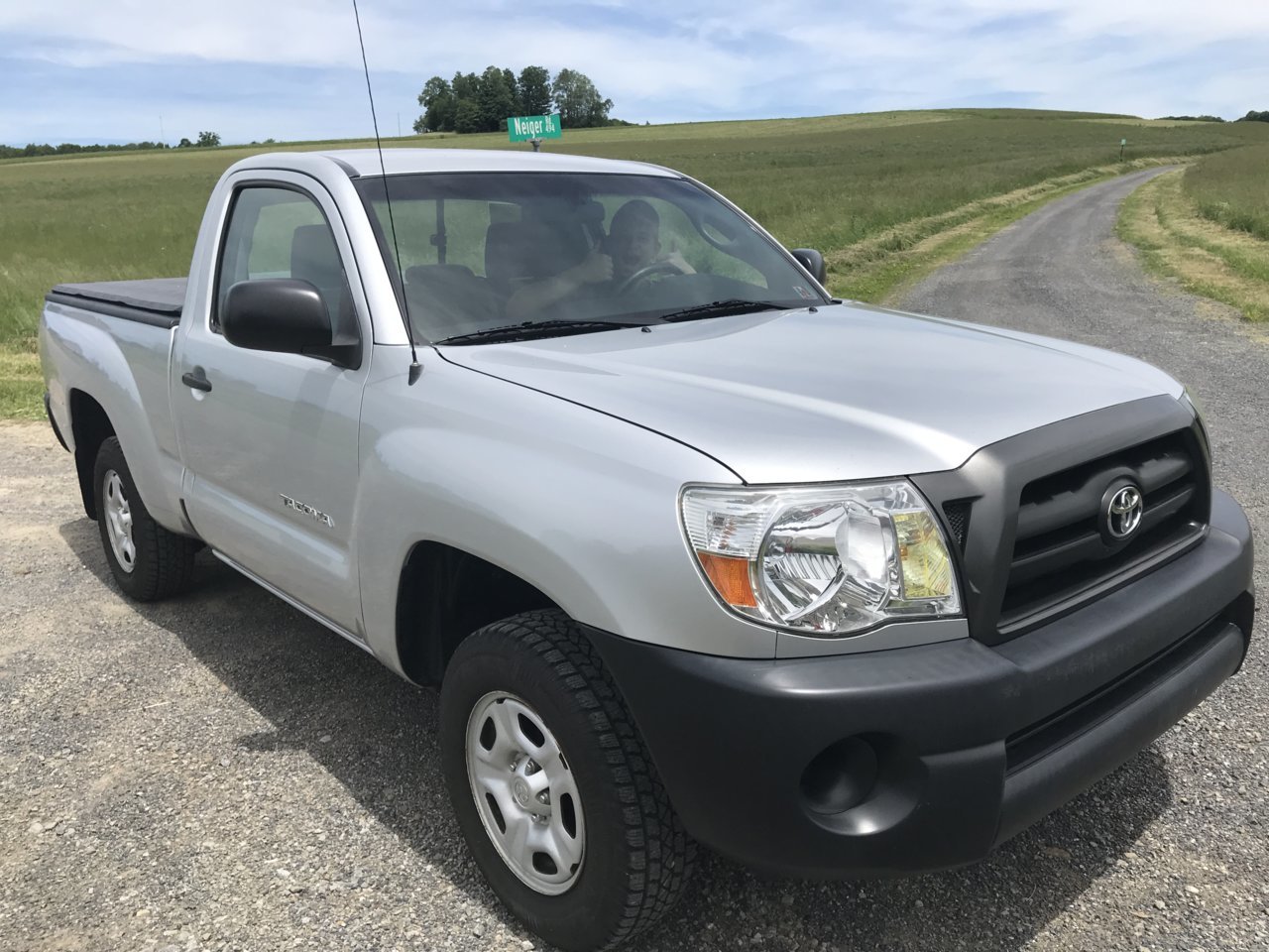

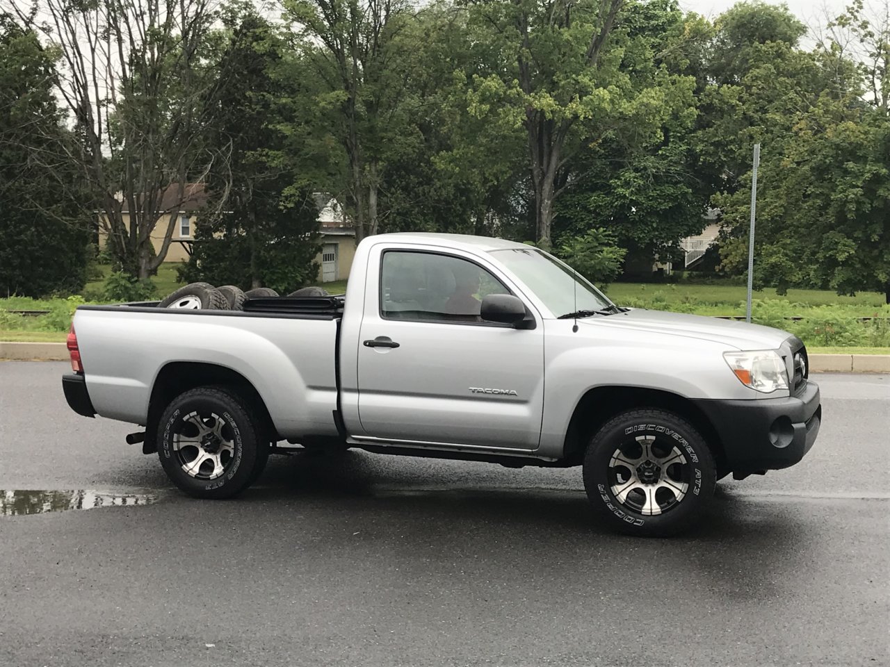

    Thanks for all the help on this thread. We just updated my son's 2007 2wd Taco with 16 inch Dick Cepek Wheels and 235 70 16R Cooper Tires. Wider stance without adding a lift. This is the largest setup we could put under the taco without any other modifications. The wheels have great backspacing so no spacers were used as they cleared the calipers but we did have to get a spline lug kit due to the spacing of the openings on the rims for the lugs.
    Any other recommendations to make his Taco look better would be appreciated. Here are the after and before photos of the Taco.
