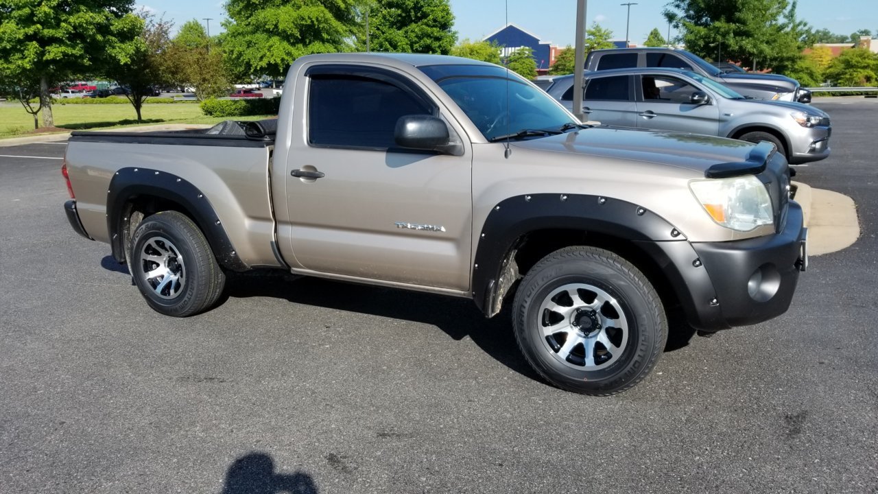

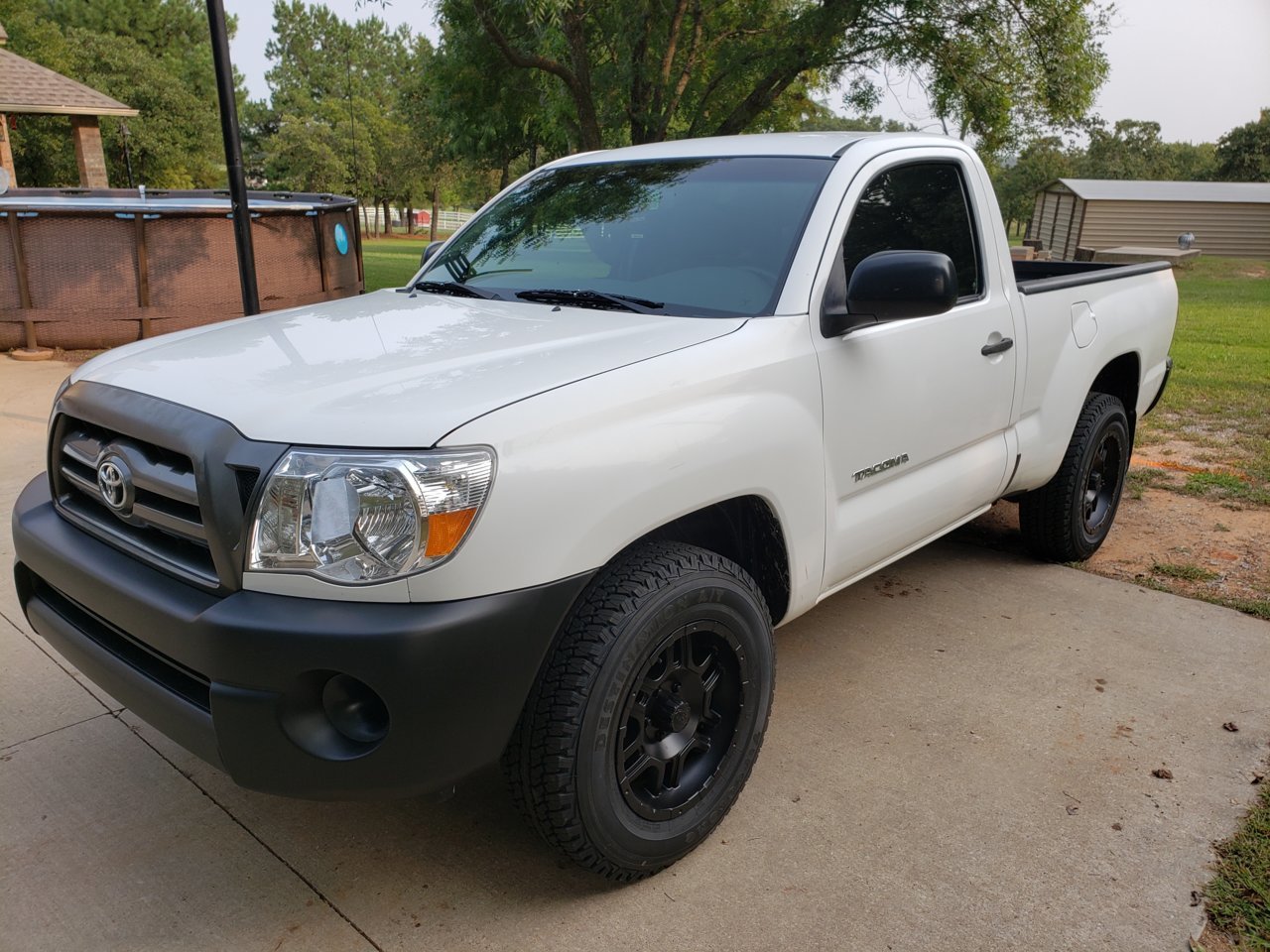

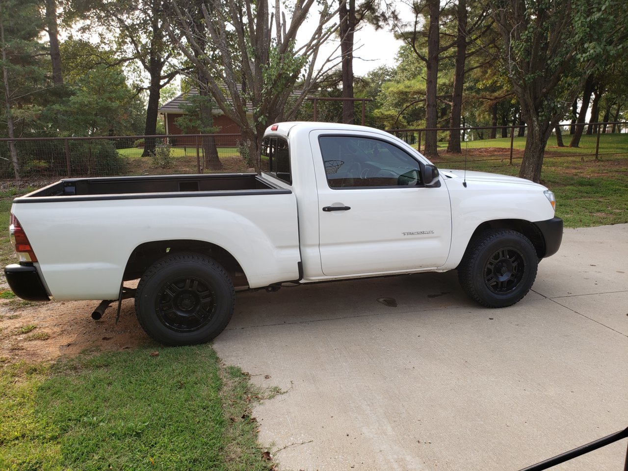

    Tires phantom ap 235/70r15 wheels mb legacy 15x8, -19 offset . No mods done rides and responds better than the stock wheels which were 215/70r16

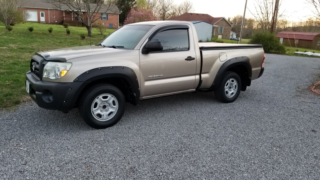

    20200918_165745.jpg 20200918_165804.jpg 20200918_165734.jpg 20200918_165836.jpg 235/70-16 on 16x8, +10 offset, completely stock, no suspension upgrades, haven't done a black box mod. No rubbing at all, even at full lock and hitting bumps.

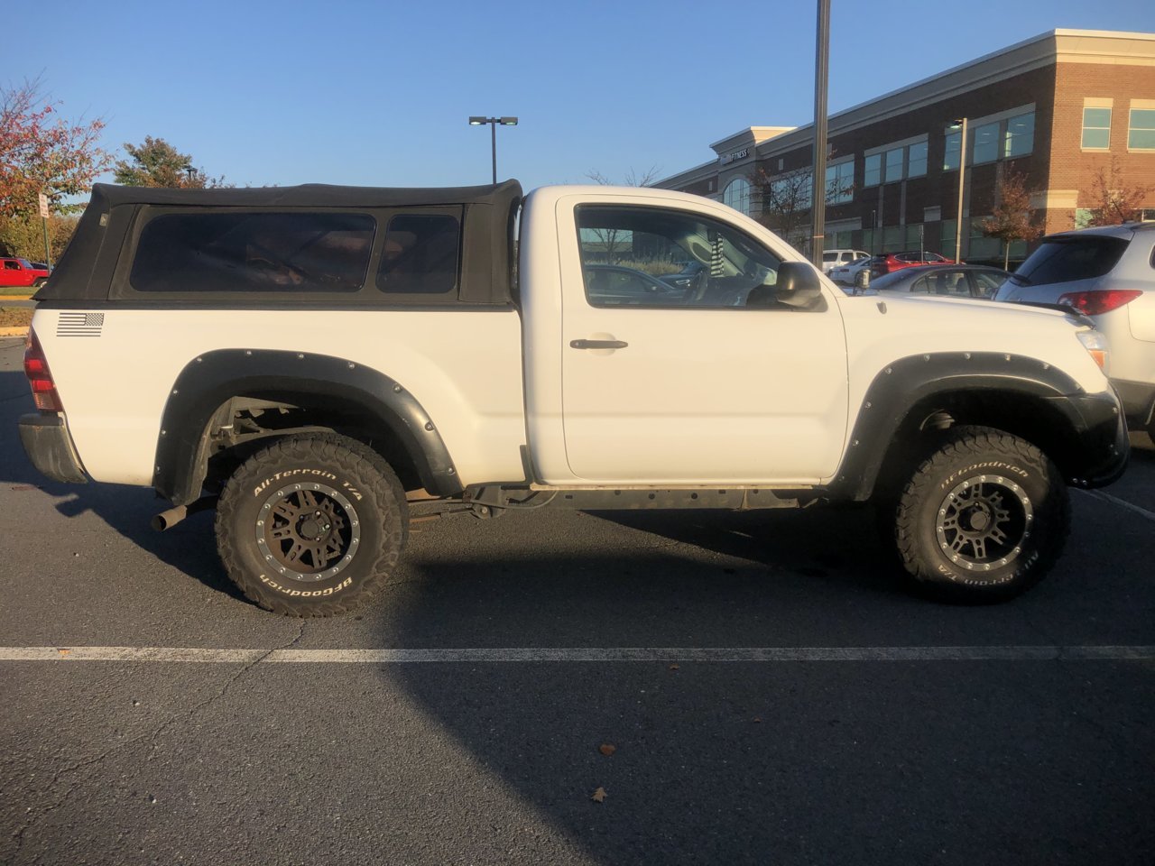

    After adding a 2.75 inch lift can 31x10.5r15

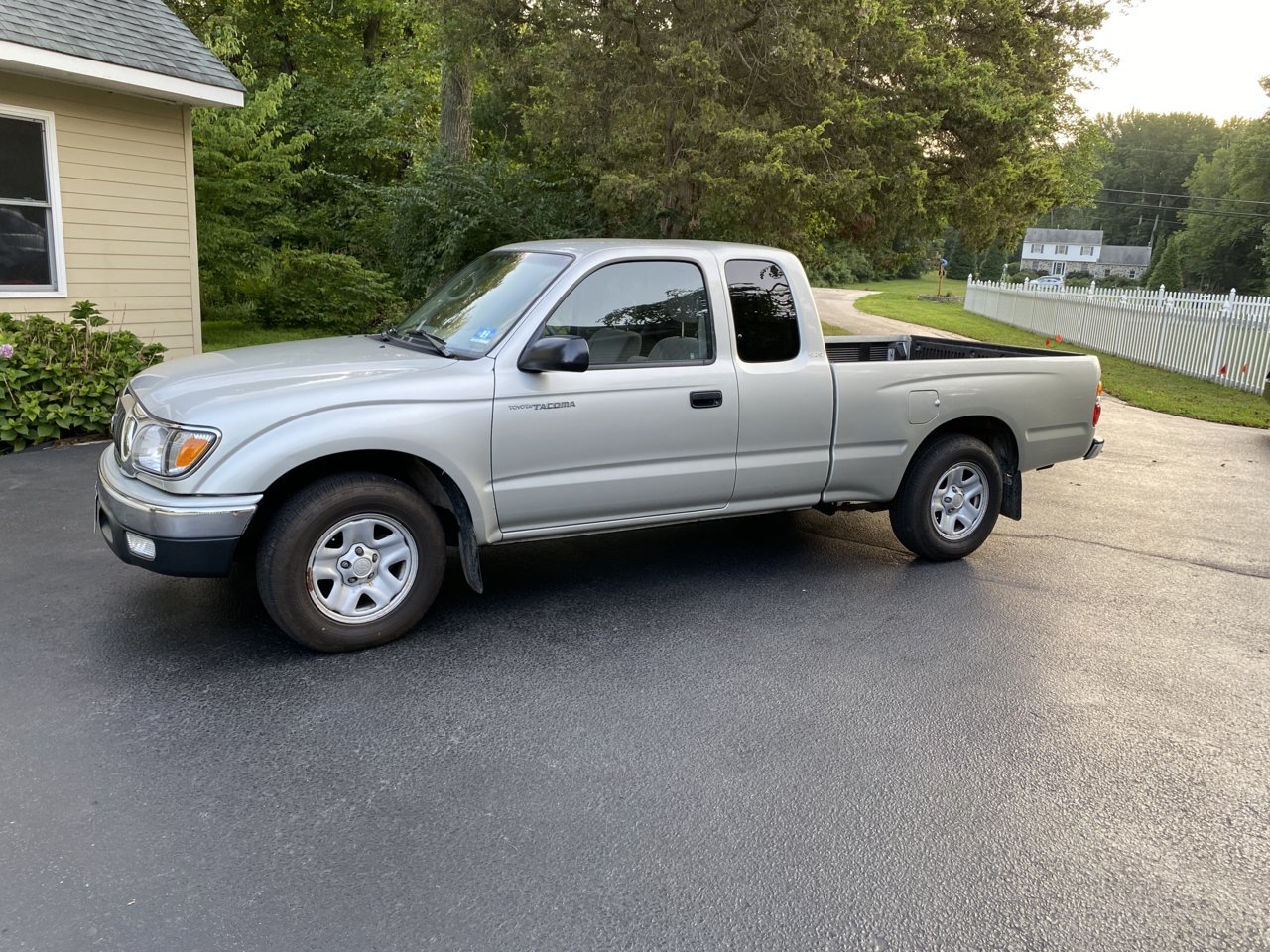

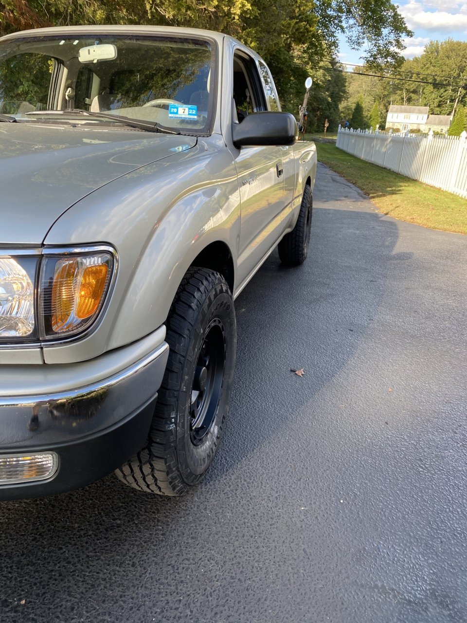

    Before and after pics on my 2002. With new shock too, it’s like a completely different truck.

    Definitely filled ur wheel wells out and looks great, prolly rides 10x better than the 205/215s. What shocks you go with? I'm looking at kybs on Amazon bc mine are clapped and I get a ton of body roll lol

    I went with the Billstein shocks. Not sure which made a bigger difference but it rides so much better.
