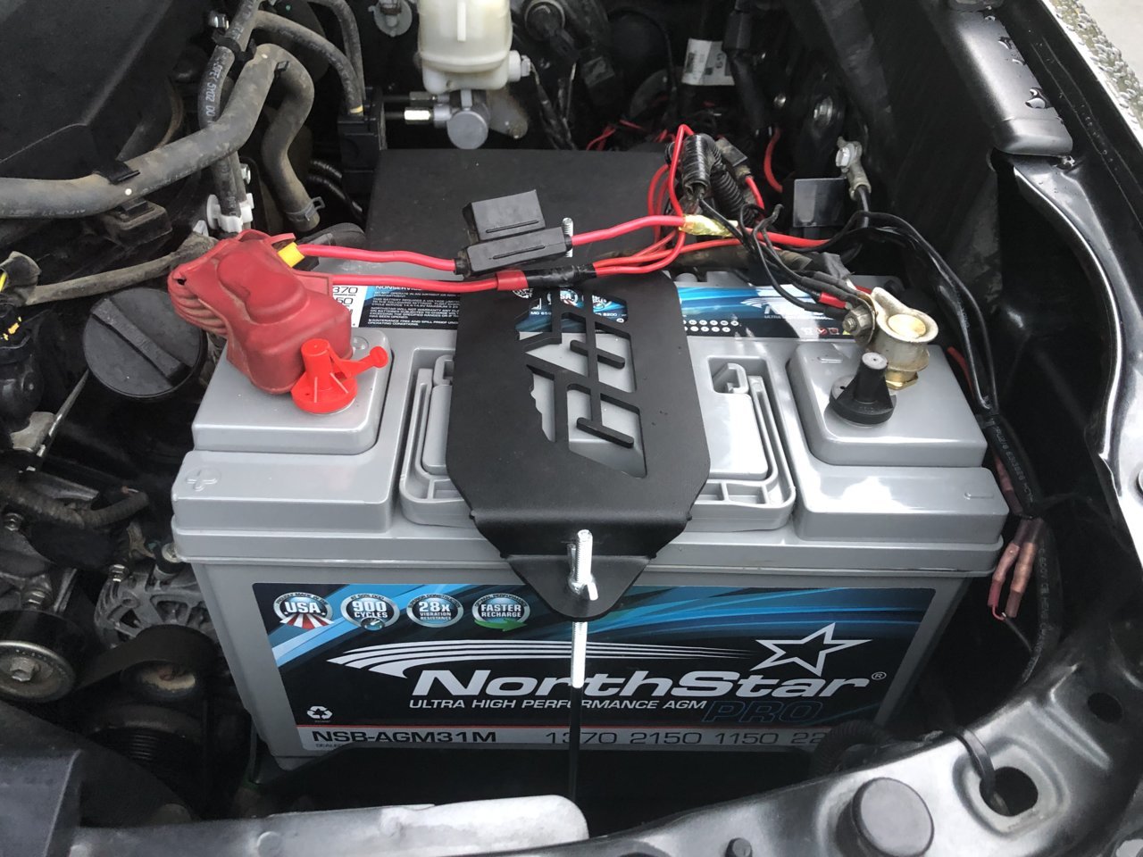

    I got the CBI tray and hold down. Northstar 31M battery. Not sure it’s the largest that will fit but it should do the trick...

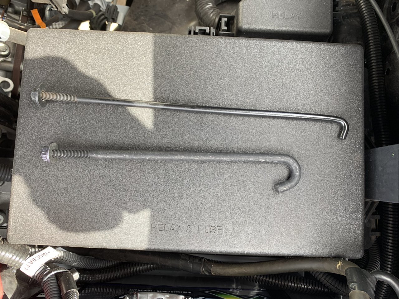

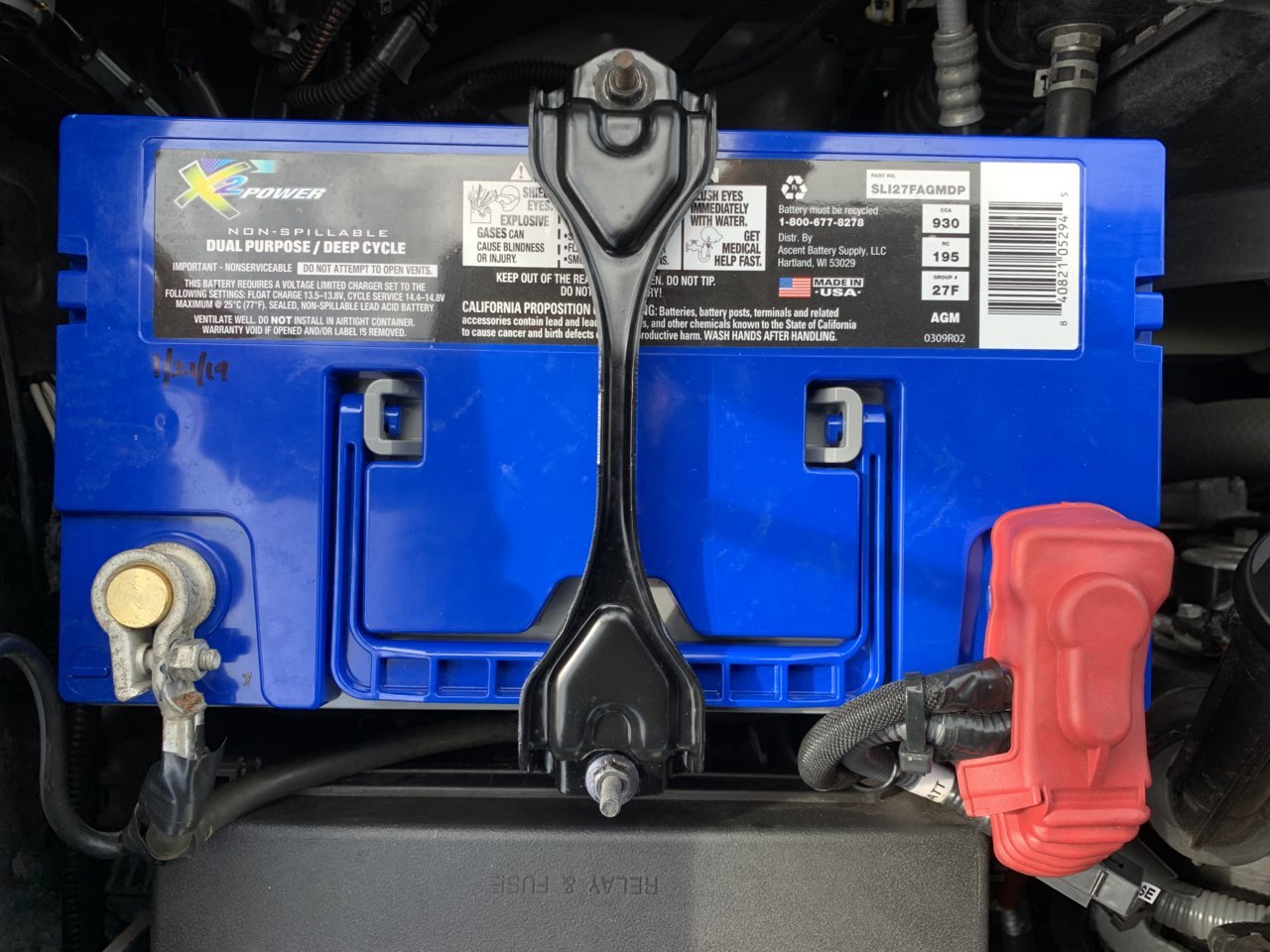

    I got my battery replaced just shy of the 3 years (35 months) under warranty. I also wanted to upgrade my battery in my truck so i pulled the new replacement from my truck, and installed it in my wifes NX (uses the same 24F battery) since we just missed replacing her battery under the 4 year warranty (50 months). I bought a X2 Power 27F AGM Battery from Batteries Plus with the 20% discount. I also needed to buy a larger battery tray and a longer j-bolt to replace the fixed one. I ground off the fixed j-bolt from the top bracket and painted it with rustoleum paint so i didnt have to buy a new one of that also. Battery cost $359.99-72.00=287.99+tax, battery tray 33.88 and j-bolt 5.24 plus shipping. I had a spare nut for the j-bolt since i had a spare and wasn’t included as a part of the j-bolt from the dealer. The battery tray is the same thin plastic as the orignal one, except larger. Not sure if its worth the $40 (including shipping) that it cost to replace it, but oh well.
