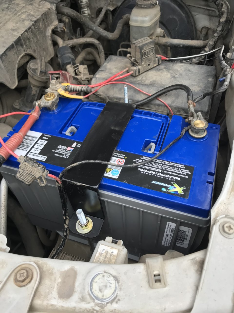

    For reference I’m a second gen.
    It fit just fine, but I built a beefier holder. 1/8” thick steel bar and 3/8” thick J hooks and nylock nuts.
    Excuse the shit wiring, I have a fuse block waiting for install.

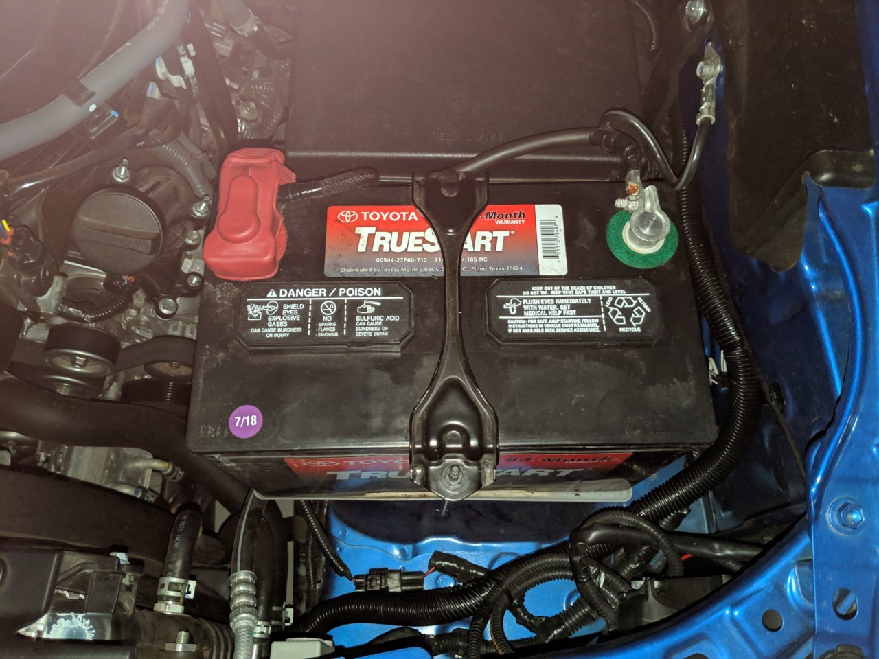

    27F fits stock tray, and it’s lighter than a 31M. I have a 27F sitting in my garage and a brand new OEM battery in my truck since it died just before the warranty ran out.

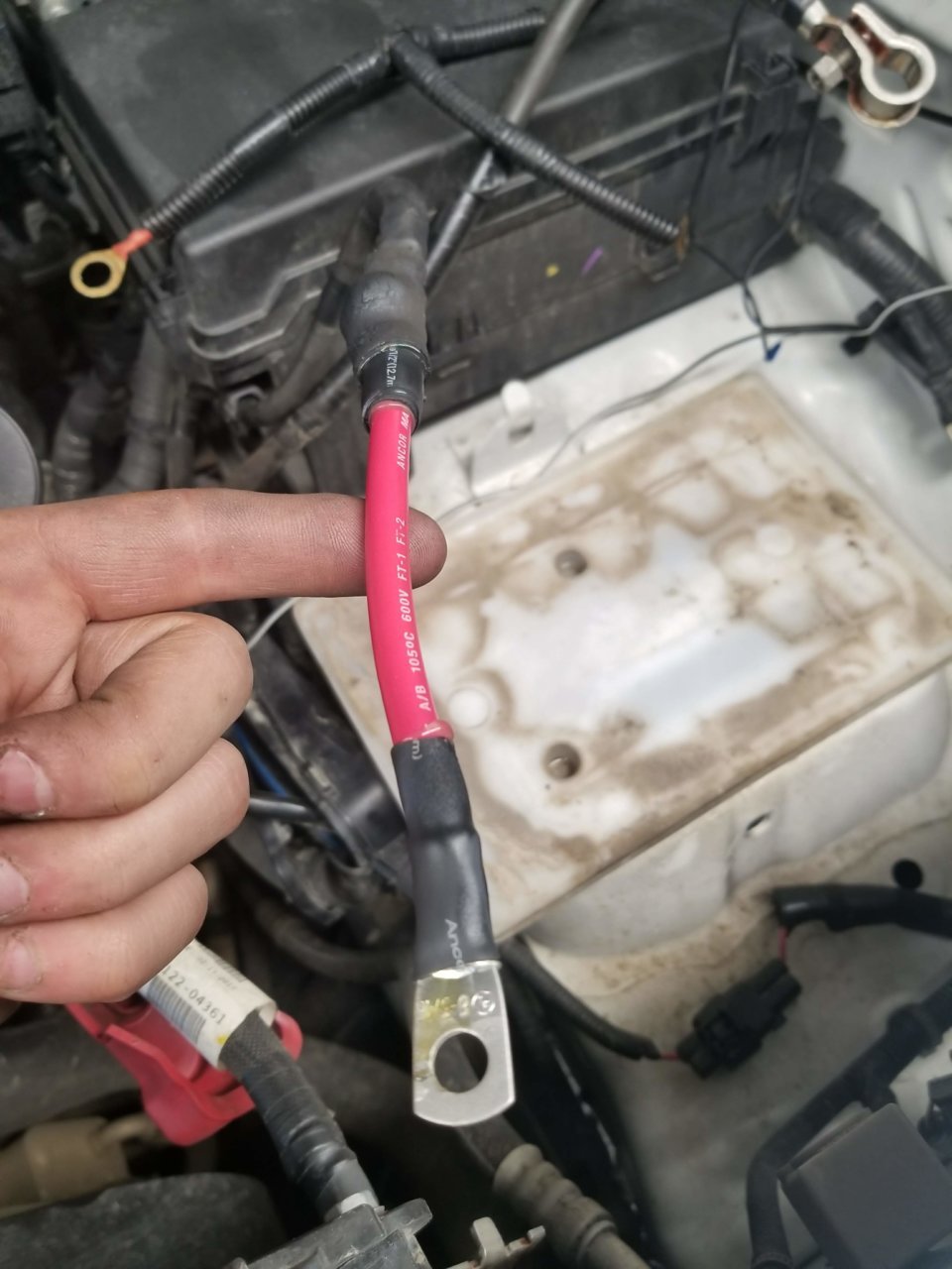

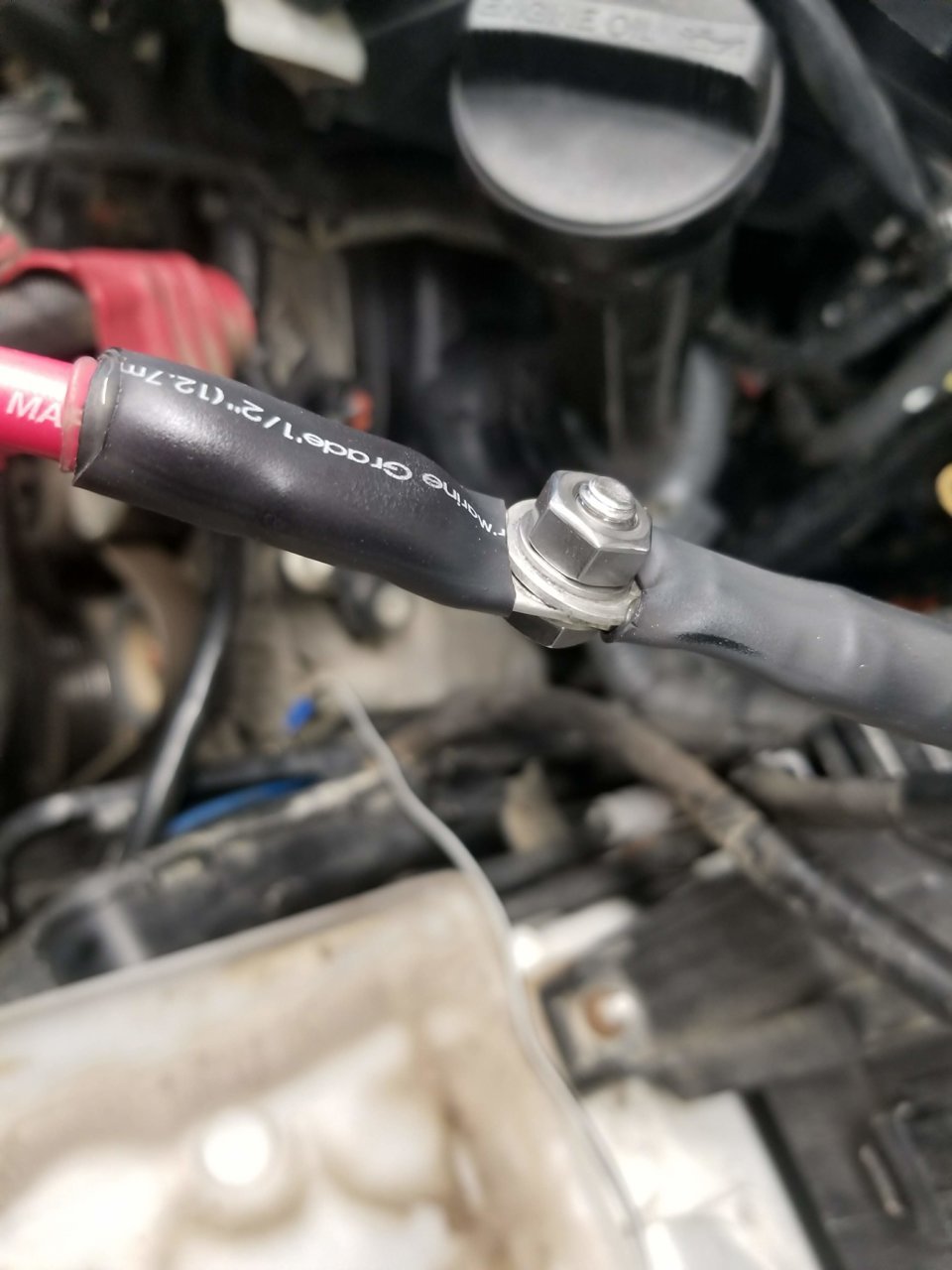

    Not telling you what do but you might want to insulate that splice...
    Edit...Oh nvmd. Looks like that’s a red extension for the neg.

    3 layers of marine grade heat shrink with silicone.

    Warranty replacement. Threaten to call corporate. It’s covered by the 3/36. It blows me away dealers try to get out of replacing this garbage battery.
    Of course, still get a new one on discount if you can! That’s why I got my Northstar 27F.. the ‘True Start’ or whatever it is will just fail again. It already cranks slow here when the wind blows right.
