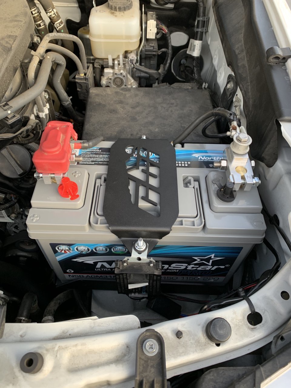

    Whole bunch of stuff in my garage
    This is what I got. I got the CBI tray for $90 and the Northstar Group31 through the group by for $350-ish. I also added the SDHQ Battery Terminals.
    mcharfauros, BOMBS and sdsurfer like this.

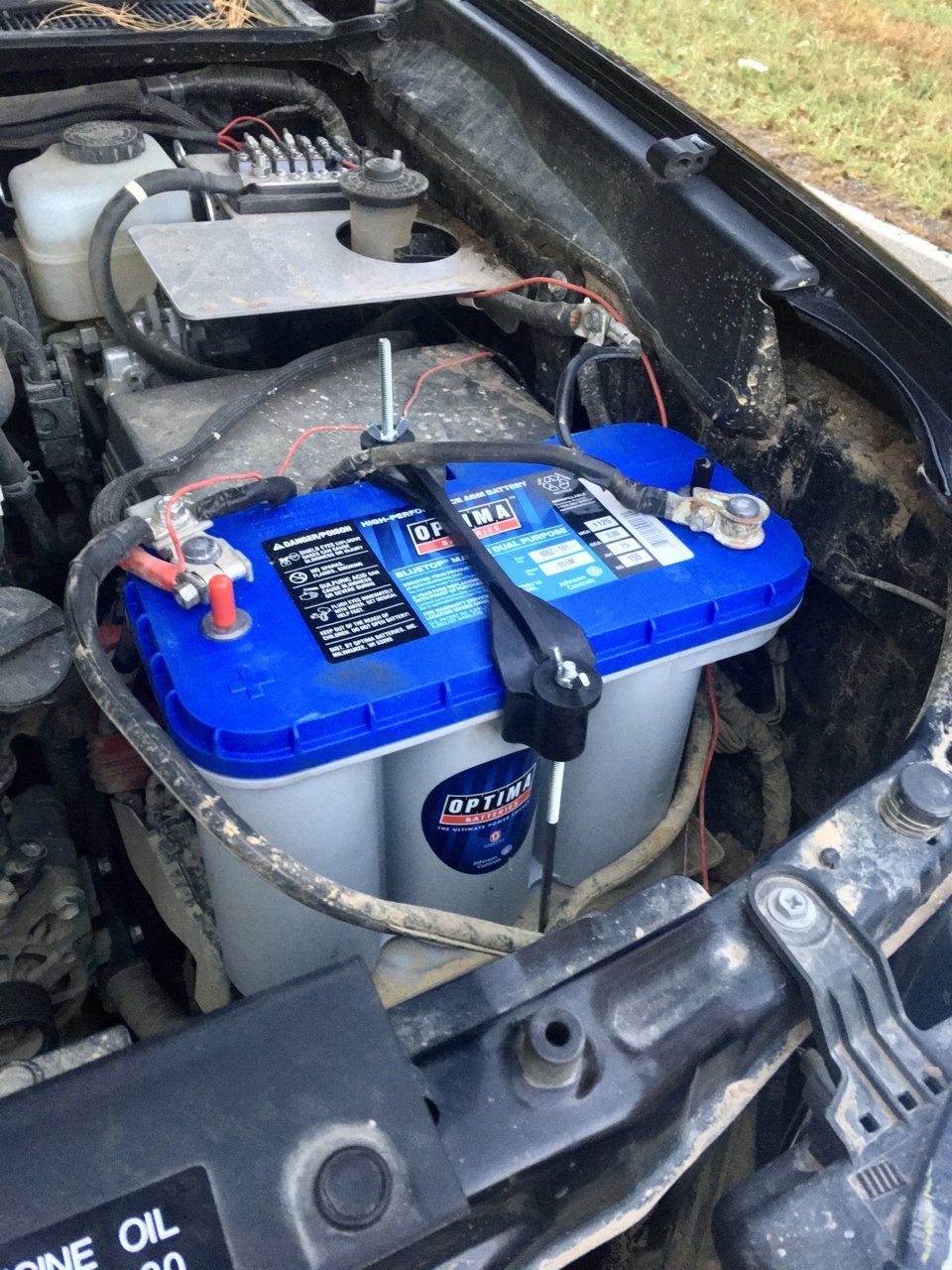

    Put an Optima 31M in last weekend. Janky tie-down from Oreilly’s on the OEM 24F tray. Still gotta sort it out, and trim the all-tread.
