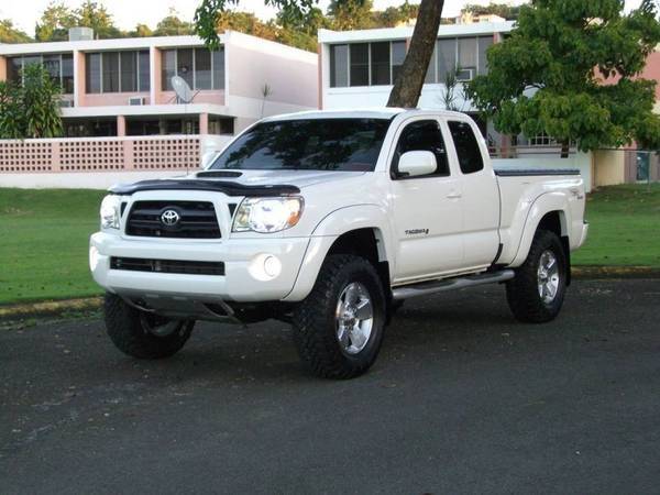

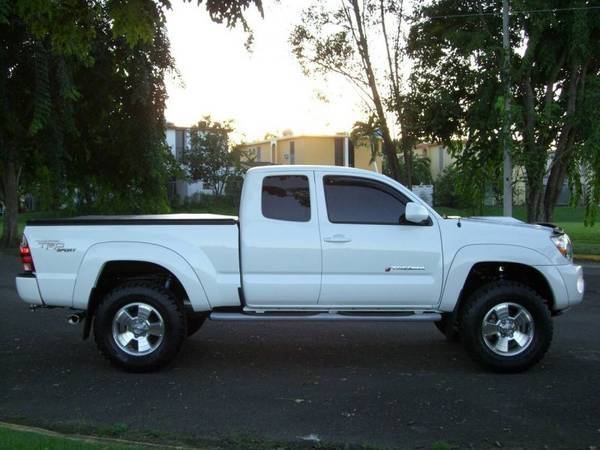

    3"ez-lift kit , 1" spacer , stock wheels 17" , 285/70-17
    well i have a 2007 acc cab sport with 3" lift kit and 285/70-17 with original rims and no problems yet , also i had to buy a 1" spacer for the front it cost me $182.00 . i bougt it from ez-lift . extremetrucktoys.com
    yes i have spacers of 1" and i have 285/70-17 cooper tires

  11. Dec 27, 2007 at 12:53 PM
    hans17
    hans17 Well-Known Member
    Dec 16, 2007
    #3860
    99
    san juan puerto rico
    tacoma xtra cab v6 sport 2007

  13. Dec 27, 2007 at 1:50 PM
    08Tacoma
    08Tacoma Well-Known Member
    Dec 13, 2007
    #3824
    91
    Arizona
    2008 Tacoma, DblCab, 4x4, TrdSport, BlackSandPearl, 2.5" Toytec, TubeSteps, WindowTinting
    That looks great!!
    Congratulations sir!!!
