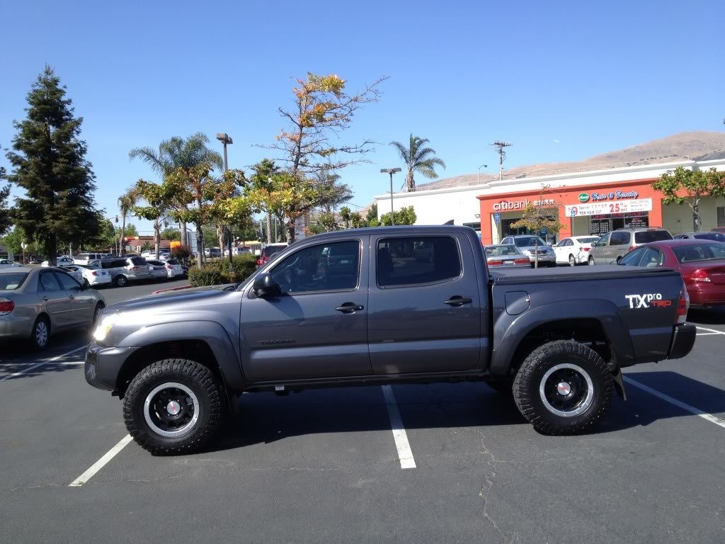

    I have a Baja on 285's...But I took off my fenders until I find some time to trim up my fenders. Like everyone said if you search there are a ton of threads on what people needed to do to clear 285's. My suggestion is go with a 265/75/16 or 265/70/17 with an aggressive look. I wasn't a huge fan until I bought them but I love my Duratracs.
    Here is a guy that has the baja suspension with 265/75/16's and they look pretty good.

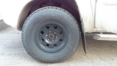

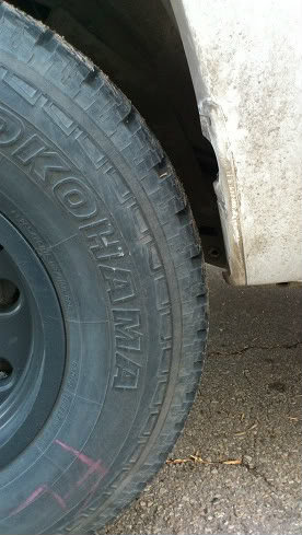

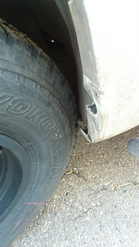

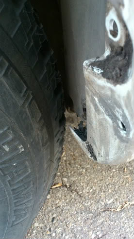

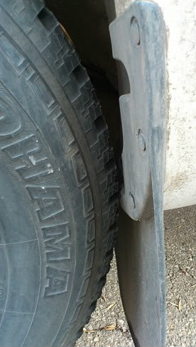

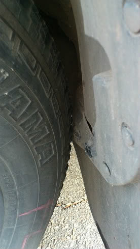

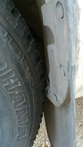

    This is my experience, pretty close scenario to what you have.
    My 265/75/16 Yokohama Geolandar A/T-S tires are 31.9" according to the Yokohama website. Some 265/75/16 may have smaller thread depth etc and end up being 31.8" or so. It depends on the particular tire.
    Here are some pics from my truck. These pics are with AR wheels, above mentioned tires and OEM front mudflaps. Front OEM mudflaps were still rubbing. You can see from the pictures, they have a buldge covering the inner part fo the fender flare where the rub marks are. I had to remove front mudflaps and bent the inner portion of the fender flare inward to avoid rubbing. You can try buying a set of front & rear (or front only) mudflaps from Husky. Husky mudflaps have a smaller buldge and that may be enough to avoid your tires to rub. I did buy Husky mudflaps, but it was not enough in my case. Since then I don't have front mudflaps installed, and I put on Husky's on the rear.
    Here is a link for Husky flaps:
    http://www.tacomaworld.com/forum/group-buys/188426-husky-liner-mud-guards-29-95-shipped-2.html#post4086920
    Here are the promised pictures with AR wheels, 265/75/16 tires and OEM mudflaps up front (Stock TRD Sport suspension, no lift):
    So in short, it will fit, just be prepared (based on your wheels specs) to most likely deal with tires rubbing on front mudflaps. Also trimming your mudflaps will only avoid scrapping on curbs, speed bumps rocks etc. OEM front flaps are ridiculously long.
