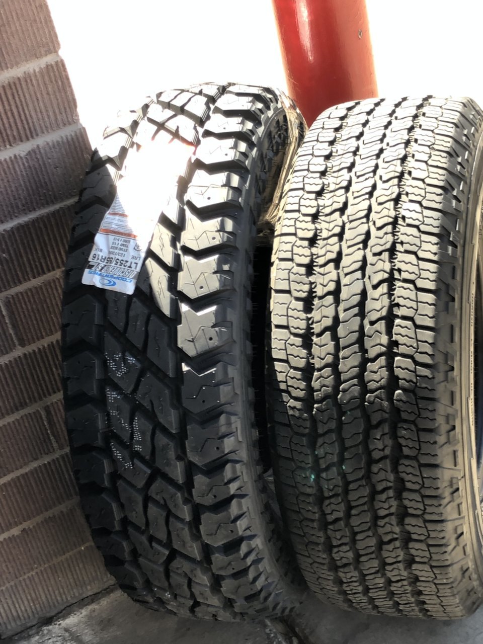

    DA2B03B7-DF42-4BFE-8B1A-9A0C70727A9D.jpg 255/85/16s (pizza cutter 33s) here on my stock pro suspension. Heavy off roading, 0 rub. More than I can say for my back bumper though.

    Would you happen to have a picture from the front or back of the profile of the tire? I'm looking to jump up to that size from the stock 265s.

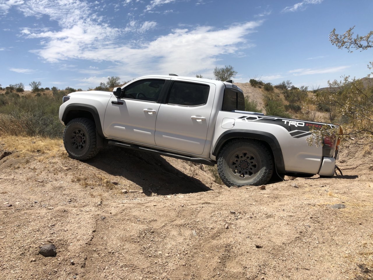

    040E4386-A44C-4595-8DA9-93CAA7F42ABA.jpg 0409401B-44E7-4CE3-A789-3265CFCAB7AD.jpg

    You're the man, thank you

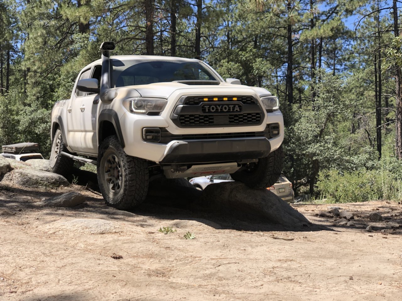

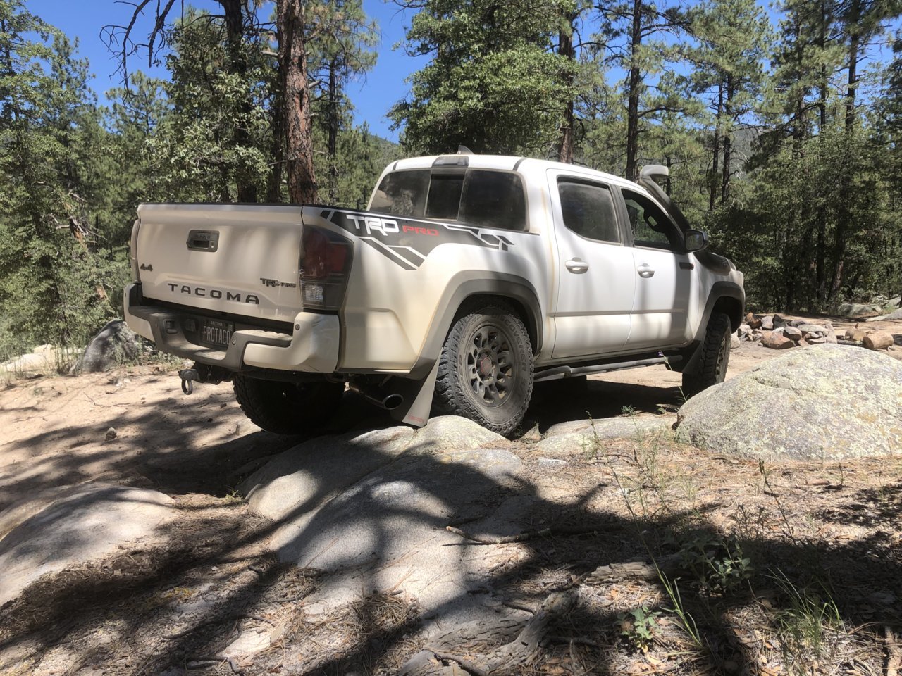

    255/85/16 Cooper ST Maxx fits with stock pro suspension and tires. No doubt about it.
    ACA7F931-2506-4002-BA42-25B38026DF2B.jpg 5AA85E54-3CF5-4D29-9E47-C0B8807143B7.jpg
