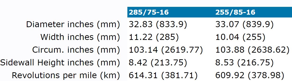

    I honestly don’t know Joe, I know the wheel formula is as follows:
    (Section Width X Aspect Ratio / 2540 x 2) + Wheel Diameter
    So (285 x 70 / 2540 x 2) + 17 = 32.7
    But
    (285 x 70 / 2540 x 2) + 16 =31.7
    so it may just be that they are running 16” wheels and not 17” that one inch may make all the difference.

    The folks running 16" wheels to include myself run a 285/75 vs the 285/70 of the 17" wheel.
    I'm glad you brought this up since this is often a topic of heated discussion and I have always been a skeptic of the "no rubbing" crowd

    so you are actually running a larger Diameter wheel although not much. Your set up is at 32.8. Did you do any modifications or lifts?

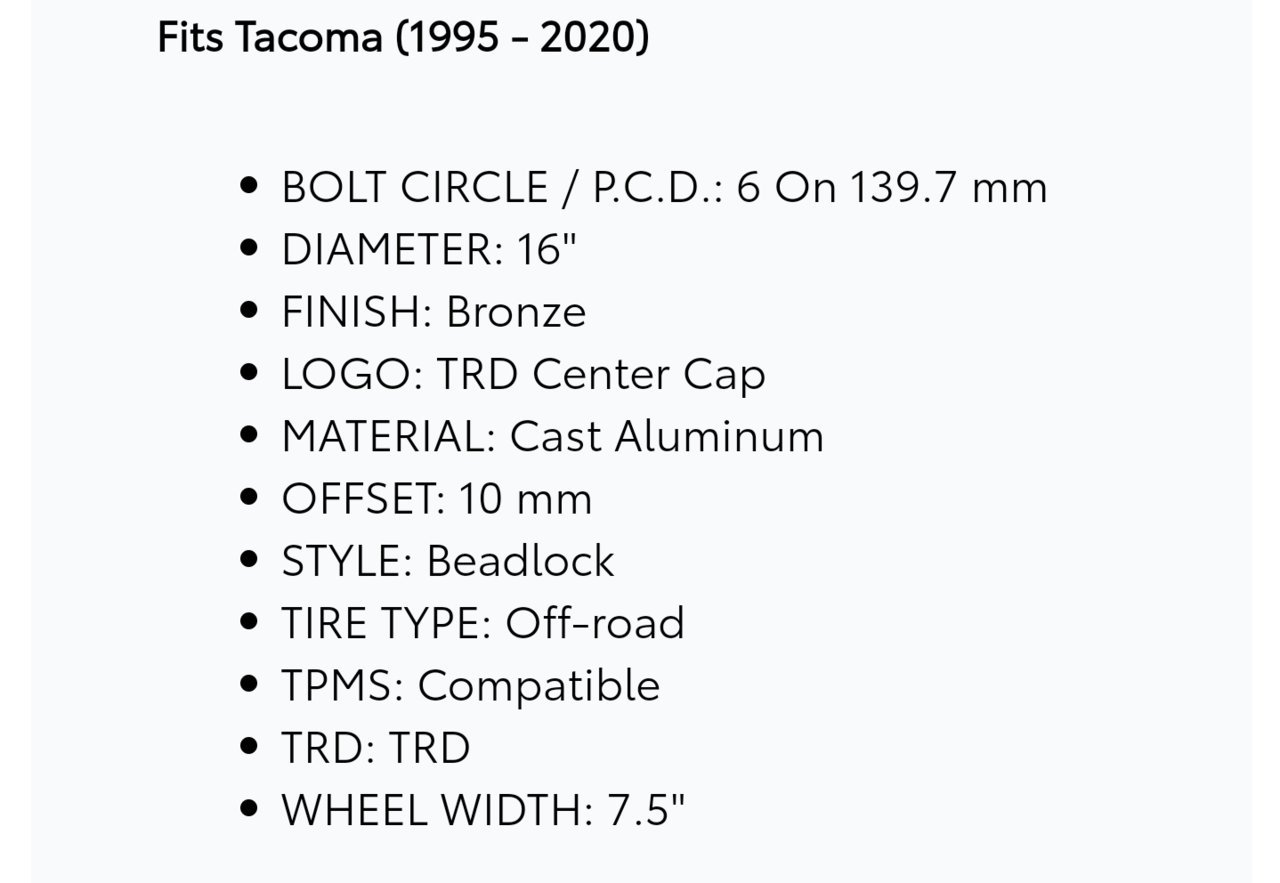

    They have a 4mm offset, not sure what offset my stock wheel has.
  15. Mar 5, 2020 at 3:14 AM
    #155
    Pete_Patter
    Pete_Patter Well-Known Member
    Jun 2, 2018
    #255226
    156
    2018 Calvary Blue Tacoma TRD Pro
    Tacoma Pro wheels have a 13mm offset so its not that much of a difference.

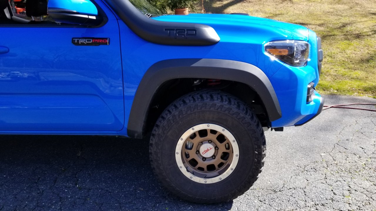

    2019 Trd Pro, Cooper S/T Maxx 255/85R16, Toyota 16" Bronze Beadlocks.
    I have stuffed them on various inclines around my property. Not at anything high speed. As I enter my driveway there is a stormwater flow line valley between the road and driveway. I hit this as hard and fast as possible and still no rub! I guess I'm one of the lucky ones. I may even try to put the mud flaps back on.
    Thanks to everyone for the information, and courage to try it.

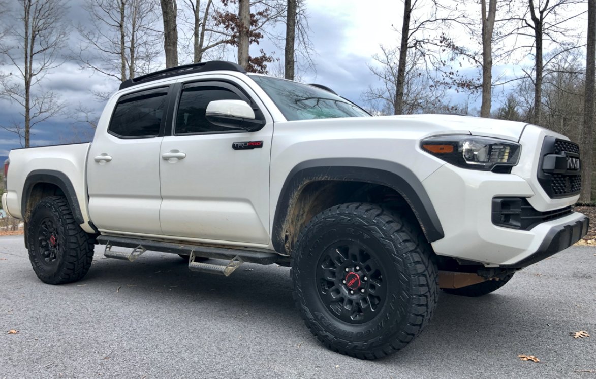

    285/75/16 fit -- no rubbing. Toyo Open Country RT

    The OEM 16” Pro wheel has a 13mm offset (1/2”).
