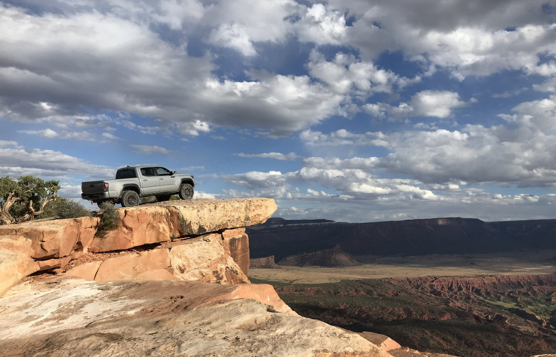

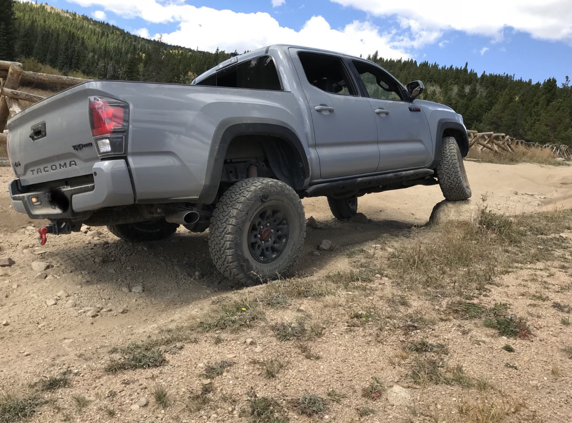

    been getting a few messages lately so i’m assuming there still isn’t much or any info out there on a cost effective way to get a little more height on a PRO without gutting the stock fox shocks so here’s my 2 cents...
    i purchased the revtek 427AP kit earlier this year. this kit is a 1.5 front spacer and AAL to give you 1.5 in the rear. after talking to revtek they said on a PRO this is the highest you can go up front without risking or replacing stock components but still getting the max performance a PRO can get.
    my review:
    i’m was definitely surprised after reading all the haters on here who down play spacers but i’m glad i ignored them because i literally couldn’t tell the difference in ride quality up front after getting the spacers installed. I will say the only difference i feel is on the rear but only when going on speed bumps it’s a bit stiffer than the stock rear. not bad at all though so i wouldn’t worry about it.
    the performance of the truck is GREAT after the kit and the looks are even better! i’ve taking her to moab, hidden falls, denver CO, and just got back from big bend national park last weekend. Nothing has been broken or got missed up or even sounds weird compared to doing some trials when it was stock so if you’re worried about this kit hindering a PROs performance, DONT! because it doesn’t at all.
    all in all this is the best couple of hundred bucks i spent on the taco considering i wanted it a little higher than stock but didn’t want to spend thousands on thousands replacing the suspension with what i’d assume to be equal or better in regards to kings or icon just to get that extra inch and a half i’d probably get with one of those systems.
