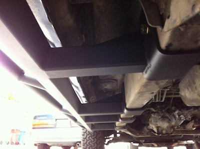

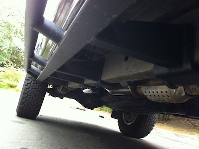

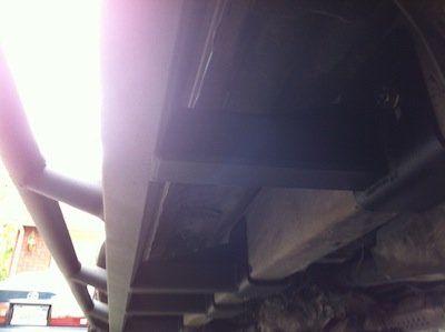

    I was able to get some shots underneath my rig for ya where the sliders grip to the frame. Hope this gives you a better idea of Jerry's design, it all works great!

    Can't really tell from the pics...so are the frame mounting brackets essentially a C-channel around the frame and you bolt all the way through the front of bracket - frame rail - back of bracket? Thus the "just as strong bolted as welded" comment?

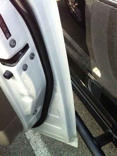

    So this morning I was forced to park my taco extremely close to a new looking Honda CRV. There was no parking anywhere and on my way out I decided to stop and take a sip of coffee from my thermos when out of the blue I hear a big "thunk" near my passenger side door. I was like wtf? :confused: Well this crazy soccer mom looking lady was in a rush to get in her CRV, swung open her driver side door and the door's edge managed to slam into my BAMF sliders instead of my passenger side door. I LOVE my multi-purpose BAMF sliders! woot!
    Here's a shot I took of our sienna's passenger door next to the driver side BAMF slider of my taco. Notice the edge of the Sienna's door hits the slider and never even gets to the taco's side door. So much win!

    That's about right, much better then how I'd be able to explain it. :p Jerry (the guy who designs and builds them), calls it the "U wrap bolt on". You can read more about it HERE :)

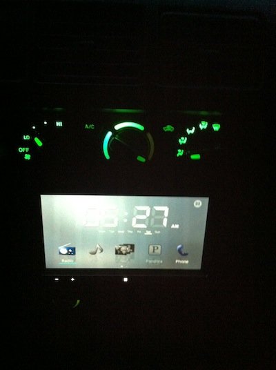

    I will review this awesome head unit very soon, but will have to say, if you have an iPhone, it's best you run appradio extensions (via JB) to get full functionality out of this head unit.

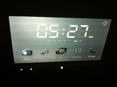

    The Pioneer AppRadio 2 has a beautiful simple design but quirky functionality without a hacked iPhone. In regards to functionality, the main reason for this unit (besides that I purchased it for dirt cheap :p ) is for my planned backup camera install. I also love the huge clock display, much better than the location of our stock taco clock lol :p
    Here's a sneak peak of my Pioneer SPH-DA100 AppRadio 2 installed:

    Blue LED dash lights
    :drool::drool:
    LOVE those green lights. Very nice!

    Thanks man! Was going for the black ops theme, pleasant on the eyes.

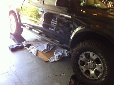

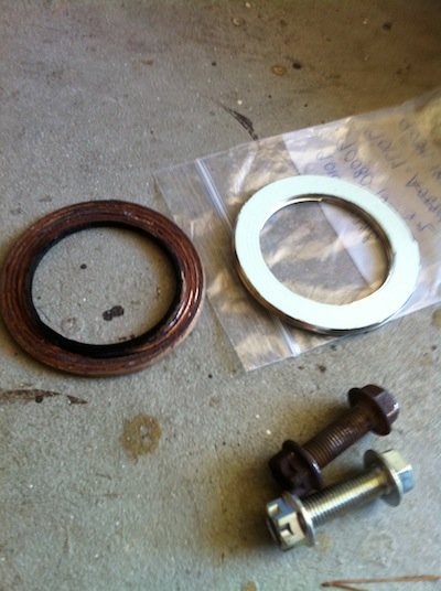

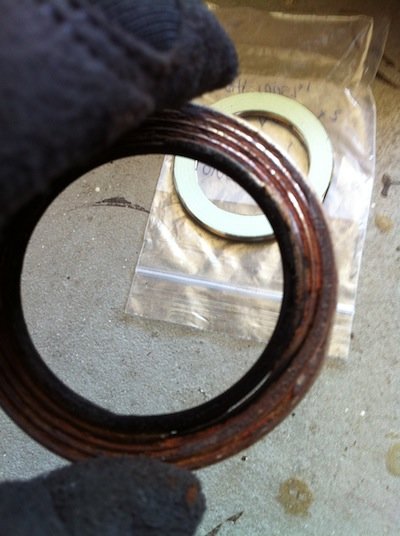

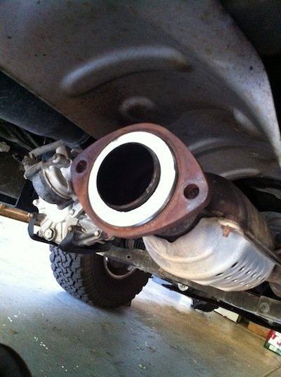

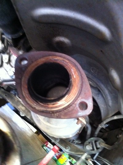

    While replacing the stock exhaust with a aftermarket cat-back I swapped in a new gasket and replaced the rusted nuts and bolts. I provided the part #'s below for reference.
    Using rhino ramps to make crawling under an easier task:
    Old worn out gasket:
    Old parts next to the new parts:
    Close up of the old gasket:
    New one about to be installed:
    90917-06057 GASKET, EXHAUST PIPE
    90080-10064 BOLT, FLANGE X2
    94185-61000 NUT,LOCK X2
