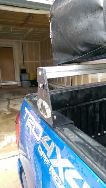

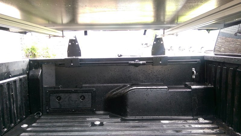

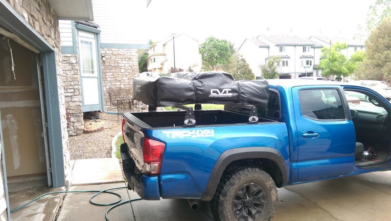

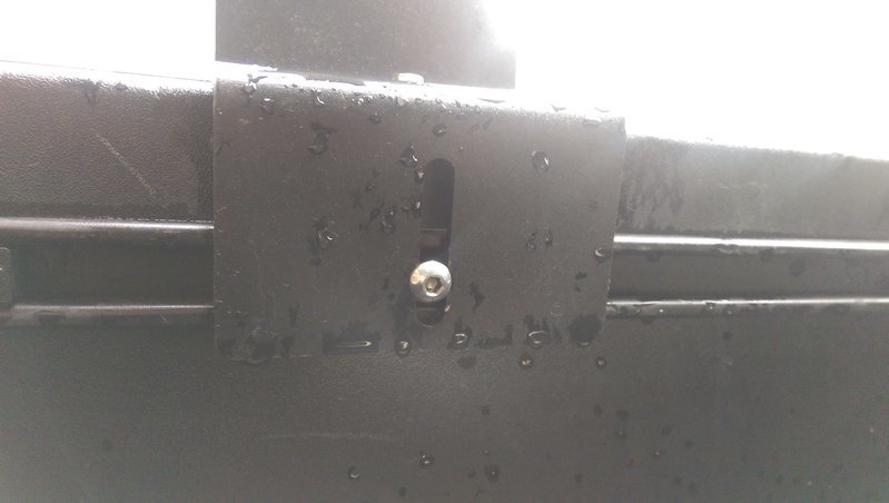

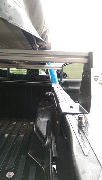

    I don't have that tonneau anymore because I didn't like the canister.
    I think they would work with that cover because the PE is very similar.

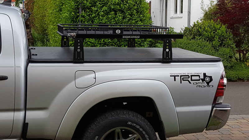

    I went with the KBvoodoo hi rise system (also his bedcaps and tail gate cap)...I have two Yakima steelhead on currently with cargo basket...there is room for more with basket removed...or ski racks when hitting the Alps!

    Do you find that set up affects the water seal of your cover?

    Some...however I corrected by removing the seal on the cover rails where the bracket mounts to the bed, which allows the rail to sit flush...the KBVOODOO bed caps reduced the gap at the front and back of the bed. Secondly I ran a bead of silicone caulk around the 3 edges of the frame that are permanently fixed to the bed. The cover was not water proof before either.

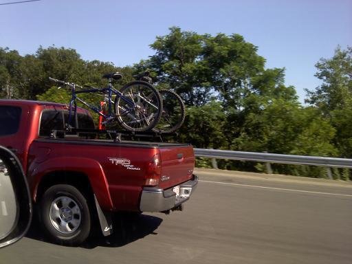

    I saw this a long time ago on the hwy. I think he just mounted the cross bar stands on the factory plastic bed caps

    Regarding potential fit with the TruckCoversUSA tonneau, I see that there is a fastening bolt on each of your towers. How would a tonneau rack top rail fit over that?

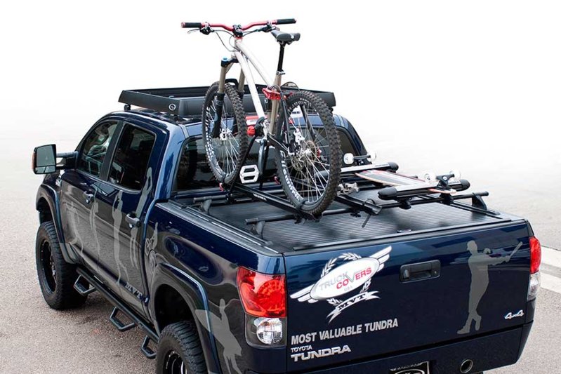

    Here's the Yakima top rails that I have:

    @Rhubarb: Great pics. I love the look of the integrated rack. Feel like it just looks cleaner than some of the other options.

    Yeah, I like it too. That image comes from TruckCoversUSA, but Toynado has a build just like it. My only concern is, even if I used three or four of those Yakima load bars, whether it would hold the moving weight of a RoofTop Tent. I would go that route if I could wrap my mind around whether it would be safe.
