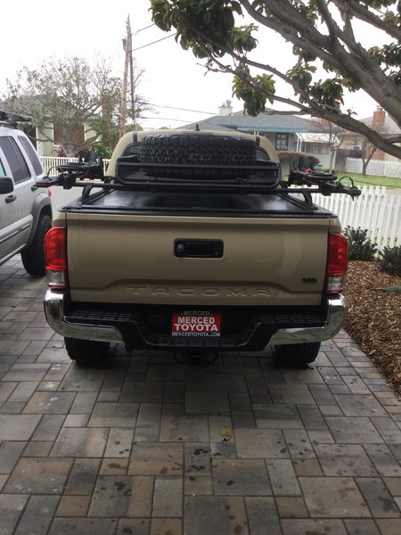

    I have a few quick questions on your configuration:
    1. How well does your roll top cover keep water out of the bed area?
    2. When you remove the Yakima crossbars temporarily, are you just removing the bars and towers intact, thus leaving the landing pads in the rails?
    3. What length bars are those? They appear to be the 86" XXL round bars.
    4. How far apart are the landing pads? Looks like about 30"
    Thanks! Excellent setup. I will likely go that route.

    1) there were two spots I had to put a bit of silicone but after that it has been great.
    2) yes, makes it easy
    3) no they were the XL that I cut to slightly under the width of the truck
    4) dang you must be an engineer cuz they were 30" apart center to center
    It's a great setup and the canister is smaller than other manufacturer's covers you don't loose as much room.

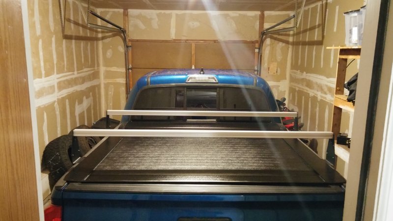

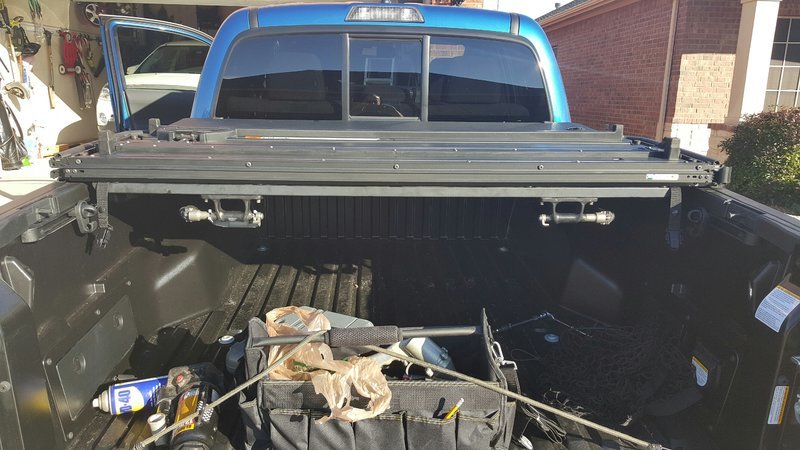

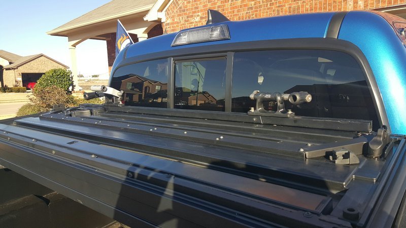

    If you will be getting the factory tonneau cover, here is what I did and it worked out really well. I can transport the bikes and leave the cover on.

    :D Keen observer. Thanks for confirmation. Love the truck. I am likely to do something VERY similar.

    If I wasn't running the basket I could have gone with shorter bars.
    Nice thing with the longer bars is I can put the tire under the cover and add a couple more bike mounts and carry four bikes easy.
