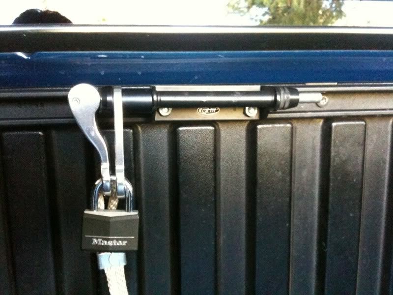

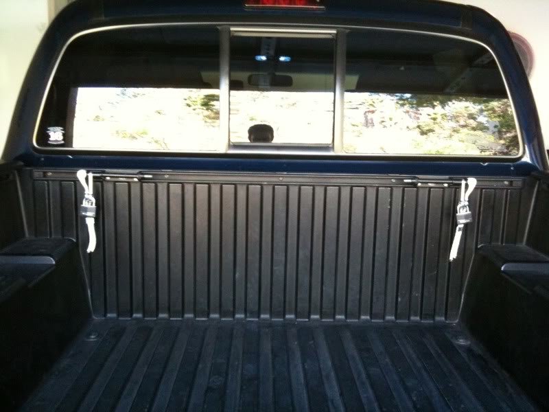

    I use XPORT ones I bought from Performance Bike. They run them on sale off and on for 9.99; 19.99 regular price. I used a one inch piece of aluminum with a hole drilled in the back. Then an one inch quarter in round head screw with a lock washer to secure the mount to the rail system. I used another nut and lock washer but you can use a wingnut.
    I modified my mounts to work with my new mountain bike with a 15 mm axle. I'll post pictures in another post.
