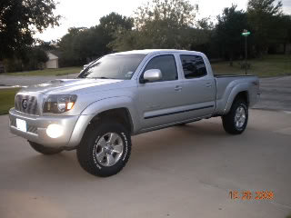

    5100 at 1.75, Rear TSB spring. I think it's pretty level but I have fiberglass bed cover.
    I can't compare the ride to the Bilstein TRD shocks since I only had them for a week and then changed to 5100. Comparing to the black/non-trd shocks (before TSB), the ride is stiffer but I think it's way better. The pre-load lessened front dive.
