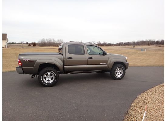

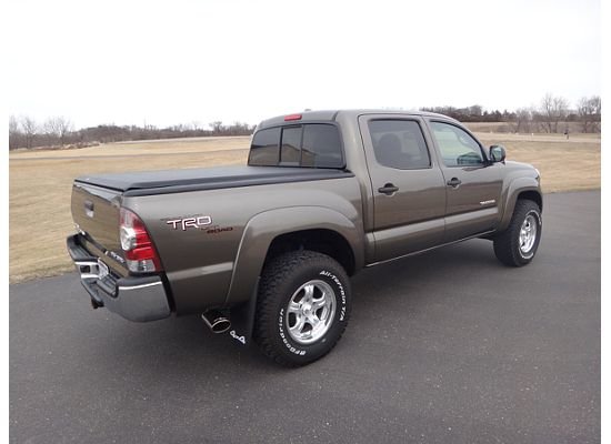

    Also waiting to see picks, had the TSB done and have the 5100's in the garage trying to decide .85 or 1.75.
    My truck didn't go up as much as I thought with the TSB in rear so now I am stuck deciding. I don't want to be nose high when hauling just 400-500 pounds.

    Just looking at those pix I would say hit the 1.75 without a doubt... I was sooo on the fence but after seeing the difference in person I am glad I didn't set them at .85

    UPDATE
    Well after a few weeks of driving around and such the truck still sits at 37" front and 37.25" rear.
    I ended up get some salt for my water conditioner last night and with 400lbs in the bed I got my dreaded nose up...
    Needless to say I think there will be a 1" block installed sometime today. :cool:
