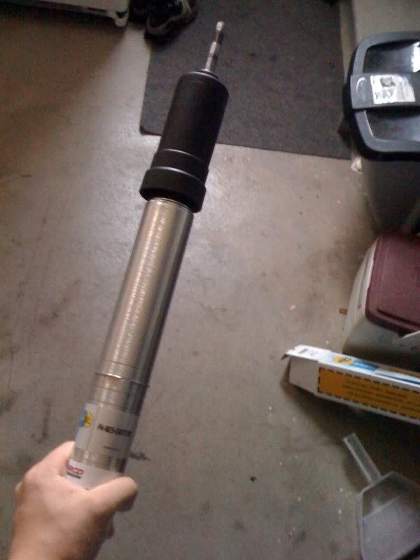

    Yup should look like this.

    just went to put on the rear 5100's... I must compress them almost all the way to get them on... the truck is stock height...
    once on they have about 2.25" of travel remaining... there is about 3" between the axel bumper and the frame... this seems like trouble...
    what is the deal...

    Why did you compress them? Did you lower the rear differential? Did you put the jackstands under the axle or frame? They should not need to be compressed to fit.

    With the truck on the ground, the rear shocks have to be compressed a bit to get them mounted.

    hmmm, i was able to get mine in with the truck on stands without compression. Just lowered the differential and axles.

    Its not hard to compress them....No need to jack up the truck either.

    did not need to jack the truck up...
    just climbed under adn took off the current shock.
    attached the upper eylet and the lower extends many inches past eh lower eyelet... compressed it to get it on and all I have left in travel is about the 2.24"
    Here is what I received:
    I have:
    BE5-D559-TO and D560
    D559 is for L rear so I went to put it on drivers side rear...
    D560 is for R rear... did not get that far...
    I compared the two and the D560 actually seems a little longer...
    [​IMG] [​IMG]
    [​IMG] [​IMG]
