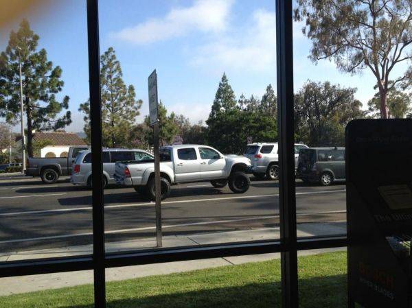

    I'm running the standard travel blisteins with a aal in the back. I have the mantra spindles up front to...some to above 5" in the front...it Will be softer and less bro lean

    When you say bro lean you mean the front is higher than the back right? And btw the link you sent is the same pic as on the ebay link i posted....wonder if its the same peeps or they just stole the pic hehe

    So you have approx. 5" up front and only 1.5" in the rear?

    So your front is wayyyy higher than the back??

    its not too bad...lol you should have seen it when it was at 7" up front
