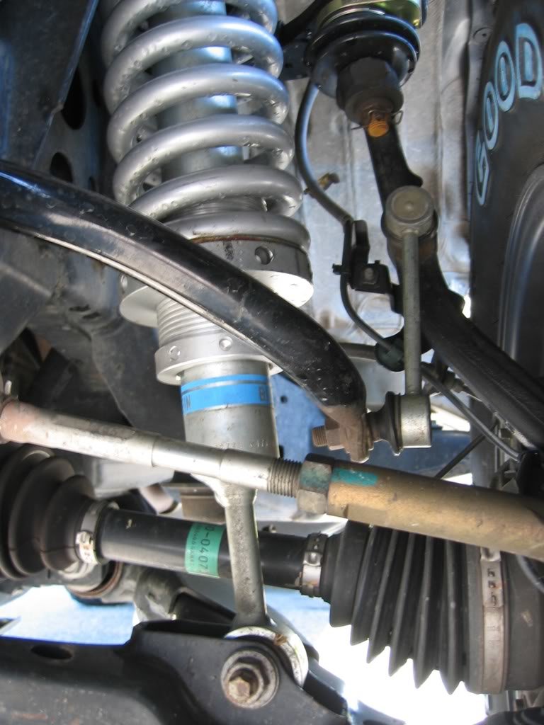

    I had mine at that setting prior to the coilovers. It'll be 2.5" in the front.
    Before with TSB:
    After:

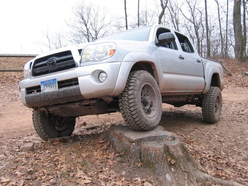

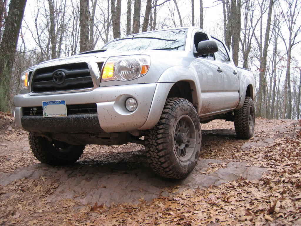

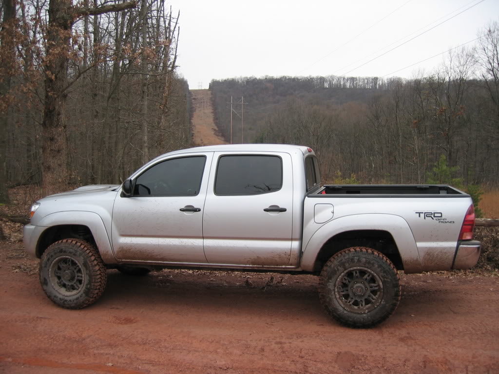

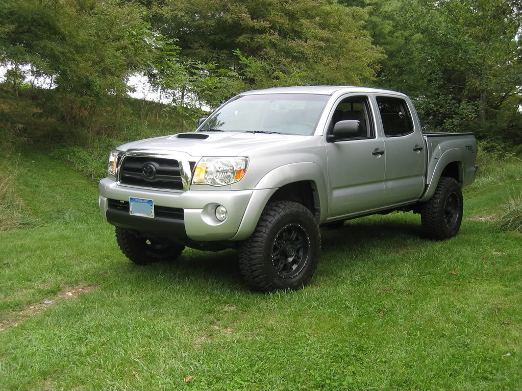

    Yes, yes and more yes. I am rolling on the 2.5" (maybe a tad more depending on how it sits) with the adjustable coil over conversion kit from ToyTec and I love it! The longer coils really make the ride very comfortable and as the others have mentioned don't forget the UCAs.
    Sorry for being a picture whore
