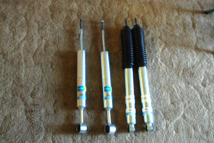

    I seen santa today, He looked alot like a she, and was driving a truck, a truck that looked alot like the UPS truck. Oh well who am I to judge, she left some goodies for me.
    Oh what is it? could it be my Billy 5100. But of course it was.
    Ok. now that I got them I need some pointers.
    1. do you guys run the rubber boots on them, I don't like them to much.
    2. I want to pick the front level should I go to the 3rd notch or the 4th. I think I like the 4th. But I could be blinded by love!
    3. what is the easiest way to install them, not scared of work, and I have plenty of oakie-ingenuity.
    4. anything I have over looked.

    Lave the rubber boots on. They protect the shock shaft from rocks and crap. If your gonna level, I think you want the 1.75" setting (3rd.). :)

    leave the boots on them, that way dust and crap dont end up hindering their performance, and you'll barely see the boots anyway. go with the 3rd notch.......set on the 4th, gonna be super stiff. rears are easy.....fronts, gotta remove the entire strut assy, use a pair of spring compressors, and swap the shocks like that. it may be easier for you to take the strut assy's somewhere to get them to swap them, but you can diy. after you are done.......go get an alignment. then you should be set.

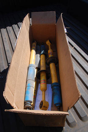

    I got them on. Well I had them put on, I wimped out. I couldn't get the spring collapsed. But any way there on:
    Before and after.
    and these are the crap that are suppose to be TRD Offroad:
    I think it looks great. Gotta save some coin to buy some sliders and tires. Or maybe a bumper and winch. So many mods and too little money. I need a sponsor any takers?
