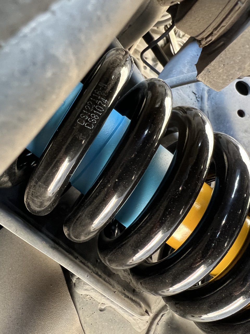

    I did however finally find out that the springs installed are in-fact incorrect. The number on them when looked up appears to be for a new 05 and up Tacoma. I had to do a lot of digging with 3 part numbers to confirm they aren’t correct.
    next problem is Moog stated they no longer make them for my truck anymore in the correct part number.
    Online place I ordered from stated they did however find the correct springs in a separate warehouse despite no longer being made from Moog
    Correct spring is #81082 NOT #81074 and is printed on the spring. “Incase anyone does what I do and runs into this”

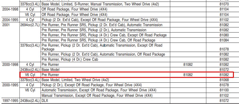

    Here is a picture of the spring #’s they sent me when we were figuring out the actual correct spring
    This must be from Moogs “old catalog” for springs because the correct spring is no longer made but maybe can still be found out there

    Mequon, WI
    2002 Tacoma PreRunner 2WD
    I've got a 2002 Crew cab Prerunner 3.4L with 170k miles, so I think the 81082 is the correct one for mine.

    99 Toyota Tacoma TRD
    I’m not sure I can’t see yours in that list for years? Did you?
    I don't see it specifically in that pic but I can't imagine there is a significant difference from the exact same 2001 PreRunner Crew Cab 2wd 3.4L model which calls for the 81082.
    It seems that the big difference is with 4x4 and/or Off Road Package. I started a chat with them over the weekend and their response this morning was a kit that uses the 81104 spring, and I don't think that's right for mine. As far as I can tell, I don't have the Off Road package or the extra weight of 4wd apparatus up front. Anyone know how to tell? Is it in the VIN code or something? I have no stickers on the truck like I see with a lot of the TRD models.
    Now I can't find the 81082 spring in any of the combos. For 2WD V6 the only option is 81078 spring. Could have sworn I saw it earlier today on a 3-6 week backorder. I guess I am going to have to call them.
    The wrong spring they sent ME was originally 81074, which Moog confirmed that that was for the new gen Tacoma 05 and up
    As you can see on attatched picture
    This was the wrong spring for my first gen
