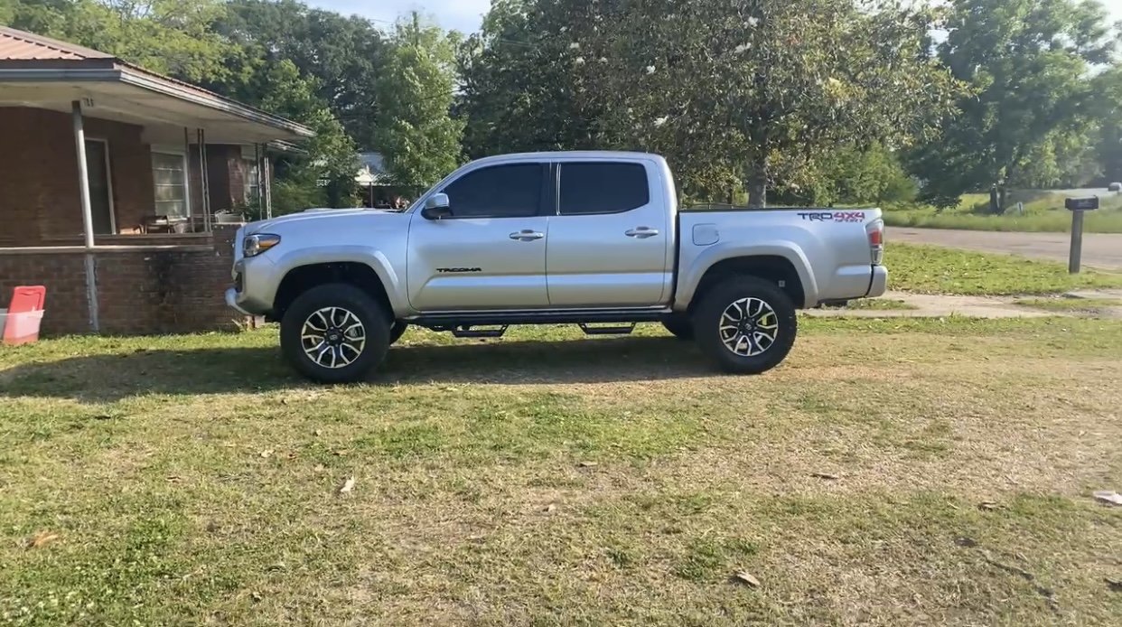

    Hey guys, I recently installed a 2” front, 1” rear block and spacer lift and I like the way it looks but the ride is horrible. I’m thinking about getting Bilstein 5100’s on all 4 corners with stock springs, setting the struts to 1.5” and keeping the 1” rear block. If I do this will it ride as good as stock? If not I’ll probably return to stock suspension,TIA.

    Personally I like the feel of a digressively valved shock but it’s not for everyone.

    Your ride will be "firmer" than stock, but absolutely more balanced and controlled. A worthy upgrade path if you're trying to have a lift as well as some ride comfort.
