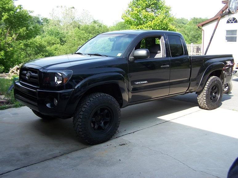

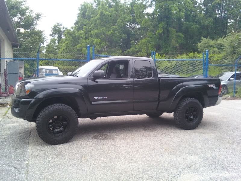

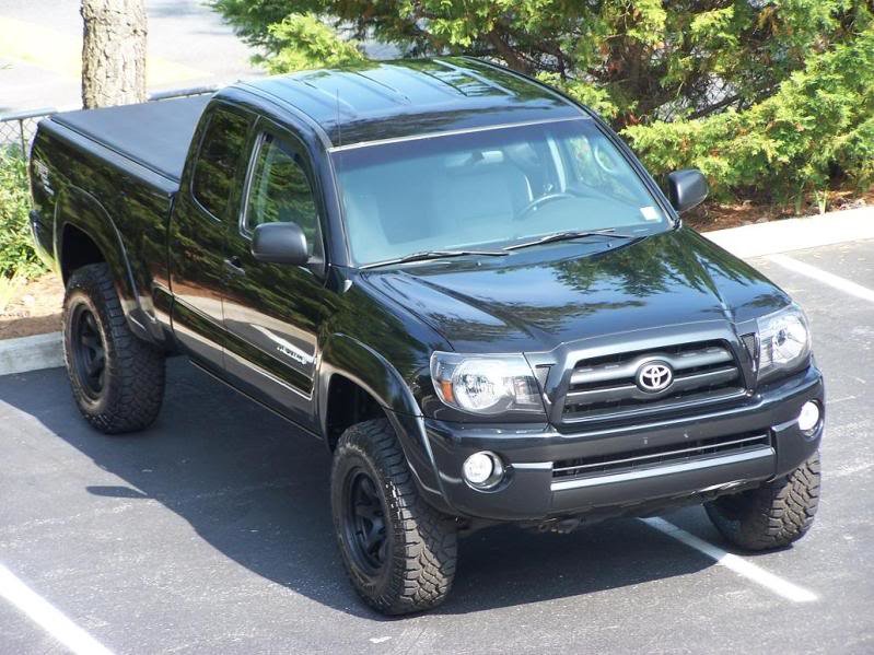

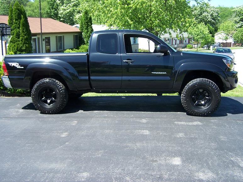

    I also have the Billys in the rear, to give you a better idea. Although they're longer than stock, I'm just about positive the ride height was unchanged since it's a leaf setup. I didn't bother to measure before and after height.
    That AAL is a cheap and simple install, if you haven't searched on it yet. I'm told to go with Toytec, and I think it's around $75 and a couple hours.

    great pics, I will have this setup next week hopefully!

    Hey man what tire size are you running with this? And this is just 5100s at 1.75 in the front?

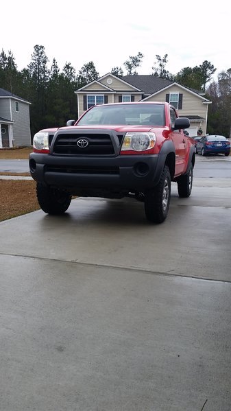

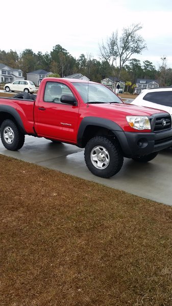

    5100s @ 1.75, TSB springs
    235/85R16 (cause cheap)
    23.25" center of hub to fender in the front
    23" center of hub to fender in the rear
    (Driveway has a slope to it)
