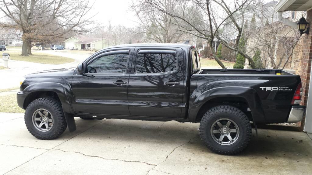

    Lift, tires, mats, blah, blah, blah...
    Stock Bilsteins
    Picture after lift, tires and UCA's. 5100's all around. LR UCA's. Front set at .85 w/Eibach 620 springs and 1/4" spacer on drivers side for the lean. The springs provide 1.6" of lift and the AAL in the rear provides about 1.5" after settling. Overall, I gained 2.5" in the front and 1.5" in the rear. Since the front was an inch lower, it sits level.

    Love that look! I may have to just get the springs and AAL as well. What size tires are you running? Didn't need new UCAs either?

    I've got 265/75R16 Duratrac tires. I had some lane wandering at freeway speeds after the lift, so I installed LR UCA's the following week. Drives like stock.

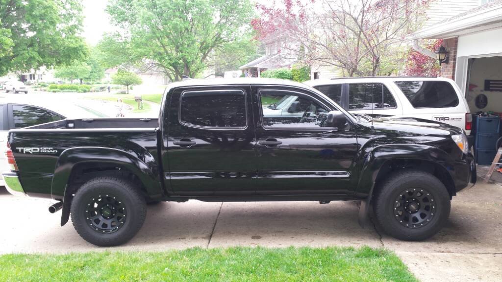

    Josh
    San Antonio
    2010 Black TRD Off road DCSB
    Stock suspension
    5100s in four corners
    Front set to .85
    On 265/70/16 bfg rugged trails with SCS bronze wheels

    Looks great! Was worried you wouldn't notice much lift but I can definitely tell.
